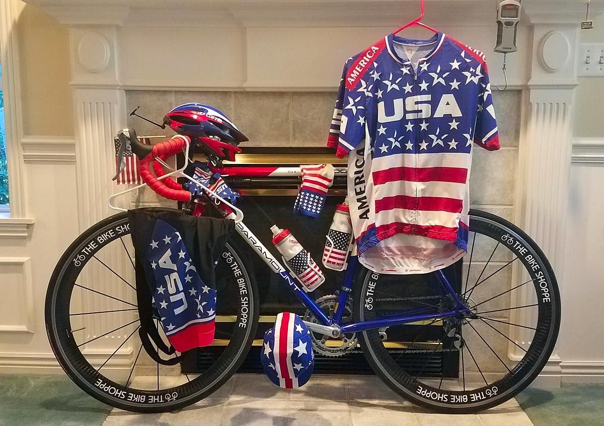

Still running an 8 speed setup and despite it being one of my heavier bikes with a 42T small ring it is one of my best climbers. Puts power to the road really well.
How I took it out this July 4th.

Nothing like a comparison.......
Best, Ben
Best, Ben
