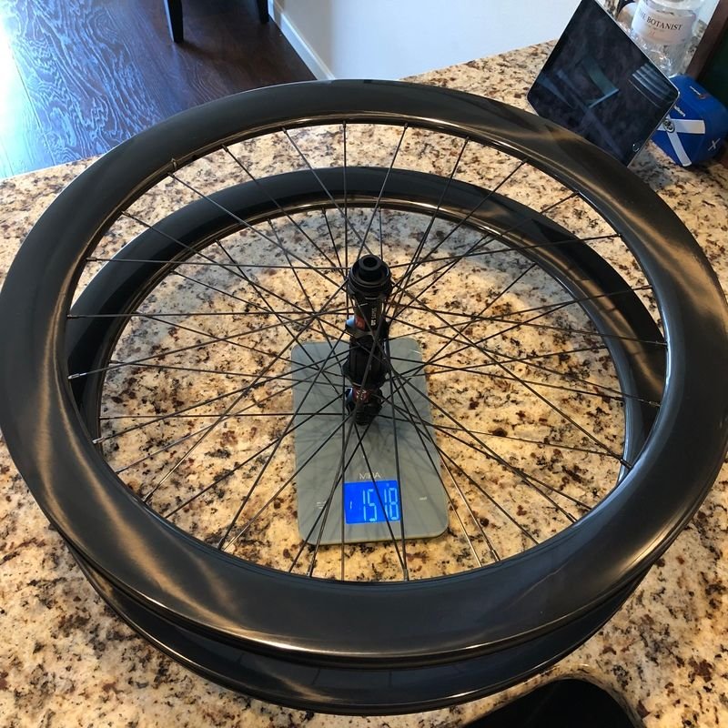

Just picked up yesterday 8/17, ordered 7/17 from the global warehouse to Seattle, WA. Shipped using EMS - air to San Francisco and USPS to the PNW.
AR56 disc (glossy, UD, no logo, no holes), DT 240s EXP hubs, CX-RAY spokes, brass nipples. Spec'd at 1493g +/- 25g, weighed in 1518g (or exactly 1493 + 25, 😂 ).
This is my first set of deep carbon wheels. Looking forward to getting them kitted out and going for a ride!

Thanks! Islay is a favorite vacation spot. The Botanist is a great gin that I prefer to London dry variants. It definitely gets overshadowed by the local Scotch. Although I am also partial to the whisky...
Yea, was a toss up on whether 24 dime size pieces of carbon or rim tape would weigh more. And obviously serviceability is a bit more difficult. My compromise was to go for the easier tubeless setup, and take the minimal weight delta of brass nipples to hopefully minimize future maintenance needs.
