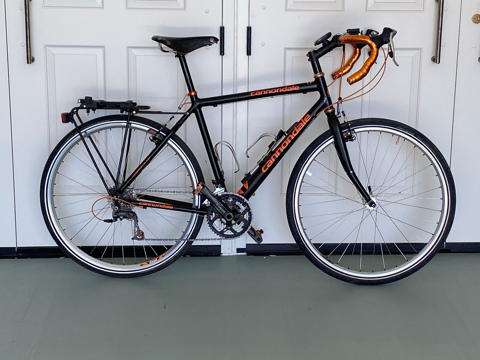

Yup. The bikes below have mountain cranks. The white bike has had a couple of different mountain cranks on it. The first picture is of the bike using an XT 44/32/20 external bottom bracket crankset. The second picture is of the same bike with a mountain crank on it that uses a regular cartridge bearing bottom bracket. The last picture is of another bike with a Shimano external bottom bracket.
The main problem with using mountain bike cranks is that the chain line is a bit wide with a mountain crank. A road front derailer may not be able to reach out to the highest gear so the crank needs to be moved inboard roughly 2.5mm. For a internal BB, that means using a shorter spindle. For an external BB, that means moving spacers from the drive side to the nondrive side.
The other issue you might run across, especially with the smaller diameter 40 tooth gear, is that the bottom of the derailer may hit the chainstay. You can see that I have a lot of room between the bottom of the front derailer and the chainstay in the first picture. But I can say the same for a smaller chainring.
Finally, some may say that a road derailer can’t be used because the curve is wrong. I have no problems using just a regular road front derailer with any crank I’ve used. Indexed front shifting on both of these bikes is nice and crisp.
Edit: Opps, didn’t see that you wanted higher gears. Smaller rings give lower gears. I’m not sure you really mean that you want higher gearing.

I have two Shimano 2 piece (aka external bearing) cranks on the bikes in the picture above. It’s unorthodox but I have moved all of the spacers on the drive side to the nondrive side to give the road derailers I use the range they need. Internal bearing bottom brackets are more orthodox but they are a little more involved in installation.
This would probably work, but even if you left 1 spacer on the DS you would be at a “theoretical” 47.5mm. Sora r3030 triple is 45mm. That would seem close enough to me.

I have checked how far out the front derailer swings…several times. 2.5mm may not seem like much but road derailers just don’t have a long enough swing to reach that far. Swapping the spacers over to the nondrive side hasn’t had a downside in several thousand miles of riding. Of course I use the mountain bike cups because they are longer.

26 tooth inner ring? Shouldn’t be a problem. The bikes in the pictures have a 22 tooth inner on the black bike and both cranks on the white bike have 20 (!!!!) tooth inners. Zero issues with shifting. The black Cannondale has a Microshift front and the white Cannondale has an IRD Alpina front with the Race Face crank and an inexpensive Shimano front (Sora or Claris, can’t remember which) with the XT crank. I went to the Shimano front because the IRD flexed too much with the braze-on clamp.
I have a tandem with a 52/39/24 road crank that works just fine with a “modern” (2010) front derailer.
