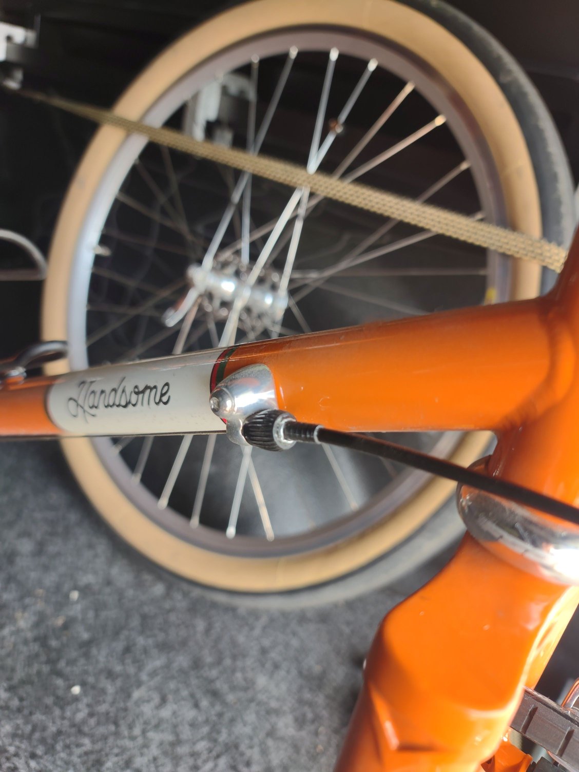

I have an 1x11 drivetrain and for the most part it shifts smooth and quickly but sometimes when I am climbing and shift to a lower it will shift to the lower gear but immediately shift back to the higher gear. It sometimes does it when not shifting but just putting power under load like starting to climb without actually shifting down my bike will shift to a higher gear on its own. Does not do it all the time but enough it is bothersome. I have microshift bar end shifters deore rear derailleur. does not matter if clutch is off or on altho I have had it on most of the time. Again shifts find under normal riding. Is this something that is addressed via the barrel adjuster or at the derailleur itself? thanks. photo of what I have.

Turn the barrel adjuster (either on the downtube cable stop or on the rear derailleur) about 1/2 turn counterclockwise. That should fix it.

The person you responded to said to turn the barrel adjuster either on the downtube or at the rear derailleur. Not sure why you ignored half of that post.
The barrel adjuster on the downtube is shown prominently in your first picture. As said earlier, a half-turn (counter-clockwise) should fix the problem.
