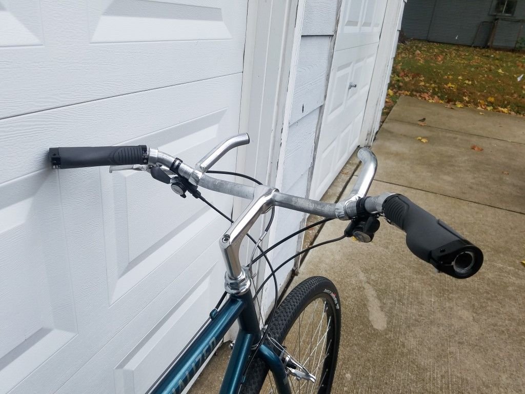

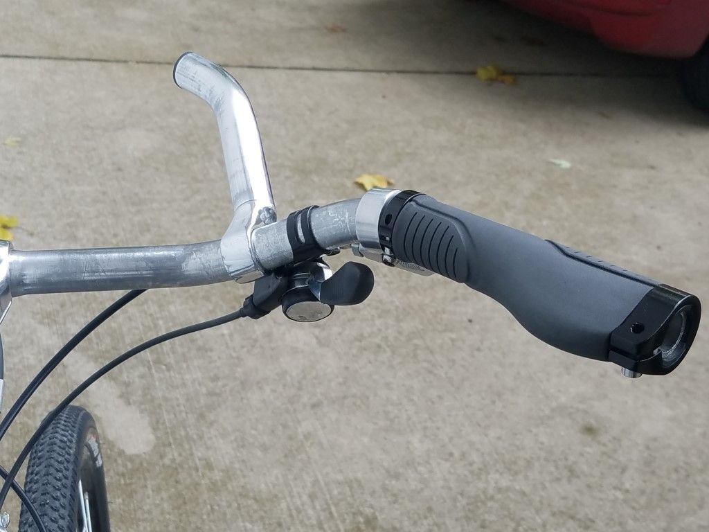

I searched a good long while on BF and couldn't find a thread devoted to modified, weird or "inverted" shifters and/or brakes. If you're like me, you think it's so cool when someone uses their ingenuity to solve a problem...without having to resort to buying all new parts (although that doesn't sound too bad).
So, if you've found that "sweet spot" with your bike's shifters or brakes (but it's not how the manufacturer intended), show them off here.
Here's mine...underbar mounted thumb shifters, a la Rivendell. Mine are Deore DX thumbies swapped left to right and mounted below the handlebar. The right side shifter still controls the rear and the left side controls the front. Of course, this only works in friction mode, which is fine by me. I did this so I could free up the top of my handlebar for resting my arms down (when grabbing the bar ends). Seems to work OK for now.

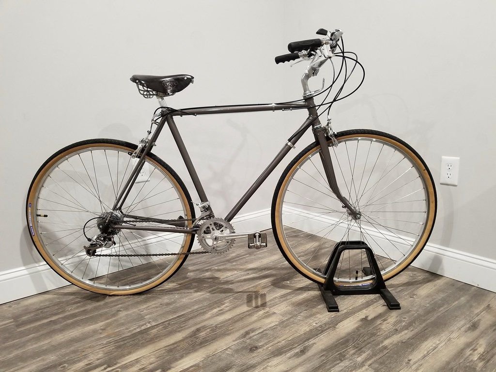

I also used the "Rivendell mount" for some Suntour thumbies:

Does the Riv mount interfere with grip space when the shifter is pointed straight to the grip? My Paul thumbies have to be be spaced back when top mounted so the shifter doesn’t stab me when it’s pointed out. I’m curious if the bottom mount helps at all with this?

For me, since mine is a city bike, I shift the rear often enough that I like having my fingers hover over the shifter. So, even though the shifter is in the field of contact, I don't perceive it as obstructive. Even on the left/front, which does not move as often, the shifter only juts as far as my index finger and thumb in the "straight out" position, so I can let my fingers hover comfortably as well. It is a different feel from push/pull trigger shifters, which stay where your finger/thumb rest and provide a comfortable platform, but I am getting to really enjoy friction now that I have learned how to tune shifting and am using high quality friction derailleurs and shifters.

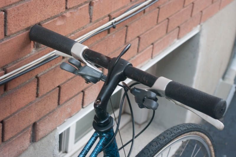

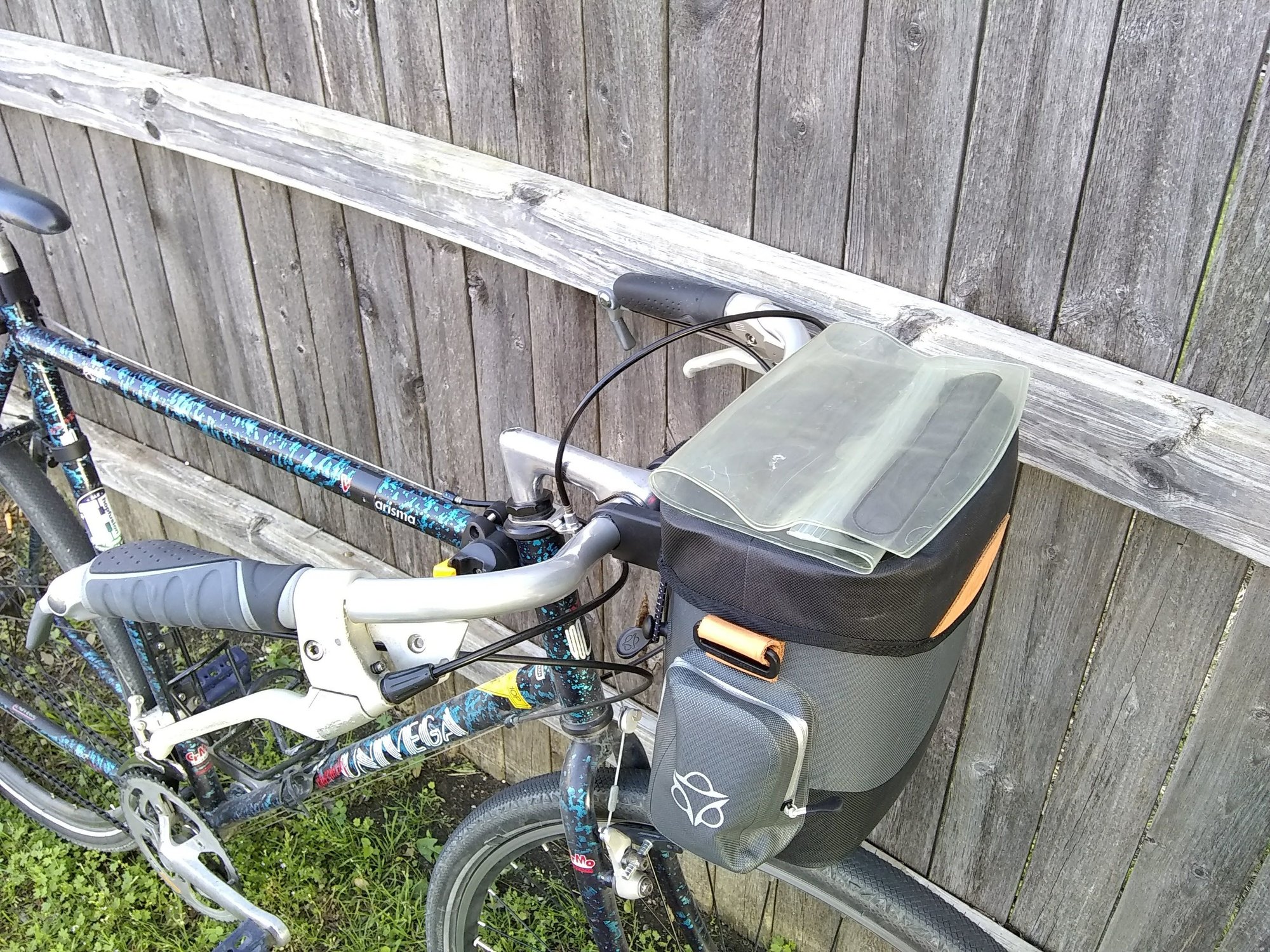

Here's my early 1990s Univega Via Carisma that's in a continuous state of flummox. I keep modifying and tweaking it every few months.
It began with a cockpit like this mixte version (not my photo), same flat bar and modular shifters that mounted to a metal plate on the brakes, rather than directly to the handlebar. The bike's component group was Shimano Exage (most of which later morphed into Deore -- the earlier Exage 500 CX long cage rear derailleur and later Deore LX are nearly identical, including model numbers).
But I'm not sure about the brake/shifter group -- it's Shimano but there's no model designation. Both sides indexed, thumb operated only. Unfortunately both shifters failed the same way about a year apart -- wear to pins and holes prevented reliable shifting. Disassembly, cleaning and relubing didn't help.
I used cheap SunRace SLM-10 friction thumb shifters for about a year, then switched to Shimano bar-end shifters -- friction for the front derailleur, index or friction for the rear. With the original 7-speed rear derailleur it'll cover an 8-speed 11-32 cassette in friction mode only, but won't hold the last click securely in indexed mode. With a 30T small chainring and 28T cog I rarely need the 32T cog anyway, even with the bike loaded with groceries.
I kept the brakes but the metal mounting plate for the original shifter no longer serves any purpose. I considered mounting lights to the plates but would need an adjustable mount like a ballhead to make it work. Eventually I'll replace the brakes with more streamlined levers.
Original setup, with indexed thumb shifters mounted to a plate attached to the brakes. That flat bar would be considered too narrow nowadays.
First variation back in 2016-2017, riser bar, same brake/shifter combo. The left shifter failed after a few months and was replaced by a friction shifter. Later I used the SunRace SLM-100 friction thumbies on both sides.
More or less the current setup since 2018. Nitto Albatross bar, original brakes, now with Shimano bar-end shifters. Very good setup for this bike, with long top tube and stretched out riding position with the original bars.

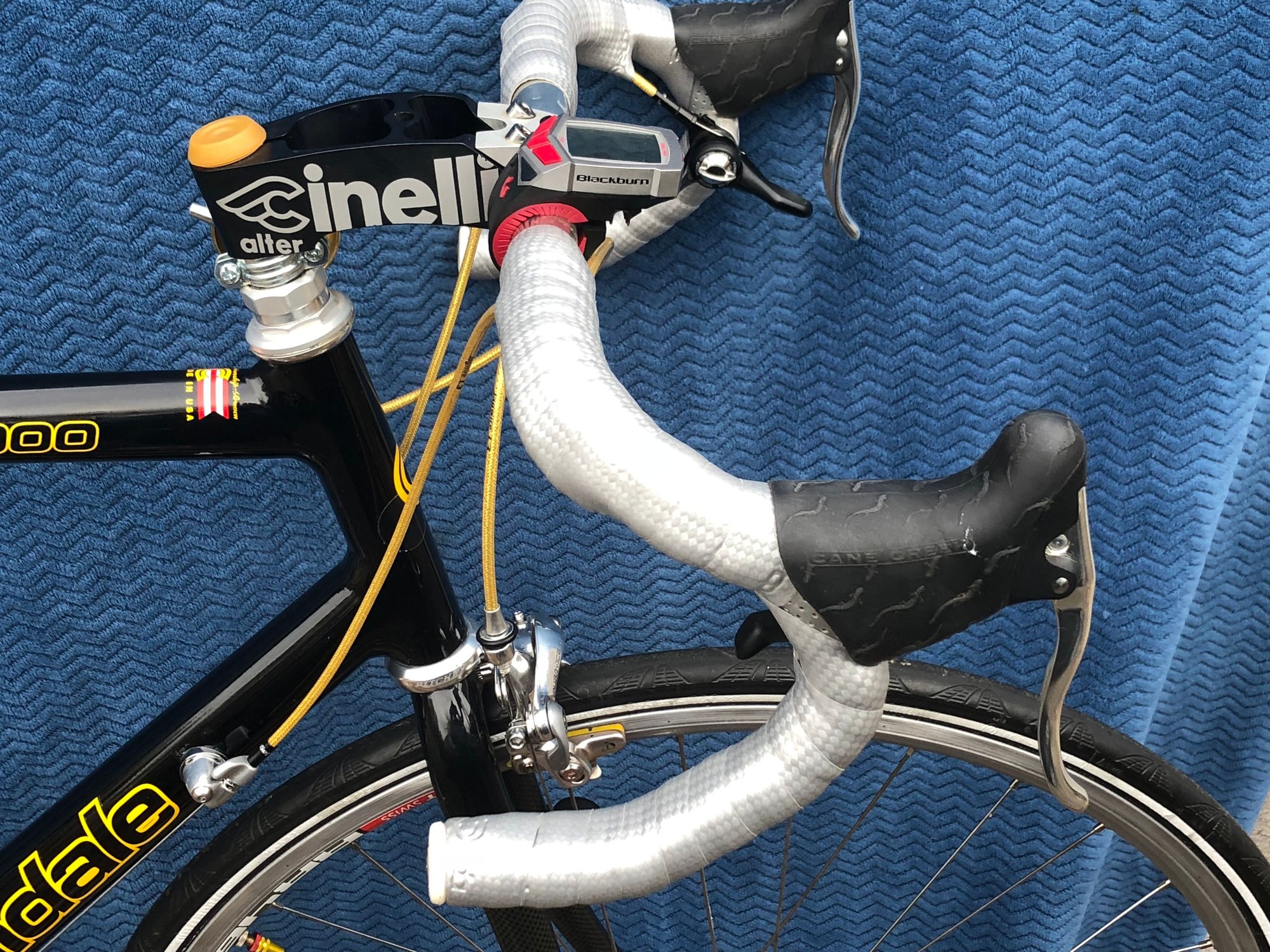

Not too oddball (to me) but you don’t see this arrangement all that often on a road bike:
This is the Accushift Command 7/8 speed shifter mated to an 8 speed cassette (all SunTour BTW) - shifts great. Also I mounted mine below, not above the brake lever for a racier look/feel and they are fine.
The housing was re-done by me, then had to be re-done again since it was about 1.5” too short, arghh!
I do like the Cane Creek aero levers and how positively they brake with the re-built 7403 dual pivots.

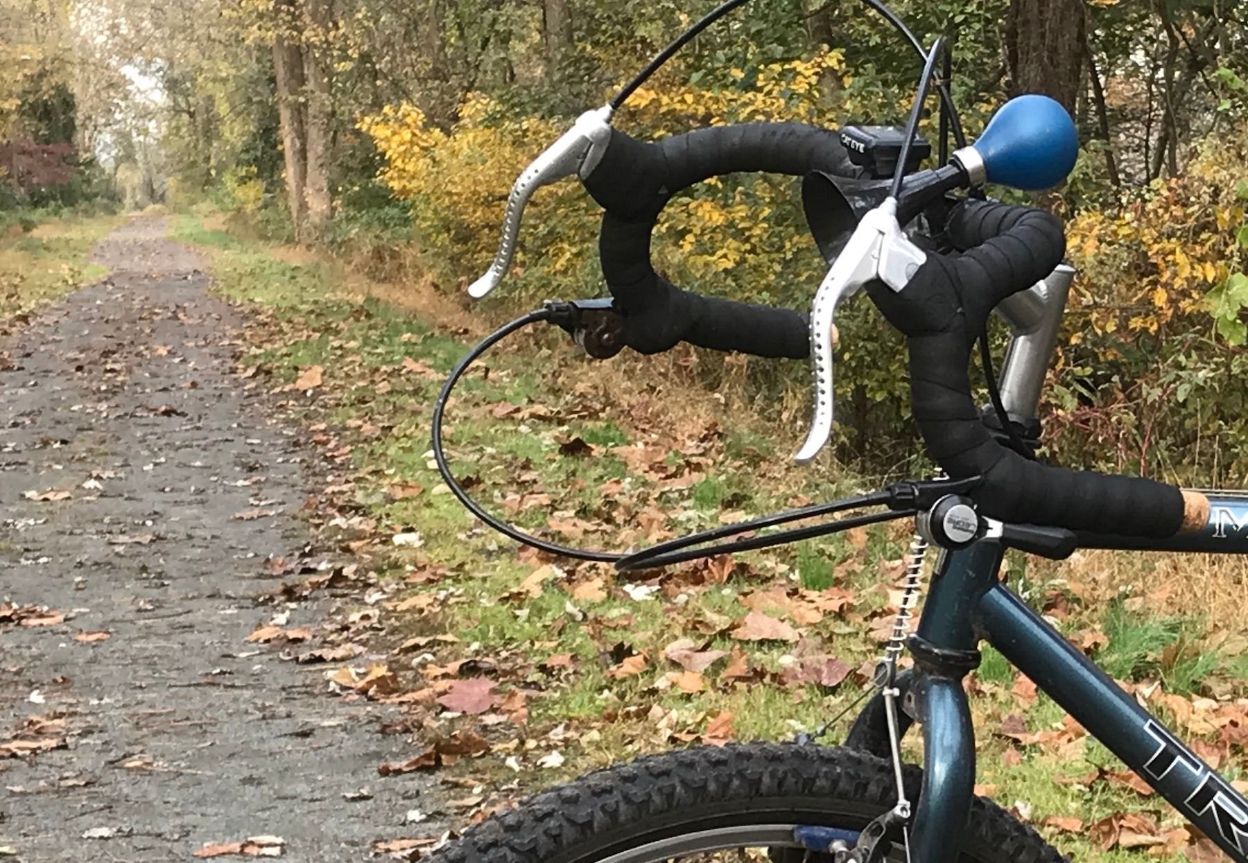

I finally remembered to post my oddball shifter config. When I did the drop bar conversion on my Trek 850 I decided to mount the thumbies on the drops - sort of a compromise between DT shifters and bar ends. I do have to reach a bit for them but I'm still right on the bars. I've ridden this bike a lot over the past couple of years and this position really works for me. I've not seen another like this.
These are 3x7 Deore indexed. Someone had pitched them into the garbage so I snagged em and restored. They work just fine, real well actually.
Lovely to be out in the Pennsylvania woods these days, hmmm? Oh, like my kids bike "clown horn"? It sure does get folks attention. I honked a women yesterday who jerked her head up and scanned the sky. I assume she thought it was a hawk or something. Dogs love this horn.

Thanks for sharing this. I wasn't sure how this particular shifter would work as undermount. I am considering switching to the old power ratchets.

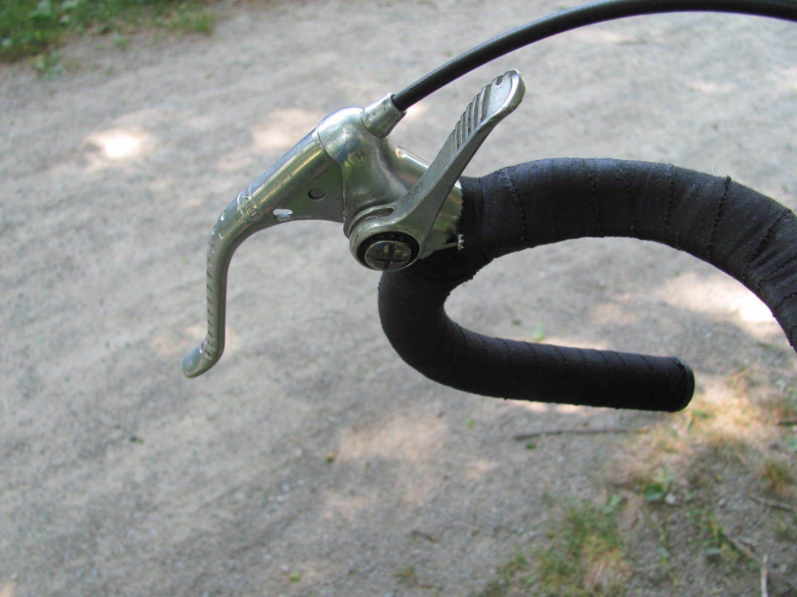

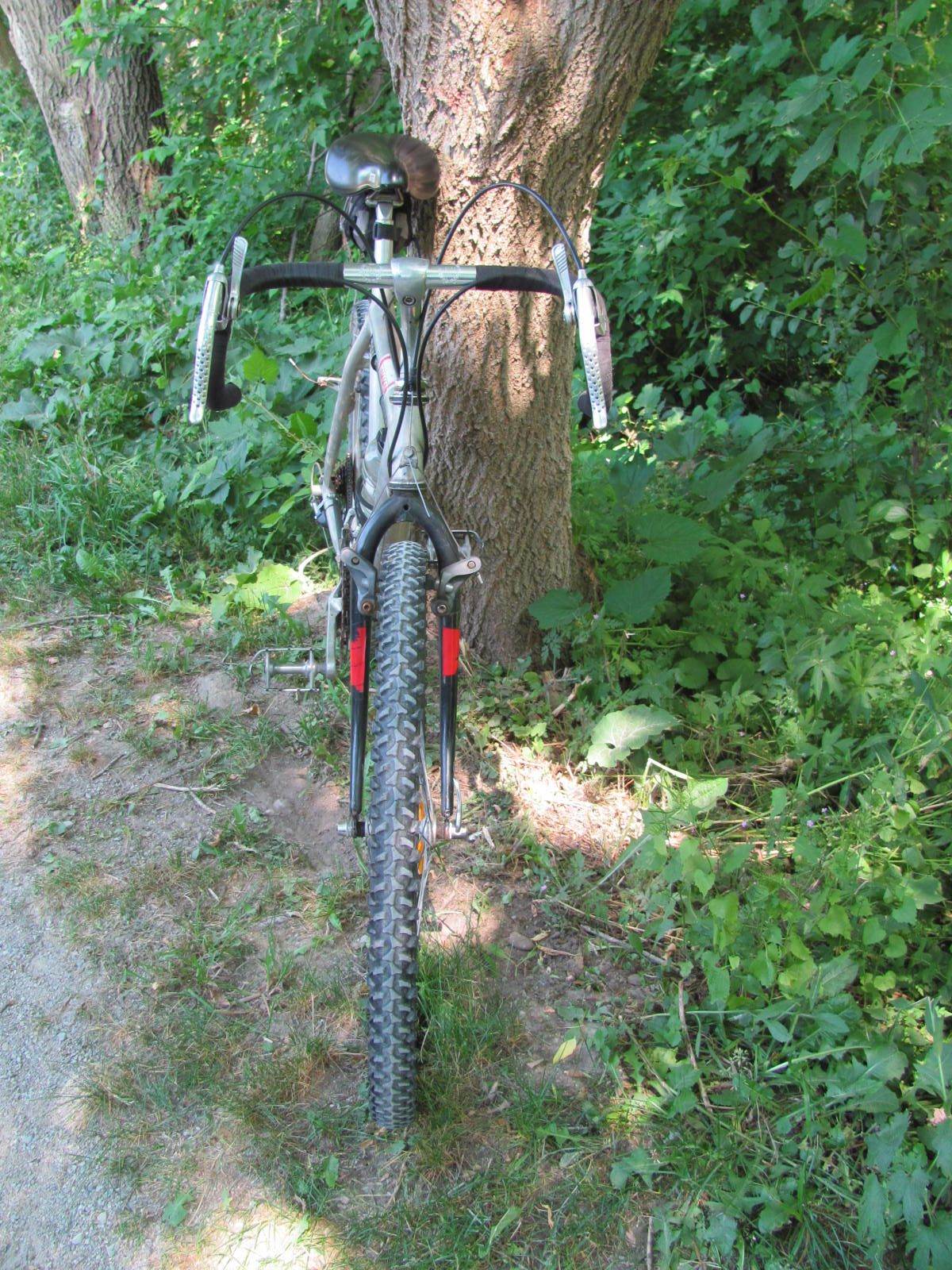

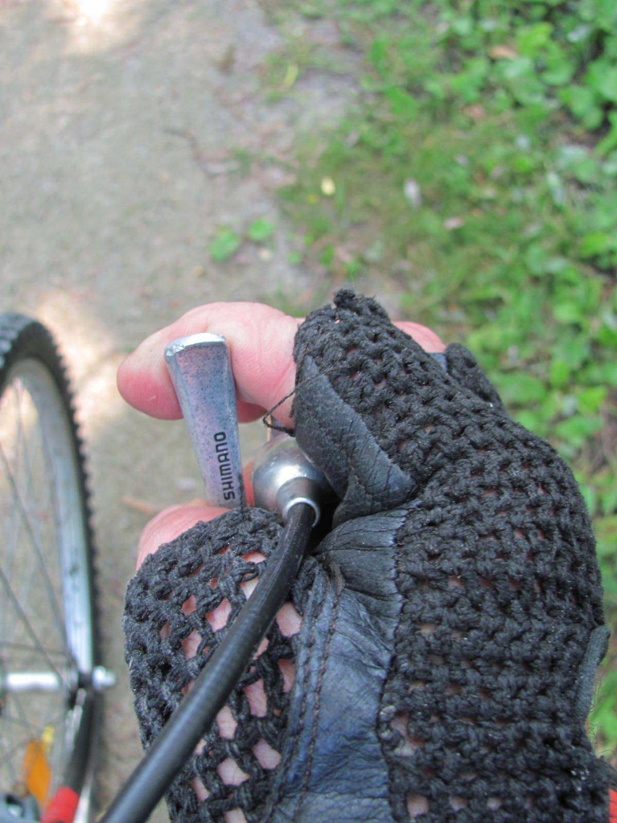

I put a pair of downtube or stem mount shifters onto modified Suicide Brake lever protrusions where the Suicide Brake lever used to go.

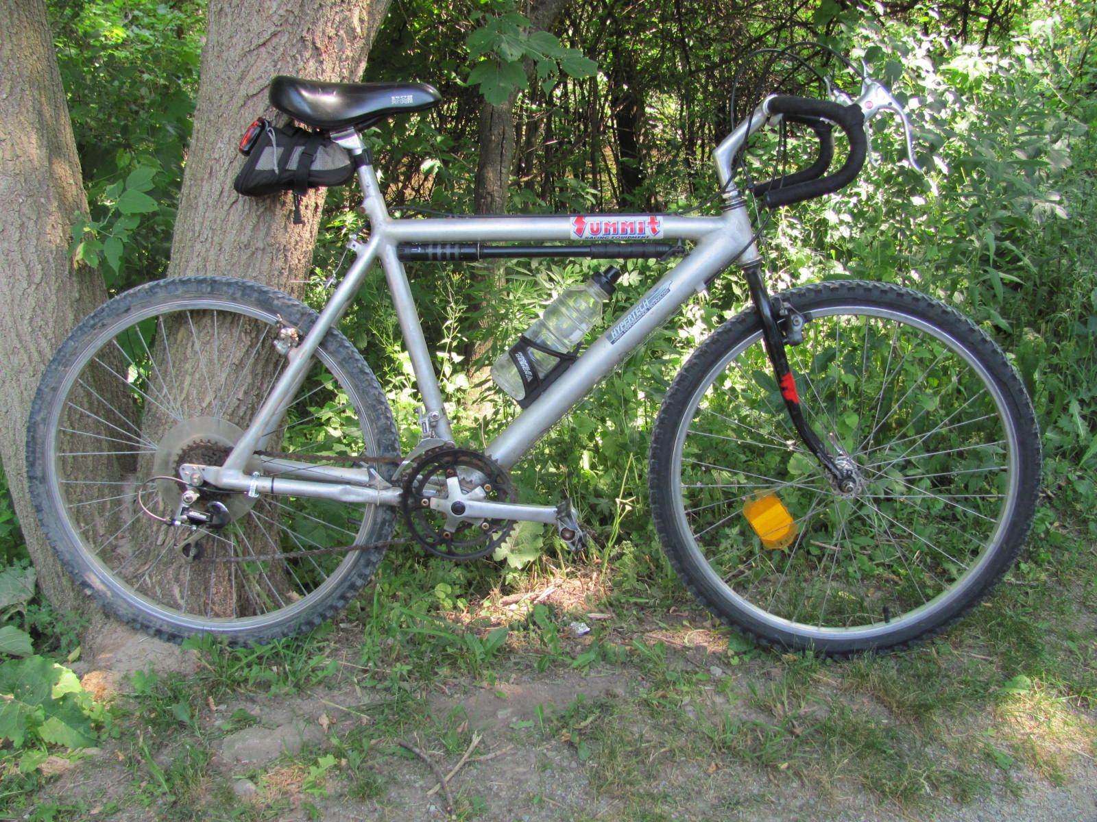

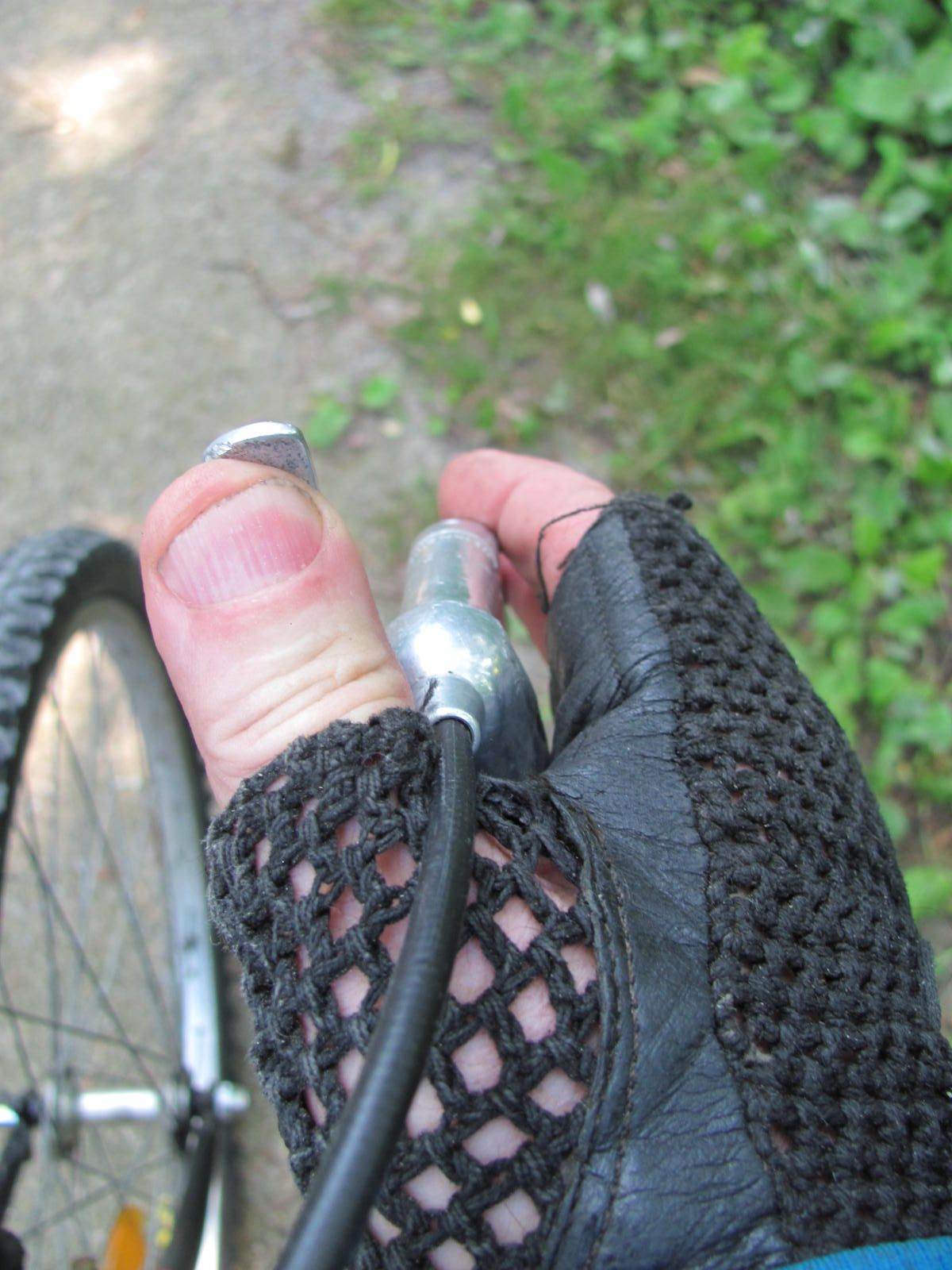

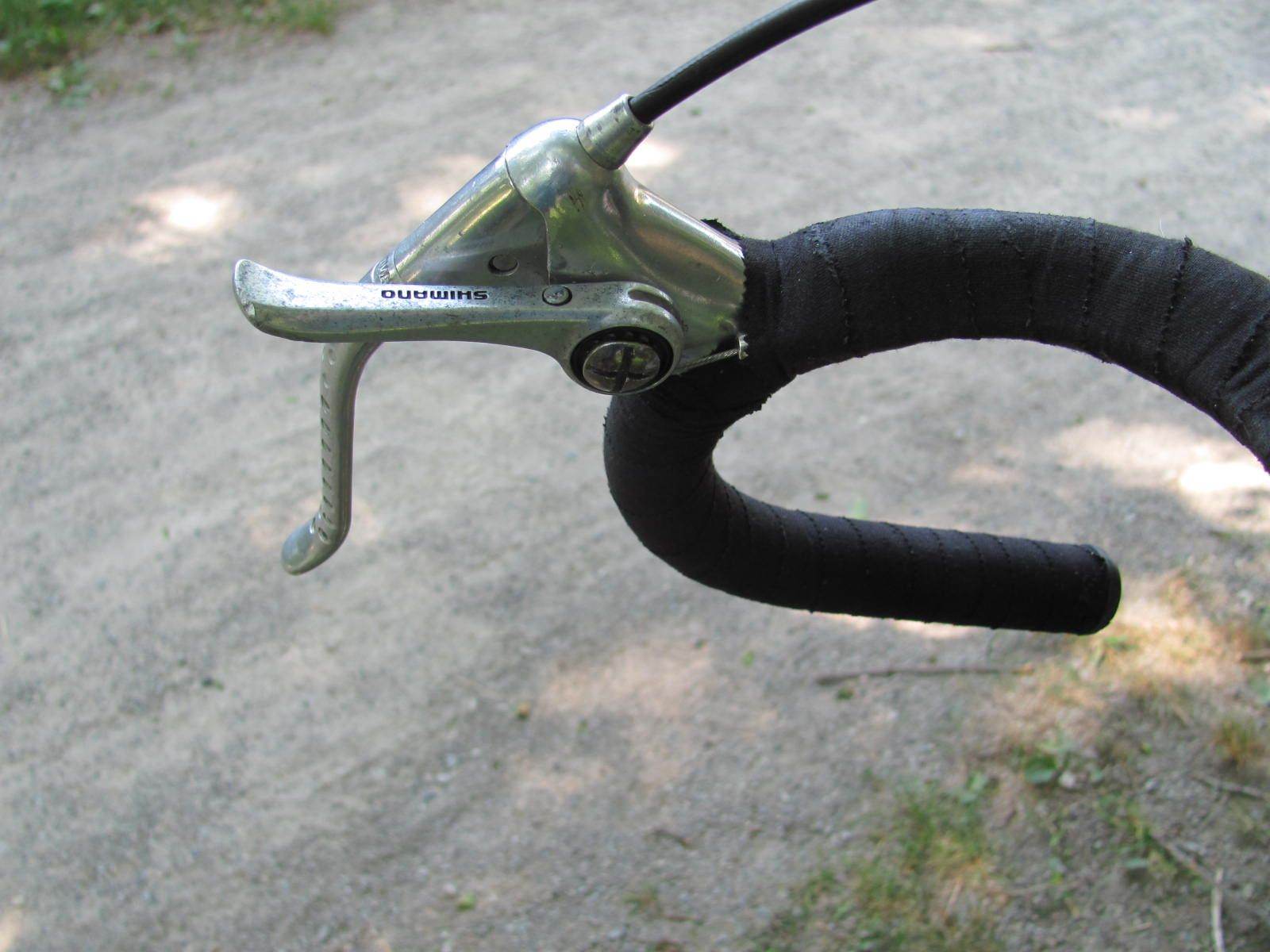

This is as odd as I got and how I done got it...
