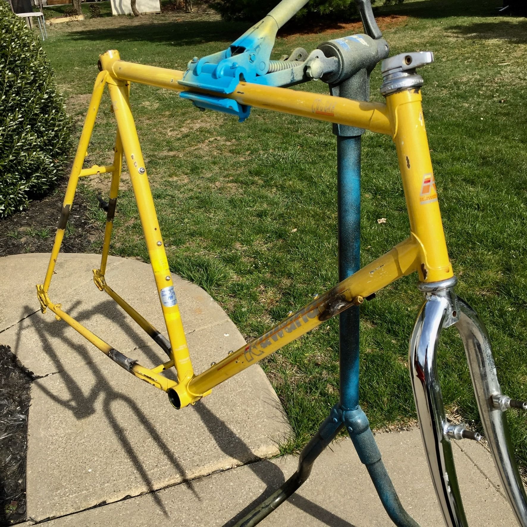

Good of you to be fixing up the Kuwahara. Pretty nice bikes. I bought a couger frame and fork couple years ago. Was planning to build drop bar but went other direction.
As found
Mock up drop style.
After repaint.
As found
Mock up drop style.
After repaint.

Kdogbikes - nicely done repurposing of your Kuwahara, quite an improvement over what it was originally! I am not nearly that ambitious although I suppose it might be worth going to drop bars if I felt it was truly beneficial, that would mean investing a few dollars into this Cascade as I would go with rando handlebars and a Nitto Technomic stem, possibly fenders and of course some nice tires. Who knows it might be an eventuality depending on what direction I go.
