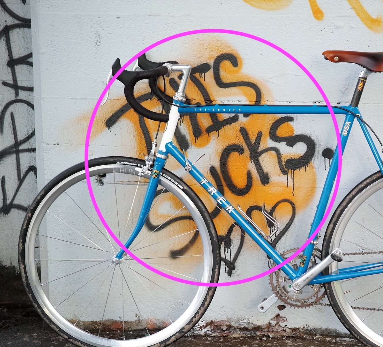

24" 1986 Trek 700 Tri Series
Trek 700 Tri Series frameset with sport touring geometry and Reynolds 531 tubes
As rebuilt last month to get on the road ASAP: Hunt aero wheelset, Ultegra / Dura Ace drivetrain, Nitto m151 bars and deluxe stem, Michelin 28mm Pro4 Endurance tires, Newbaum's bar tape, Berthoud Aravis saddle, Easton carbon seatpost, etc
Having since logged ~250 miles, I'm enjoying the whippy feel of 531c with semi slack angles and 42.5cm chainstays... lots of unforgiving tree root asphalt damage in and around Seattle to traverse
More than enough clearance in all areas that matter for 32mm GP5000s mounted to Hunt wheels with 19mm internal / 24mm external rim width (pictured below with 28mm Michelins that measure 31mm wide), though regardless of tire choice probably worth noting that the seat stay bridge is high enough that many modern calipers won't reach the brake track. Shimano R650s to the rescue...

False content warning: where's the "this sucks" part?
Cool bike and I hope you kept that white Concor around!

I’m missing out on the “sucks” part too. Cool bike and I like the wheels. Never seen those before. I’d like it even more with a shiny alloy or titanium seat post.

Have they changed the definition of “sucks”, connotative wise?

The only thing that sucks about this bike is that it isn't mine.
On a serious note: I've never seen silver Hunt wheels before. Where did you find those? Are they an older model or something cause I don't see them on their website.

I think that was the hook. It made me look.

Check the wall behind the bike.

Indeed, nothing about this sucks outside of the explosion of certain counter-cultural activities in my neighborhood
I have a polished aero seatpost that matches the look of the wheels... Not crazy about the Easton look but it offers notable flex to dampen road chatter. How does Ti feel?

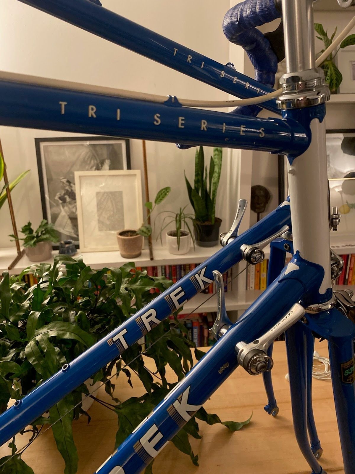

Well to be honest I do have another, identical except for the chainstay bridge

Those are unusually pretty head tube lugs and the white contrasting color is perfect with the blue. I saw these over in the other Trek 25” thread with the two different chain stay situations. So weird. Since you have two, you should 650b one and see what you like better!
great work!

Thanks! the colors warm up quite a bit in natural light, with the blue taking on a cerulean hue; now if only it had thinned and long point lugs like that alluring 710 (1979) of yours. My plan is to rebuild the twin 100% stock to appease the c&v gods but we'll see
