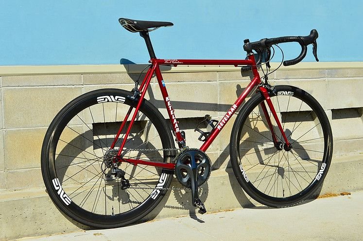

At the Velo Cult framebuilders show, Paul Ketelaar came from Austrailia with a frame he had done in it, he redid it several times before he got the hang of it but the end result was not the same for the small tubes although it was pretty awesome.
Real world numbers have this at easy $1k or more for a paint job that would be somewhat lackluster at best on a bike frame compared to a car.

There are places that have the experience though. One of them is Unlimited Colors in the Netherlands. Not sure about the price but they are pretty quick to reply if you e-mail them.
They do some crazy designs.

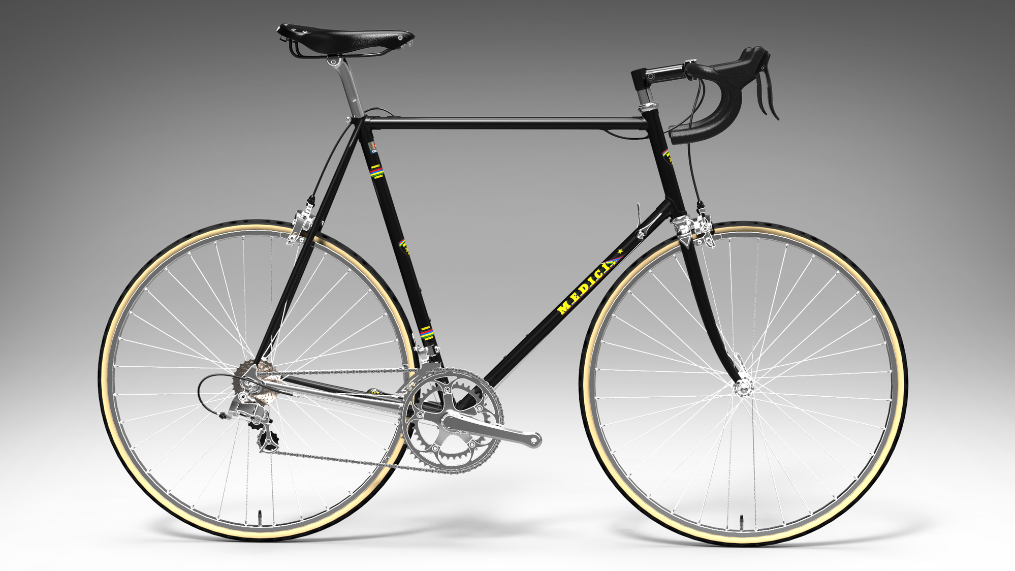

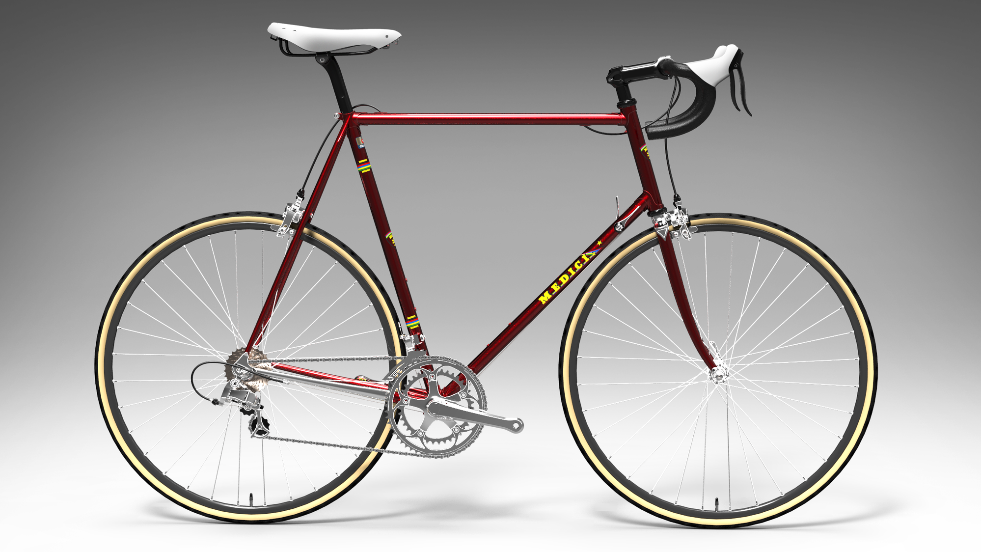

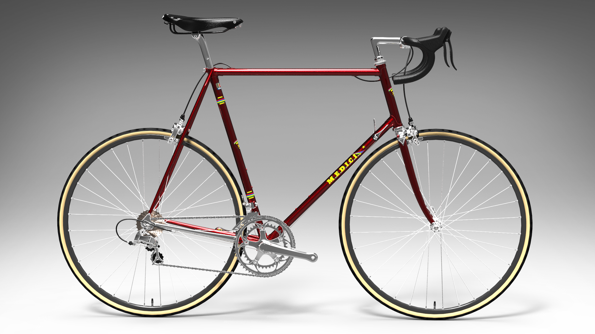

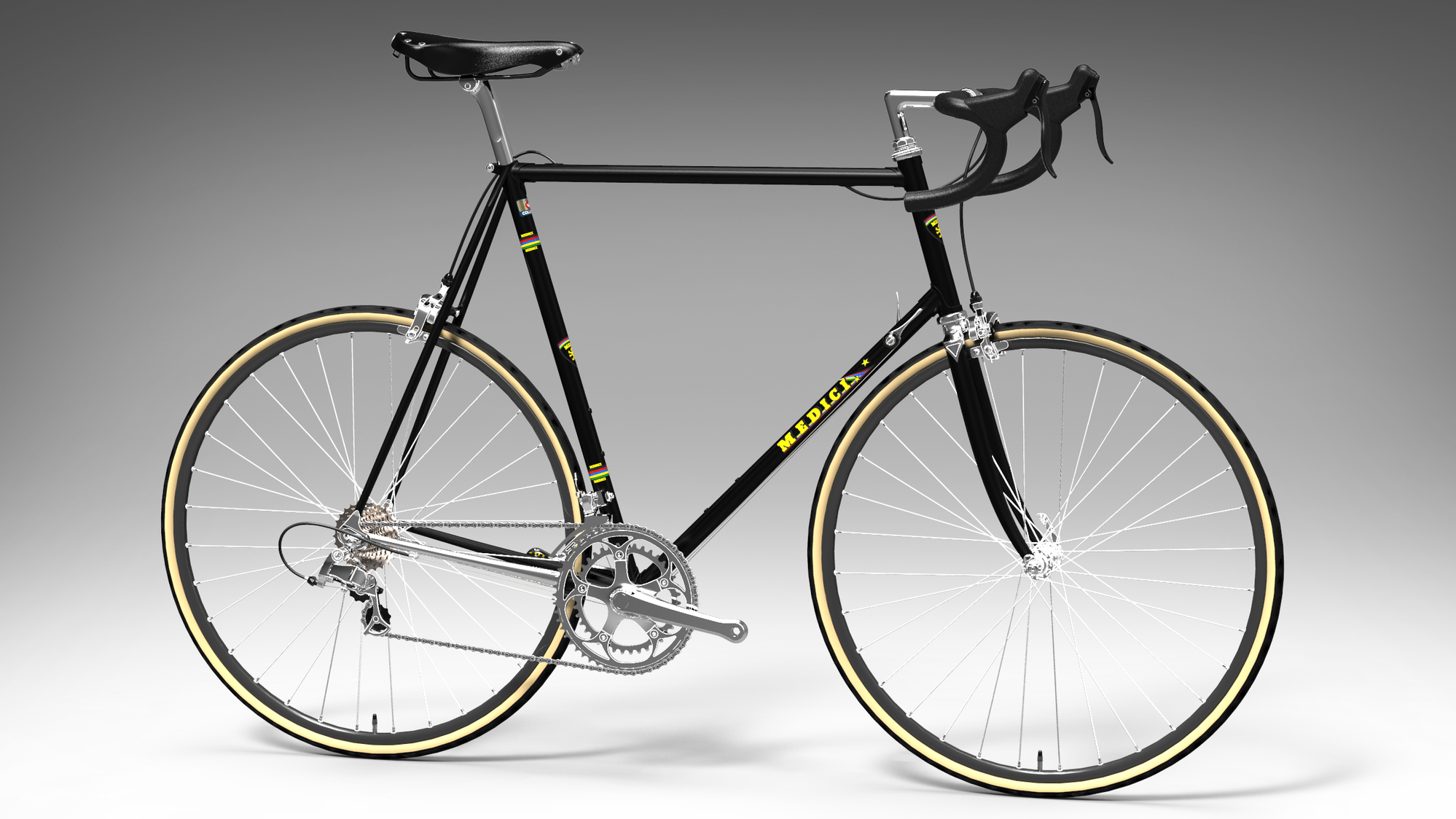

Ok, everyone. FINALLY. Been a rendering madman in addition to still working the component composition in light of my parallel Trek 510 project. Basically it comes down to saddle color on the 510 and the domino reaction to it either keeping its planned Open 4 CD wheelset, or getting the MA2 wheelset currently on the Medici. The MA2 was part of the current Medici plan before a well-loved Honey-colored Brooks saddle and Trek's Chestnut paint color clashed. The Trek's plan was to have a Honey colored saddle and bar tape--a "light colored upper"--with beautifully contrasting Open 4 rims, but with the 'weathered Honey' tone and the 510's color, that is now very much up in the air. Which means I must consider Open 4s for the Medici so that the Trek can have the "easier to match" polished silver wheelset. Which then throws the more finalized Medici composition plans up in the air, too! And we're back to that old stem angle chestnut, partially complicated by how the modern SRAM levers look with a traditional quill stem and thin bars.... Welcome to my brain at present. It's been a bit of a war. And if you are somewhat (or completely!) confused by all of this, let me present some lovely CAD renderings to both satisfy Text Central here as well as further tell the story.
For the last week or so, I have been hammering away at completing the bike's componentry, modeled after the actual components on the Medici at present. You learn quite a lot about component construction, thought process and detail when you take the calipers to these things.
Anyway, these first renderings will be of the bike with a stock, properly-measured Innicycle headset. This will give you an idea of the diameters and "visual masses" at play here in the front end with a non-slammed stem position and standard diameter tubing. I use the same color composition in all three images here--one of the finalized plans I had in my head--with the differences being solely in headset and stem arrangements. Note that the "bar tape" mimics vintage leather-wrapped bars as, annoyingly, my CAD program galactically overcomplicated the surface detail of a normal looking bar wrap job (aka HUGE data/file size increase = not good/wanted). Simplify, get the "wrap diameter" close, adapt, and move forward. Note 2: How GOOD does a fully "built" bike in CAD look vs the partially built stuff before??? Note 3: Absolutely NAILED those SRAM levers, right??
Image A: 1 1/8" stem on Innicycle headset with normal headset spacers that you'd see on a modern threadless-steerer bike. Stem is the inside-wedge type, and this was done to minimize the visual mass as much as possible given the stem's height and position on a tall, slender frame.
Image B: Same as above, but with the spacers removed. You can see how an older or cheaper threadless stem, with its thick steerer wraparound section, looks more "lollipop" than we'd probably like. Certainly for me. But honest representation helps us decide, so I include it. The Innicycle's diameter is nice otherwise (less than the head lug diameter).
Image C: I modified the Innicycle headset, bumping the lower diameter out a hair and creating a 1" steerer section so that a 1" threadless stem (with traditional clamping bolt positions) would appear flush (in diameter) to the rest of the headset/stem assembly. It helps quite a bit.
Image D: Same as Image C but with polished silver seatpost, headset, and stem. Saddle and hood colors switched to black (what I presently own).
Image E: Part way through my initial dozen or so batch of renderings (at the time), I switched to a side view, which I really like. This color combination is Image C, and you can see how the stem angle matches the hood (top edge) angle. Really complementary.
Image F: Up close and personal with the modified Innicycle headset. It's still a pretty "techy" look when looking at the quite traditional overall composition. Silver or black headset/stem--doesn't really matter. This has led to much consternation and mulling over.

So what do you do with an agreeable-enough stem and headset solution that clashes with a traditional-looking build otherwise? Change the color. 1974 Paramount Part II. Pirate. Carbon Hunter. Remove a big traditional element and let the bike's components do the talking.
Full stealth with a dash of flash at the top. Still modified Innicycle headset.
Standard Innicycle headset, in silver, with a 1 1/8" stem that, apart from its inside wedge/clamping system, imitates a modern, high-end stem with it's minimal steerer wraparound thickness (2mm). If I went the matte black and MA2 route, this would be the setup I'd run.

But what if a quill stem became an option again, due to the need to run Open 4 wheels and having that composition change not work with the modern headset and stem combination? What if the only truly 73° quill stem out there, of good quality, and actually somewhat available, was the venerable Cinelli 1A? Forget not wanting to mess with a shim, if I can go traditional on that front, I will happily put up with shimming it!
Let's see what it looks like... Nice! Even the SRAM levers play along. And here, I basically build my dream '80s Paramount, branded water bottles included, as a Medici.
Hot side view. You can see the stem angle down eeeeever so slightly, which is accurate. Still looks fine, though (real life mounting will have to confirm good/bad, as always). Angled bar and SRAM levers also plays nice. Whew!
The "Parts I Actually Have" build/composition.
Looking good.
Matte black version. Yes, please.
Classically good looking (to me!).
Hey, how about we go "full ['80s] send" and throw down some hot pink / flamingo / fuchsia and let the dark anodized components bring the heavy contrast? A bit of go-fast, a bit of Miami Vice, and a whole lotta double-takes.
I mean, I'm game if you are, and I am REALLY GAME to do this!

I visited Recycled Cycles and did some stem-to-stem comparisons as well as lined up a Cinelli 1A stem they had to my frame. Sigh. All angled down noticeably. I brought a threadless stem I'd bought at Bike Works a few weeks prior, and slotted it onto a black 1 1/8" steerer of one of the forks RC had on their rack. It looked pretty darn good! No "lollipop" issues, or at least, ones that would be problematic. At this point, it was high time to put this stem dilemma/torture to bed. The threadless stem, a very svelte and sharp looking 3TTT ARX II Team 100mm unit with a 31.8mm bar clamp diameter, is the chosen stem. Yes, I will have to now source a 31.8mm clamp bar, but I will live. An Innicycle headset will have to be obtained as well.
Not to assume too much, I ended up replicating the 3TTT stem in CAD yesterday, because of course I did. I need to see how it looks! Interesting fact: this 3TTT (31.8mm clamp) stem is 1mm or less wider and taller (in main body/shaft cross-sectional dimension) than the no-name 26.0mm clamp stem, which I found both surprising and encouraging. A quality 31.8mm bar is going to feel even better/less harsh than a 26.0mm bar, if my experience proves correct.
I will show the three final color choices I'm focusing in on--nothing you've seen before, but with the considerable finalization of the headset/stem/bar situation, it will give you an idea of what colors and compositions play best together.
Firstly, the candy red metallic option. A more normal red (like fire engine red) just looks a bit trite, so deep candy it is. Still heavily on the fence about this color working with the stem, but it is what it is...
The stem is a clean-looking unit, I will say. Torx bolts are the fancy pants name of the game here, which...I wish they just used Allen bolts.
Matte/satin black. Still looks great, especially if a silver headset is employed. The continuous black is broken up while not messing up the overall upper frame/bike visual mass balance.
Even better.
Tops in the "lolz" category, but also tops in the "This looks soooo cool" category as well. The difference between leaving the fork crown chrome and painting the fork crown is huge. That "color solidarity" is, from what I witness here, critical in "combating" the untraditional and visually bulkier (compared to a quill stem) threadless headset and stem situation--especially an all-black arrangement. It's a party and people are getting along. Thus it remains a frontrunner.
You can see the "continuous color" from the fork dropouts all the way up to the upper headset cup. The visual "message" is delivered strongly before a new "message," that of the thicker, black headset and stem, is given.
Here's an up close shot of the 3TTT stem. It isn't labeled, and is naturally a little more matte, but this gets the point across well. The lower stem clamp/wrap-to-steerer transition is more of a stem than it seems, but that's CAD and renderings for you. In real life, it looks smaller and thus even better.
Yes, I even got the "3T" cutout into the stem's faceplate, just like the real one.
Even better.
