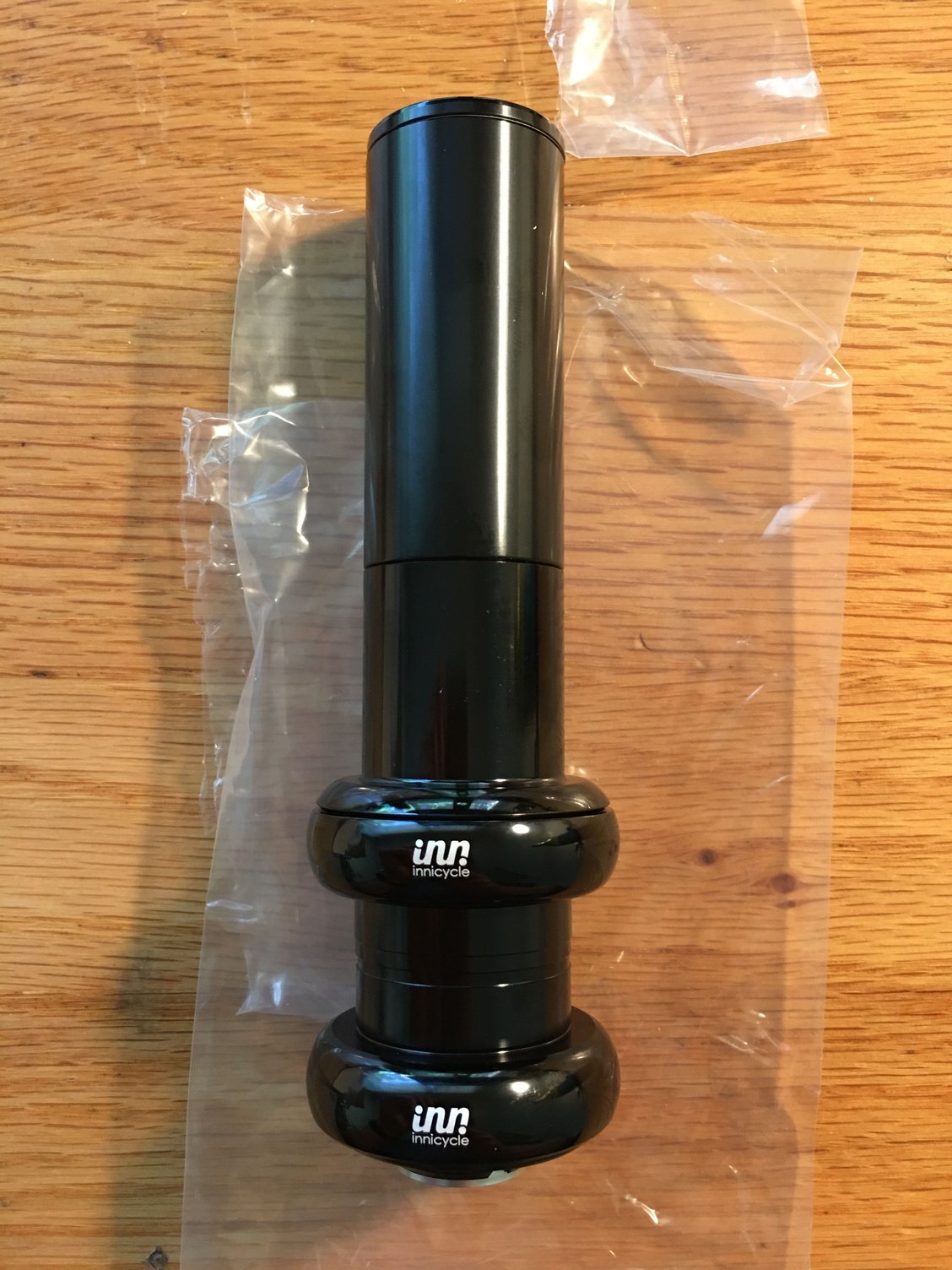

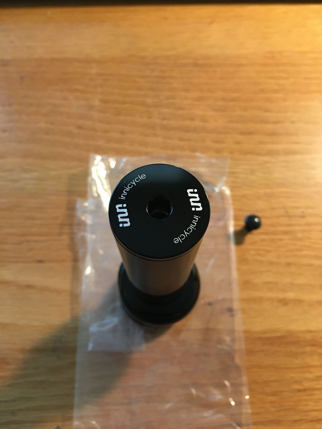

This is a gorgeous piece! It's even going on a same-era Trek.
There is a lot of great detailing on this headset, which I can expand upon if any of you would like. It weighed in at 241g, just a gram above the claimed 240g weight. Awesome.
One could get Shimano Ultegra R8000 brake calipers, or they could get these. Same money, different application. Not cheap, but these TRP CX 8.4s are (also) gorgeous, and as mimi-Vs, they work with road-style brake levers (Campy and SRAM officially).
The automotive design major (and sleek form lover) in me just digs these! Look at them!
Cool hardware here, complete with titanium mounting bolts. The noodles have barrel adjusters to work cable tension/take up. So far, the one I've installed on the back doesn't do anything. That's a bummer, but it's not even an issue for me--most V-brakes don't have those anyways, so this is a (potential) bonus. I'll fiddle around with it some more to see if I can get it to work.
