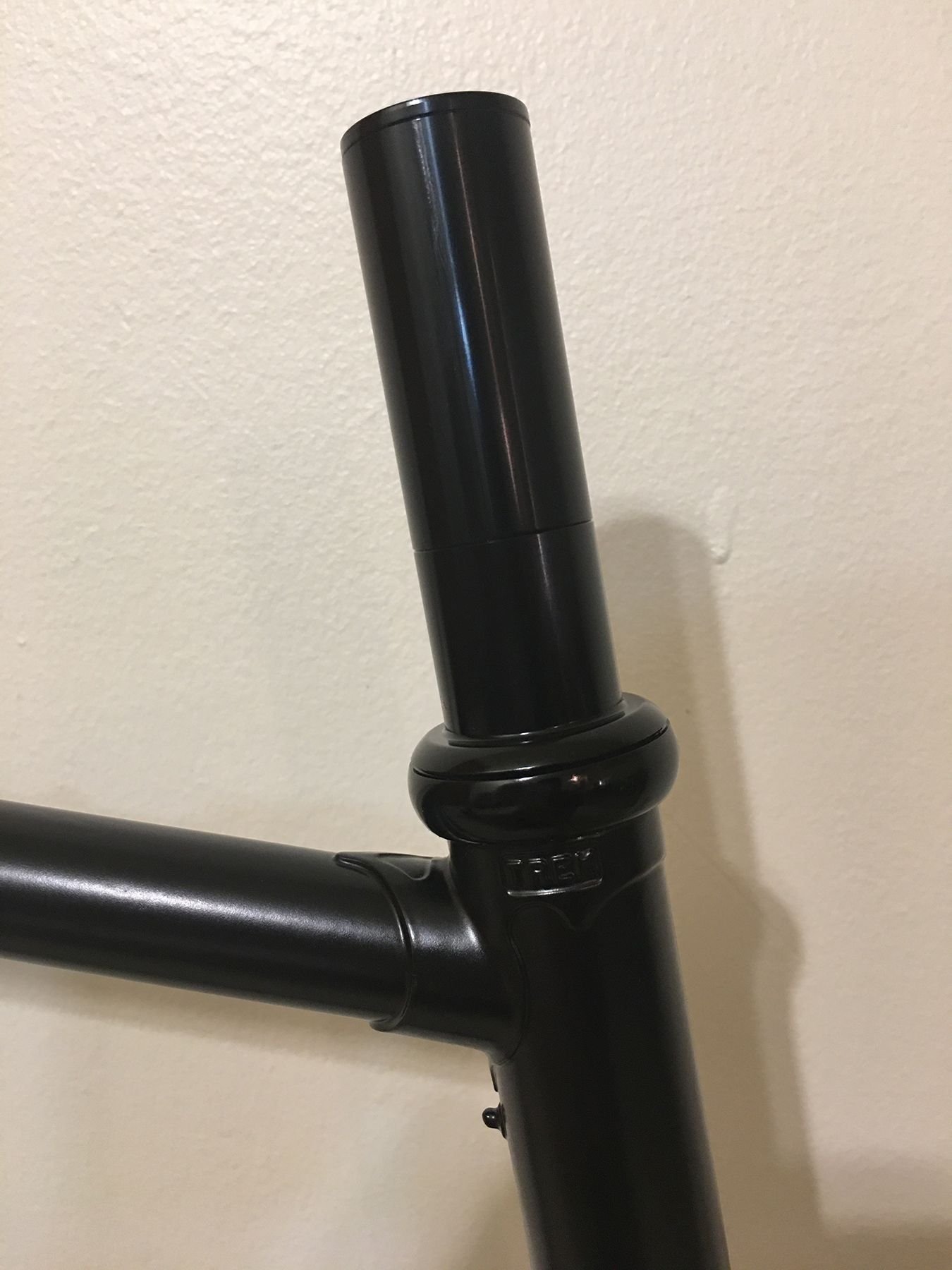

The proportions thing is real, especially for taller riders. For some, the tall head tube just throws off the look of the bike. It's probably why a lot of tall riders are on the lookout for a Cannondale. The OS tubing takes care of that "odd" look. Just as STI's and modern components eventually made their way into this fabulous forum, we are now entering a crossroads where some of the newer frame technologies are becoming more available at a price point that becomes very attractive. As seen above, looking to achieve certain things can become complicated, and expensive, and sometimes not possible. Riddle mentioned it briefly, but it has flown under the radar what was available for $10. Obviously, that is an extremely fortunate example, but like I said, crossroads.
I recently picked up a prime example of this (pickup scheduled). I wasn't in the market, but we all know how that goes. I didn't believe the picture and the owner had a chuckle as he shared my same thoughts. This isn't your dads 62cm proportioned bike. It looks like a 58cm. Never in a million years did I think I would own a Surly, but here we are, at a price point cheaper than a Walmart bike. 32c here I come. Just like the STI's, at some point you just can't say no. And yes - I'm crossing my fingers that the seatpost is the Dura Ace aero

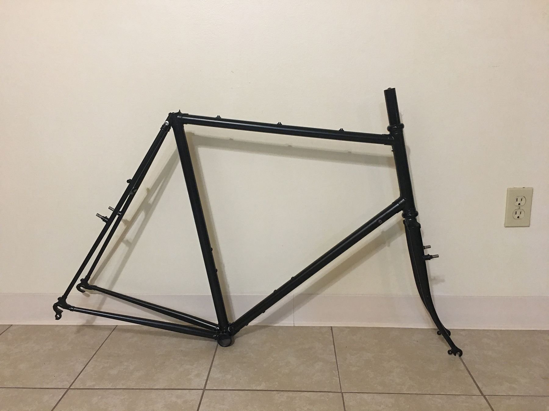

The $10 Nashbar frameset was indeed a for-a-song price, and would normally be $75-100 on CL. $10 gave room for other components to be bought and not balloon the eventual asking price into unwanted territory.
As a number of early-'00s bikes and framesets reach their desirability nadir (15-20 years old seems to be the trough of a bike's value curve, assuming it is semi-desirable or more in the first place), we will find more of these deals. As a 6'5" rider, from about 1990 to about 2010, give or take a year or two, is the Era of Abandonment (or Great Betrayal) for properly tall production frames. Cannondale, among very few, were the keepers of the flame. Surlys do have a lot to offer, provided the look, weight, and geometry are to one's preference. I've long found them to have much too long a top tube for their stated height/size, with their height/size offerings not being tall enough. I find Somas to be more attractively proportioned (commensurate price increase, naturally) and much closer to fitting me (stack and reach, primarily). That Nashbar frame was revelatory. Trek has made their FX line for at least a decade. Steel, aluminum, or carbon for the forks depending on the level (7.1FX, 7.2FX, 7.3FX, 7.5FX, 7.7FX etc). Twin bottle cage bosses and stack/reach specs, at least at the largest 25" size, to be nearly identical to my 620 and other 25.5" Treks of the mid-'80s. And this is a flat bar hybrid (where a super long TT is the norm), which means drop bar conversions are a snap. 44.5cm to 45cm chainstays (and early-'80s touring bike angles/fork geo), room for 40mm tires if you do it right, V-brakes for great stopping power. Enthusiastic aluminum frame (modern Trek aluminum is a lot of fun). I keep a lookout for a good deal on one as it would be fun to try a modern "hybrid" that possesses considerable vintage touring geometry DNA. Just don't ask me why they put the seat tube bottle cage so freaking low--I don't know either!

Bike has been dropped off and now the four or so week wait begins. New decals ordered as well, and that was today, after much Photoshopping, research, and mental effort. A light metallic silver will be the primary color, and a nicely dark grey will be the striped "shadowing" for the TREK and USA logos. The greyscale theme keeps in line with the (mid) 1980s. I considered gold/light gold for the John Player Special touch, but it's the wrong decade and things just didn't quite line up there. I also considered white main graphics like my Paramount (and various late-'80s road/race Schwinns), but concluded that it was a bit too "obvious" or stark. The 620's original graphic scheme, along with most Treks of that era (and before), are not as readily indulgent of "in-your-face" compositions. They'll step out confidently, but stop short of being over-the-top. The silver/dark grey graphics continue that ethos, and allow the 'techy' era 620 to be a composition other than its original blue. It's going to look so good when it's done!

After waiting three and a half weeks of an "about four weeks" lead time, I got the call that the 620 frame and fork were complete! I was on my way to visiting a friend when I received the voice message, and it was too late in the day to--should I have been available--endure five crappy sections of I-5 on the way to and from Olympia in any sort of sane, acceptable travel time. So I did it yesterday morning (9:30am to noon, more or less) and still had a few crappy sections of traffic. Get it together, western Washington!
Some photos of my "I can't believe it looks this good!!!" 620, courtesy of my nearsighted iphone8:

I spent most of yesterday helping some friends move after getting home from Olympia, so when I got home it was time to install the Innicycle headset!
A preview of an assembled frameset:
Night time wrenching. There's this machined ridge that, certainly for the home-headset-installer, has to be accounted for. I did so by putting a 20mm 1 1/8" spacer inside the cup against its flat surface and then having my homemade tool press against the spacer. A single Innicycle logo/graphic exists, so I elected to put it facing forward.
[Work magically happens "off camera"] Alas, the final product! Lots of grease on bearings, cups, threads and races later and we have the beginnings of 50 Shade of Black.
"Top cap" that secures the top piece/quill to the steerer and locks the bearing preload and entire assembly in.
Upper cup logo centered. Whew.
Lower one as well. Whew 2x.
The powder coating minimally affected frame detail--certainly well within my tolerance/expectation window. A very good thing. No textured finish. The lower headset assembly has a taller stack height than the original Stronglight unit, so the geometry is ever so slightly changed. It will likely be impossible to notice.
Upper assembly view. So very clean.
The First Silver (back on the bike) portends what is to come!

The next step, aside from waiting for Velocals to get my order completed and mailed to me [I am in the 15-20 business day window presently, but man would it really help a guy out if they hustled it along. I know, wait to fill up enough orders to make a print run most cost-efficient regarding material usage, but dang...], is actually several steps.
I do have a head badge to mount, but I put the frameset up on its wheels to set saddle position and, crucially, stem/bar/brake lever positions. I aim to replicate the 510's setup on this 620 as that proved comfortable on my 70-miler two weeks ago.
So, you all get a good preview of the overall proportion of the bike. Silver+dark grey decals, the gold head badge, and the silver drivetrain will do wonders to bring out the intrigue, depth, and contrast. CAN'T. WAIT. For now, it looks like I'll need a 110mm stem, a 5-7mm stem mounting point drop, bar rotation up (not pointing downward), and brake lever reposition. I'll be running the stem with no spacers below it to 1) not bulk up the top segment of the bike and introduce an aesthetic imbalance to the bike, and 2) well, I don't need to as I've run this stem on my quill conversion with no spacers directly pressed on by the stem. Save weight, work properly, and look better. Works for me!
(Bottom bracket added for more accurate saddle measuring and setting purposes)
