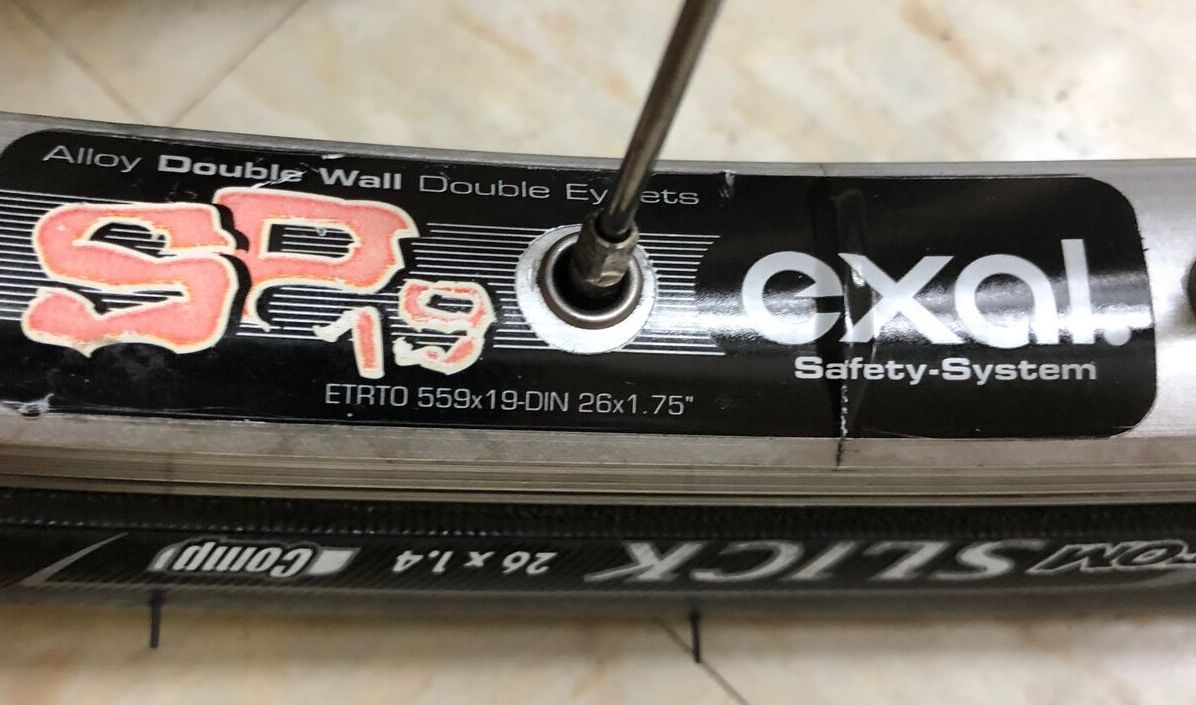

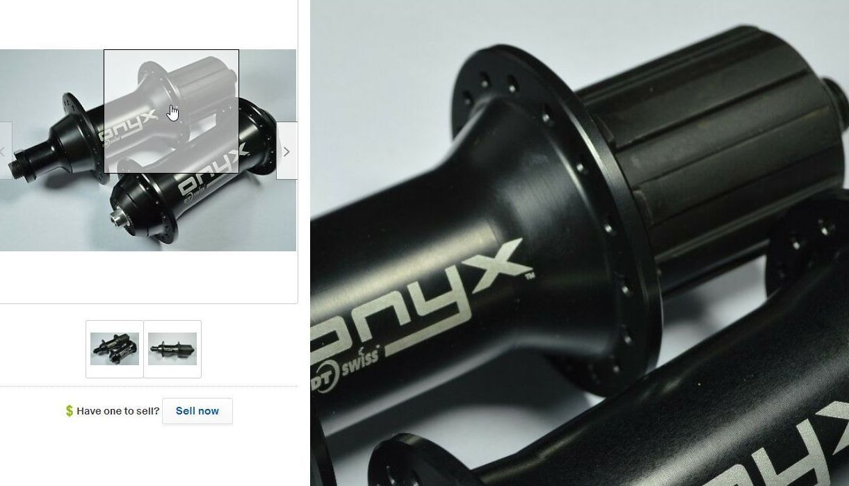

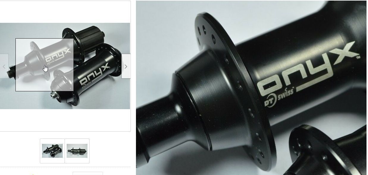

This wheel was off a factory bike bought in Switzerland in 2005 and has a hub model make of ONYX by DT SWISS. picture attached. The rim is a stout
double wall rim "EXAL SP-19" in 559 size. . I assume the 9 gear cassette will have to come off and then a good spoke is going to have to be removed

A spoke protector would not help unless it purely filled up the space between the sprocket and the spokes. The reason for the damage is the space existing
is too narrow for the chain to slide down between the spokes and the sprocket. and when I peddeled, it forced the chain down in between like a hammer and
wedge breaking the spokes. I could envision another sprocket without any teeth that was slightly larger to keep the chain from coming off the last biggest sprocket
I am not aware of anything like that existing ? ? ?

That hub takes standard spokes. A shop will just measure the thickness and length and replace the damaged ones with similar. (I doubt all the spokes of that side need replacing unless you actually did scratch/gouge them all.)
