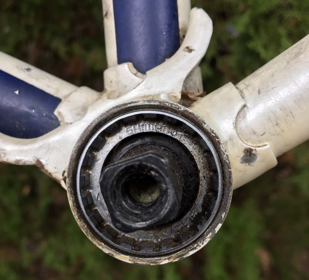

Anyway, here's the BB DS spindle:
And here's the NDS
which answers my question, since Shimano have so graciously indicated which way to tighten. How very Japanese! Anyway, brilliant suggestion on taking photos or I might not have noticed!
But closer scrutiny brings up more questions:

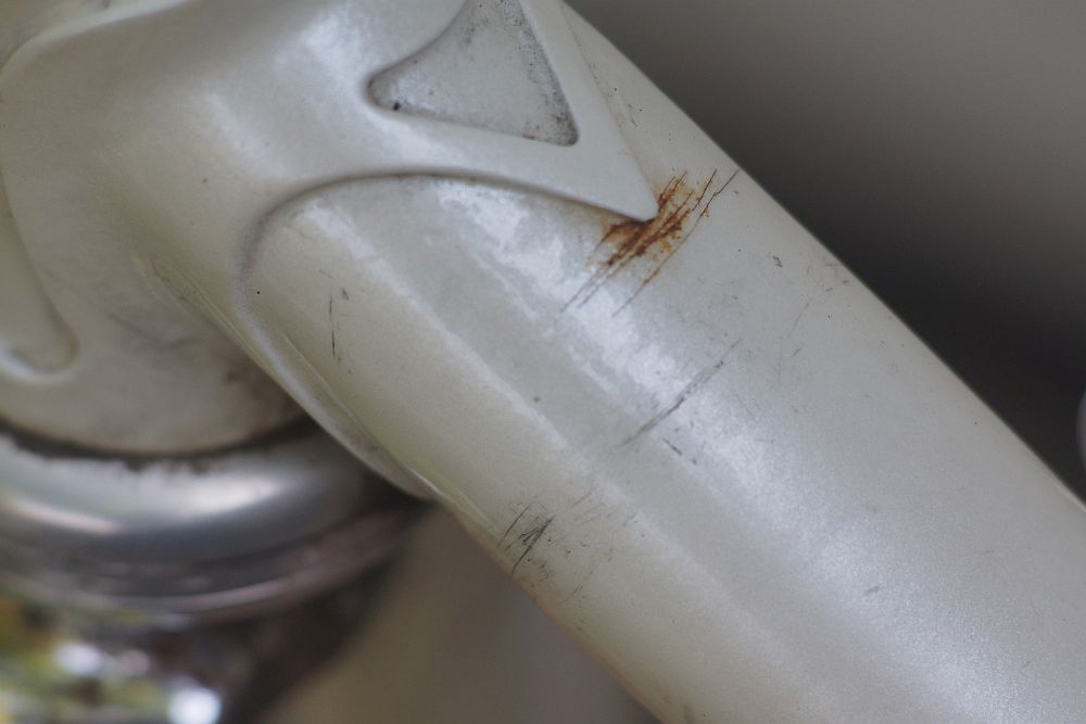

And finally (for now anyway), there's a rust problem here under the paint it seems. What's the best way to deal with this?

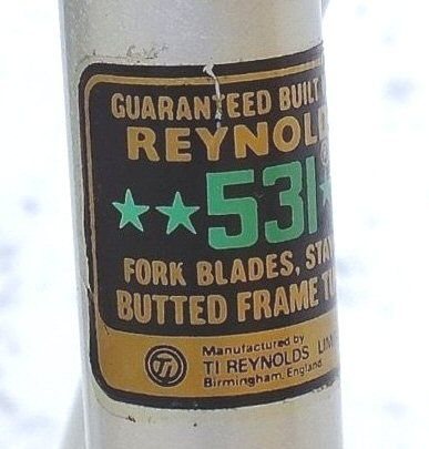

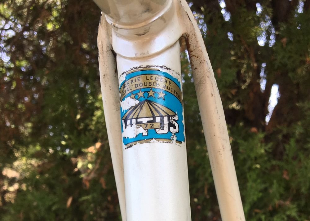

The Vitus decal on the fork lists the chainstays, seatstays and forks as being built from Vitus 172. Its a complete 172 frameset.
Having one now reminds me that I've never understood these Shimano BBs. Why recess the cups like that? Everybody else tries to minimize the bending load on the spindle. I suppose it wasn't really a problem ... at least until they decided we needed oversized spindles and external cups, anyway.
@bertinjim, thanks for the translation. That makes a lot more sense than "wire based forks"!

Your Shimano sealed bearing cartridge BB is stamped BC 1.37 68 which has standard British threads. That design was used successfully for decades on millions of bikes around the globe. You can still get quality Shimano replacement cartridges for ~$20 USD on line. Most Japanese double cranks should fit without a problem.

Double Butted is an abused BS term used by marketoids. Only the Top Tubes and Down Tubes are Double Butted. With the exception of Asian frames made with some types of Japanese tubing, Seat Tubes are Single Butted. Steerer Tubes are usually Single Butted. So are some fork blades. All the rest of the tubes are Straight Gauge - no taper in the wall thickness.
Vitus 172 had the same strength and wall thickness as the Reynolds 531 tubing that was used on most Continental European production bikes: 1.0mm on the butted ends, 0.7mm in the thinner sections.

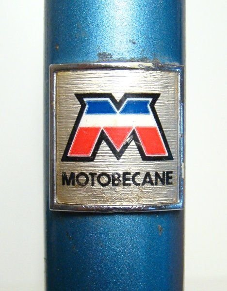

Lastly, the original head tube badge looked like this:

I don't want to be the grim reaper and I hope I'm wrong, but those lines in the paint at the head lug could be from a front end collision. I would run a straight edge along the bottom of the top tube and down tube just to make sure,

I hope he's wrong, too. It might just be frost damage. I've got a '78 Moto Gr. Rec. and it's got those tell tale signs and an ever so slightly bulged headtube to boot. I checked the relative angles of the seat and head tube with an iPhone to gauge any damage. The angles were OK and frame was still straight. It cleaned up real nice, and it's still a sweet ride.

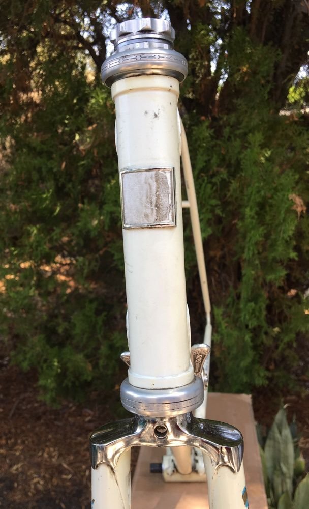

Lightly bulged head tube

Heat Tube Heat Bulge
verktyg covered it all the details for you. The tubing stickers don't leave much doubt, but you could check the seat and chainstays to see if they're stamped V.172. The '78 catalog only spec'd the main tubes of the Gr. Rec. as Vitus 172 that year, but the seat and chainstays on mine were all stamped V.172. So it's full Vitus 172, just not all double-butted.
The bulge in your head tube is caused from slight overheating during brazing. The tubing expands but the brazing material in the top or bottom has solidified so there is no place for the tube to go but to bulge out. Happens a lot in seat lugs but not as noticeable.
It's not really a problem because Vitus 172 was a low alloy steel and not as susceptible to overheating as Reynolds 531, Columbus and other 4130 ally tubes.
Those cracks in the paint are not always fatal because steel can flex a certain amount before taking a permanent set (deformation). The paint is hard a will crack.
But... all said, I'd send it back, you never know what damage has been done to the forks. At the minimum the forks and frame should be realigned.

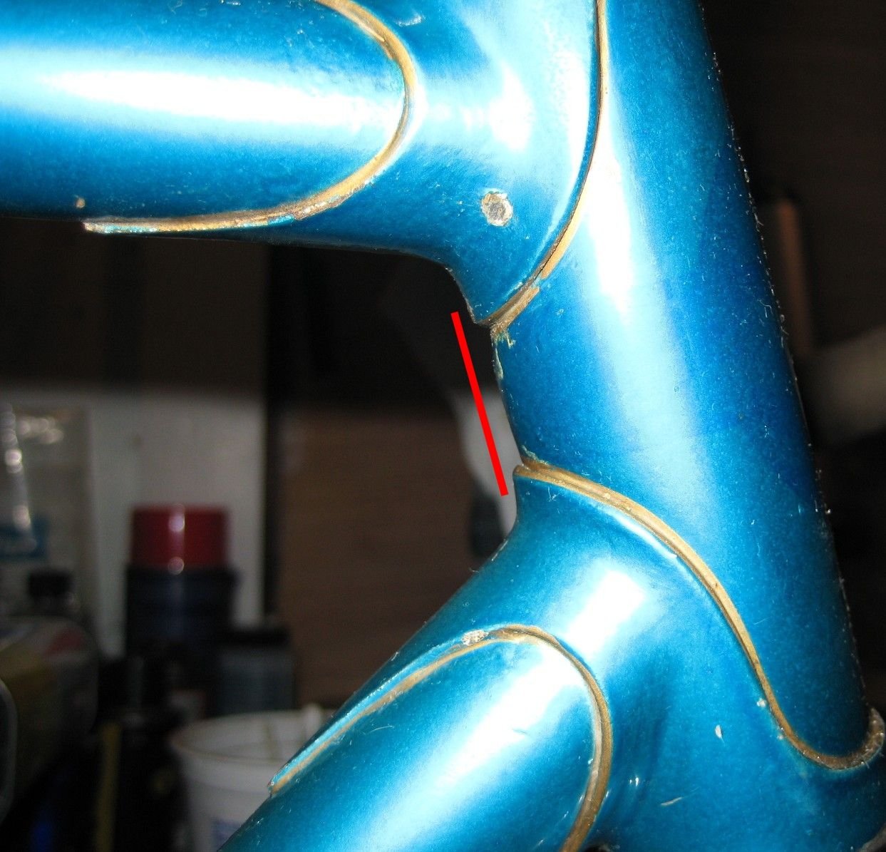

My Moto Gr. Rec. has some other evidence of a possible impact. It has the paint cracks on the head and down tube similar to the O.P. frame and the original brake caliper arms had stress cracks. My iPhone angles for the head and seat tube suggested the alignment was pretty good, but to be sure I did have a frame maker check it out (though for a few dollars more, ~$80).
I don't know how much the O.P. paid for the frame, but if he can get a full refund, then by all means. Or if he can get a refund for the cost of the frame alignment...
verktyg Yes, I gathered that only the top and down tubes were double-butted from your description. I was just surprised to find that all of the tubes in my '78 frame were stamped V.172 as the 78 Moto catalog notes that 3 Tubes were Vitus 172 (not completely accurate per your comment) while the next model up, "Le Champion", specs Double butted Reynolds for 9 tubes- although I'm not sure which is the ninth tube (seat and chainstays= 4; seat, top, down, and head tube= 4; RR brake bridge (?)). Thank you for your reply.

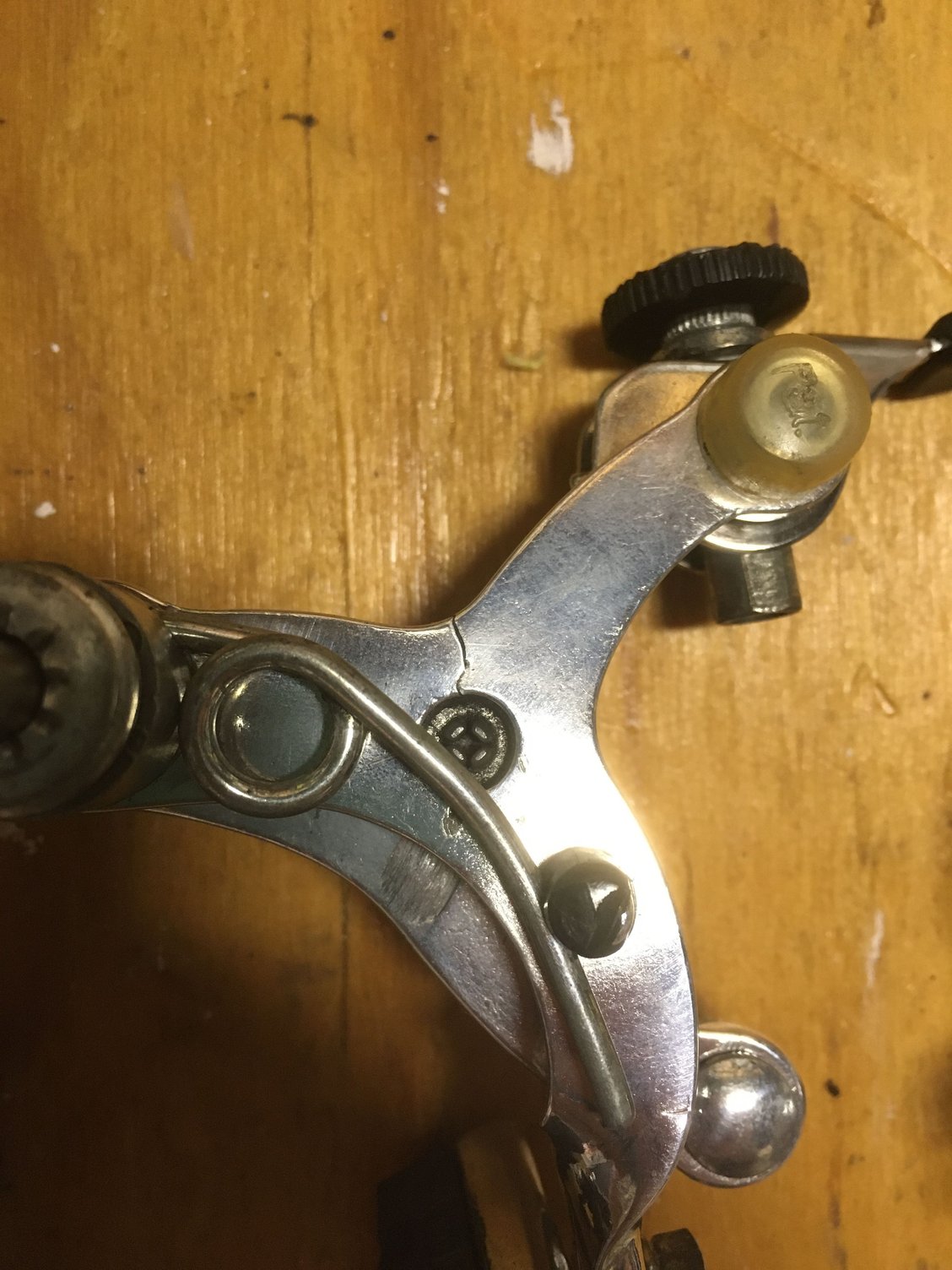

Not the best picture, but there's a bit of a "burp" in the downtube opposite the paint cracking.
Stress crack in the Weinmann 605 brake caliper arm

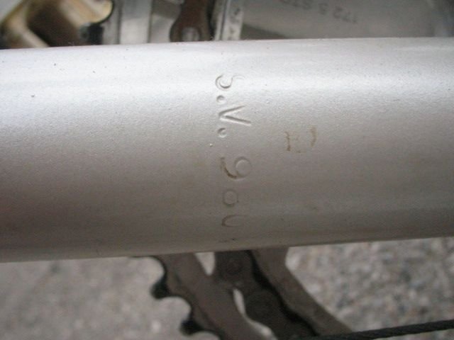

Vitus 172
Stress crack in the Weinmann 605 brake caliper arm.
Here's a bulge in the head tube of a 1970 Gitane that I had.
The cracks in the paint and the ripple on the underside on the down tube indicate a front ender!
Double Butted was a term that marketoids who knew little or nothing about bikes ran away with back in the early 70's (at the beginning of the Bike Boom). It continued to the end of the steel bike era.
I suspect that it resulted when several authors who wrote bike books back then got carried away describing the multitude of different Reynolds 531 tubing offered and their various stickers:straight gauge 3 main tubes, butted 3 main tubes, full Reynolds 531 frames with straight or butted main tubes and so on.
Novice bike buyers (and bike sellers) got lured into the magic of a Reynolds sticker with no understanding of what it meant. Then throw in French stickers...
In the mid to late 70's Schwinn and to some degree Raleigh changed their Reynolds stickers to say 531 FORK BLADES, STAYS, BUTTED FRAME TUBES - truth in advertising!
Many bike and frame builders, even some of the top names used CHEAP seamed tubing for their head tubes instead of Reynolds or Columbus. The easy way to tell is to look inside for a seam when the fork is out. Also many used cheap steerers as well. I've seen top quality frames with a piece of straight gauge pipe that had a sleeve brazed into the bottom for a steerer.
As you pointed out:
Main Tubes = 3
Head Tube = 1
Fork Blades = 2
Steerer = 1
Chain Stays = 2
Seat Stays = 2
That equals 11!
9 Tubes = truth in advertising - misleading but honest!

One last thing, Ateliers de la Rive, makers of Rubis, Durifort, Vitus 172 and Super Vitus 971, 980 and 983 changed the types of steels they used in those tubes a number of times, especially during the late 70's early 80's.
The last 2 numbers indicated the year the tubing was introduced: V 172 = 1972, SV 971 = 1971 and so on. The type of tubing was always stamped into the tubes like you pictured.
Super Vitus 980
There is nothing wrong with quality seamed tubing especially in bicycles. Most of the bikes in the world are made with seamed tubes. Durifort and Vitus 172 were originally seamed tubes.The 3 main tubes were drawn and rolled which eliminated the seams.

I bought a new Grand Jubile with Vitus 172 in 1980. After about 5k miles, I front-ended it into the back of a parked car. I was doing no more than 3-4 MPH. It was enough to slightly bend the top and down tubes and put the stress lines in the paint. Being young and carefree, I kept riding it. After an additional 6-7K miles, the down tube developed a crack on the bottom side, right at the head lug. I didn't notice or feel anything until the crack was about 1/3 the way around the tube. Oh, to be young and dumb again.
Here was the problem:
You don't need a ruler to see that the downtube is bent and that the bottom of the downtube has buckled. You can also see annular compression fracturing of the paint between the buckle and the lug on the bottom of the DT, and tension fracturing deep enough to cause rust at the top at the lug point. (The seller did not know about it and is willing to take it back).
The weird thing is that I didn't even see this at first (I felt the deformation in the downtube). Now of course I can't unsee it. As gearbasher said, I should have checked out the cracking at the lug points. I don't mind a few bumps and bruises (it is a 40 yr old frame) but this is too much. Too bad because it would have been a nice frame.
