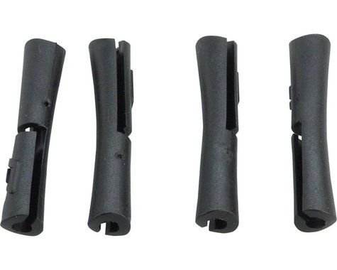

The problem I have had with those Jagwire ones is that they do not stay in place. Seems like the spiral ones would be better for that.
Also found these but not sure if they stay in place better:
