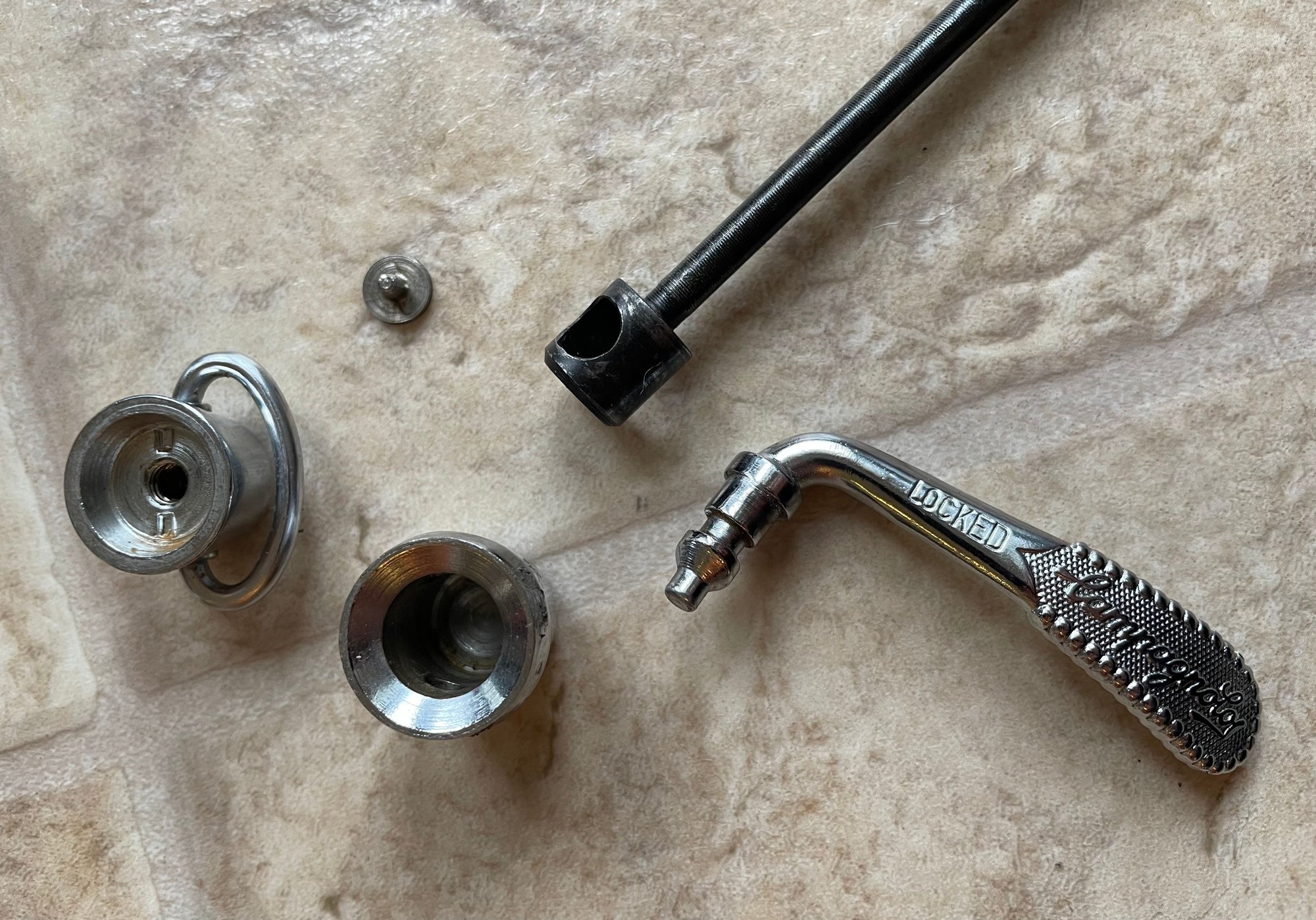

I took off a front wheel the other day and the front skewer came apart. Is there anyway to fix this?

Can we get some pics with the button facing up and the bottom of the lever and cap?
Is it the retaining button threads that are gone? It kind of looks like the lever has been bent due to much force applied to it. If any of the parts are stripped and you can't find them or make them is going to be difficult to fix. You may be able to replace these with an older record lever and cap that use a c-clip, or just a full curved QR.

To my eye nothing appears bent or broken, but clearly something’s not right.

Can't tell if the "screw" thing is threaded, and if it threads into the end of the cam(???).
Need more photos!
If so, you can just run it in to the assembled lever/cam using finger torque after applying blue or red LocTite to cleaned threads on the screw and inside of the cam.
Don't over-apply the Loctite as it will squeeze out and freeze up the lever/cam's free movement.
No way it will come apart if threads are extant (I'd use JB-Weld if the threads are stripped).
The assembly can not come apart while riding even if the screw were to fall out, and which would be most unlikely from the looks of it.
Note that with limited photographic examination I could be wrong about the "screw's" location and function, and that perhaps some sort of retaining ring might have gone missing from inside of the housing.

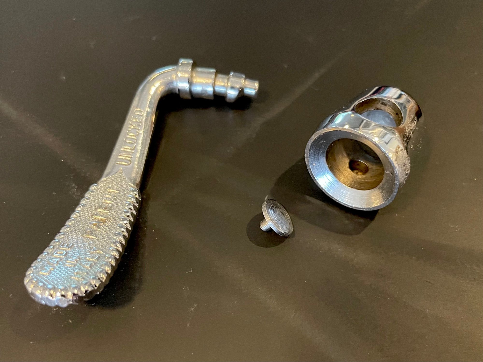

As far as I can decipher, the assembly on the right has to go inside the cap sitting to the left. But I can’t figure out how to make that work. The small pin/cap can’t be pushed in (it appears to hold the lever in so that it can’t pull out) once it’s inside the cap. If assemble outside the cap, the whole thing clearly can’t be inserted.

Perhaps also, the "screw" thing (or pin/cap as you've called it) might be placed on top of a spring washer inside of the cup, with the QR shaft block then installed in the cup, and with the cam then forced into the cup with the QR shaft end and/or the beveled cam thus overcoming the spring washer's tension.
The bevel on the cam, as well as the groove in the cam, supports the theory that the "screw" thing actually serves as a retaining peg that snaps into the cam groove by spring-washer tension upon assembly, as the cam is forced in to the assembled QR shaft block and cup.
I'm thinking this is more likely than the threaded-screw hypothesis, especially as I notice that the cam actually looks not to be drilled/tapped for any screw.

Did you not find a spring-washer anywhere (might have to fashion one)?

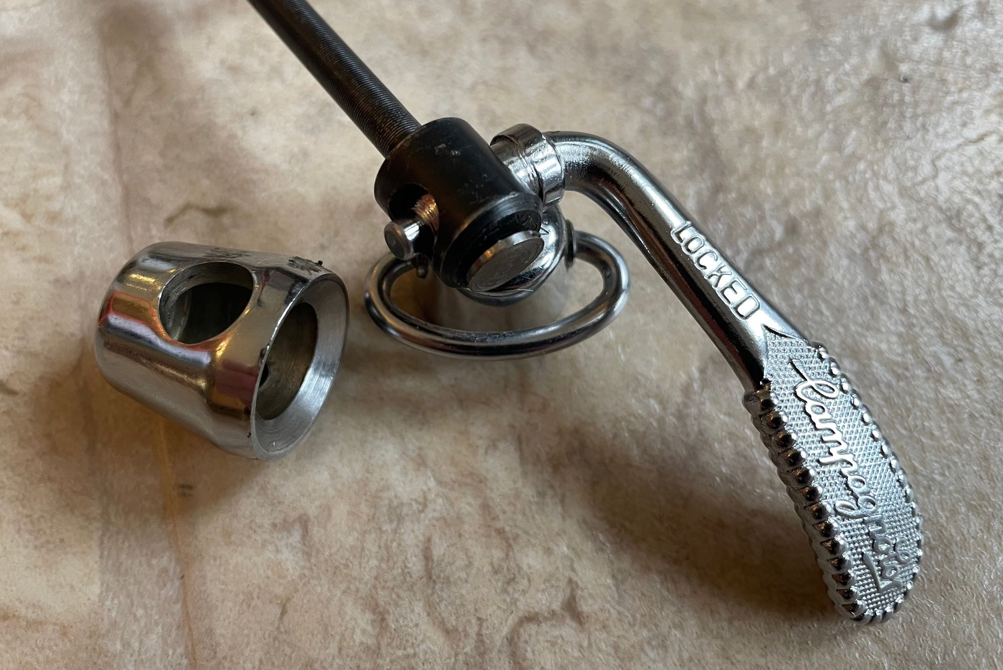

Can you disassemble the rear QR to compare them or might that be too risky- might have 2 that won't work?
I think @dddd is on to something with mention of a spring. I've seen breakdowns of lower level Campy skewers from the C-Record era and they have a spring in the QR lever body. Also, Campy Record 8 speed hub skewers have a spring in there. It looks like a regular skewer spring,

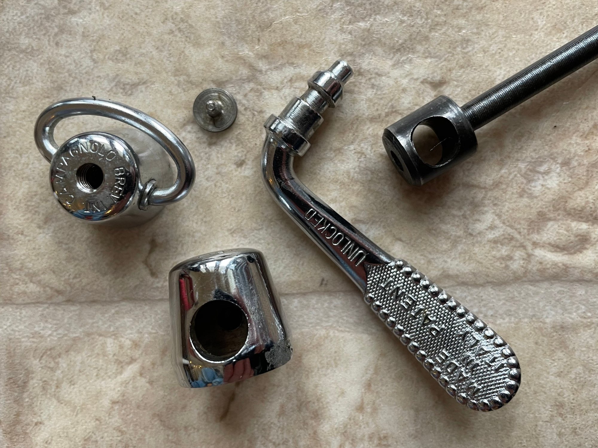

The drawings that show a spring, don't have the button, and don't have a groove in the middle of the cam (which the button fits into?)

Corsa Record, all for the sake of Styling they run off and get all fancy.
The reduced diameter of the lever eccentric has a groove no doubt to help retain the lever.
That part appears as if it might be slightly bent from overtightening by someone in the past.
The "pin disc", for lack of a better term- does the pin end look intact?
my hunch there is a small piece missing and or broken.
My assumption this fell apart on you and might have been kept together with the eccentric clamping force prior.
I would based upon the parts expect a ball bearing or pin to be spring loaded to engage the lever groove and keep it all together.

Thanks for ths pics. I have long wondered how those C-record skewers went together, that whether they were disassemblable.

There's gotta be a way!
Wish you could see if there's a spring behind the pin of the other, working skewer without complete disassembly.
