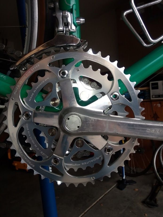

The 50.4 BCD with TA Cyclotouriste rings is definitely the most versatile. Made this for mrs non-fixie recently. Classic French touring setup:
Also nice, the Stronglight 99. Here in 49/32 guise:
SR made something similar in the Apex series. 50/30, I think:
Speaking of Apex, they made an 118 BCD Campy clone as well. I used it with a 36T inner ring and an NR transmission for L'Eroica in 2017.
For L'Eroica 2019 I rebuilt it with Simplex and a Stronglight crankset with a 37T inner ring, supplied by jonwvara:

+1 for SR Apex
Here's my preferred 47/34 compact for long rides, converted from the stock triple chainset on my 1980 Centurion Pro Tour
Used mostly in a 2x9/10 speed setup w/ Simplex Retrofriction downtube shifters, long cage Ultegra RD, "pinched" Cyclone FD, KMC chain, 12-27t cassette (or 13-29t with campy hubbed wheels)..
