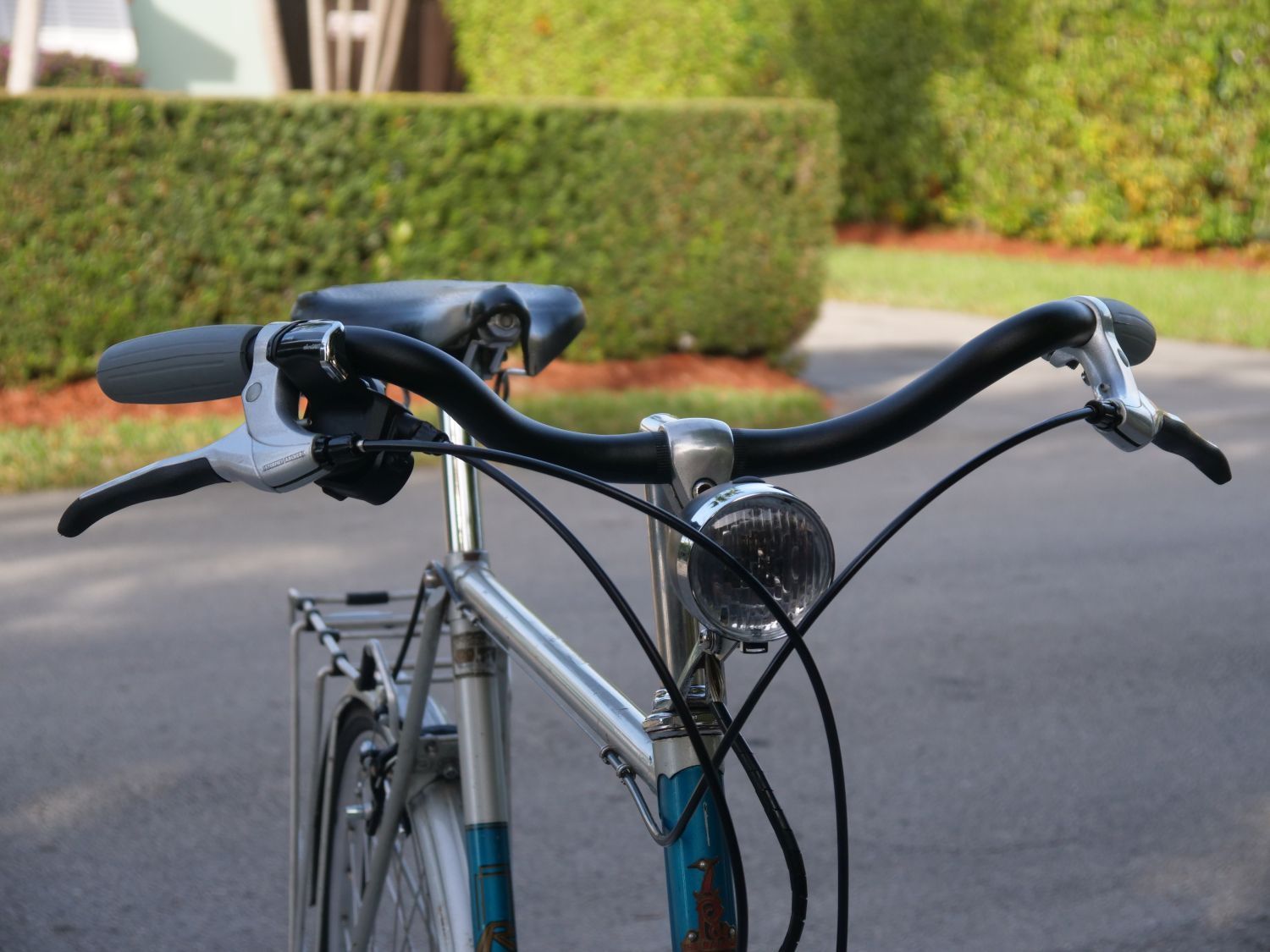

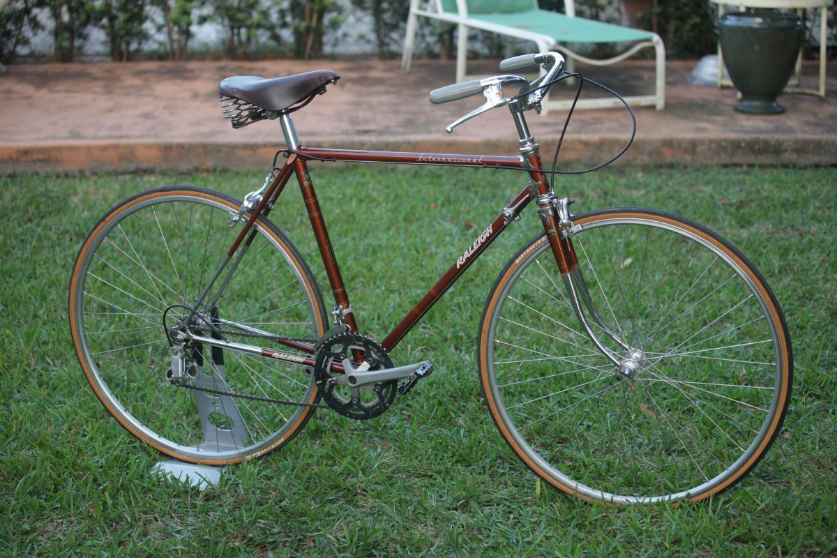

Pic's man, we need pic's, especially when you say Paramount.
The upright levers will also work fine with the centerpulls, they were set up that way on zillions of Schwinn Suburbans, Collegiate's and many, many others.
Here's Ms. merziac's latest acquisition set up just so.

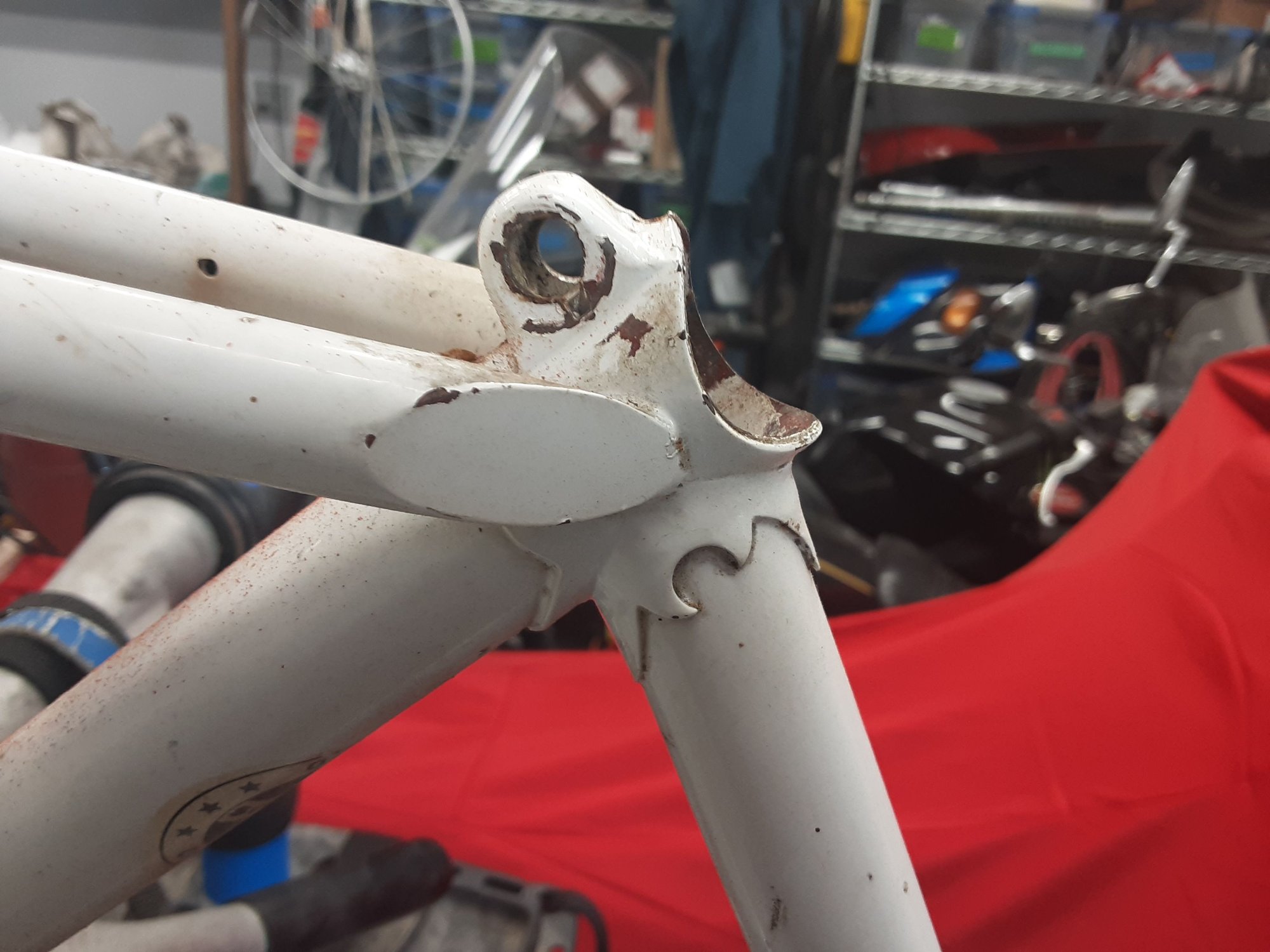

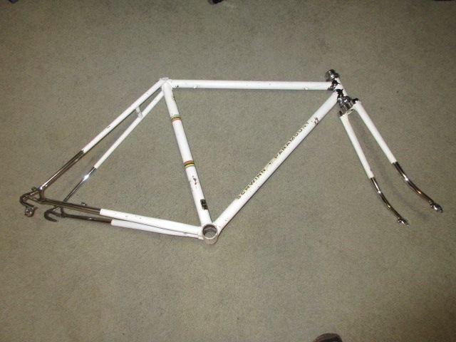

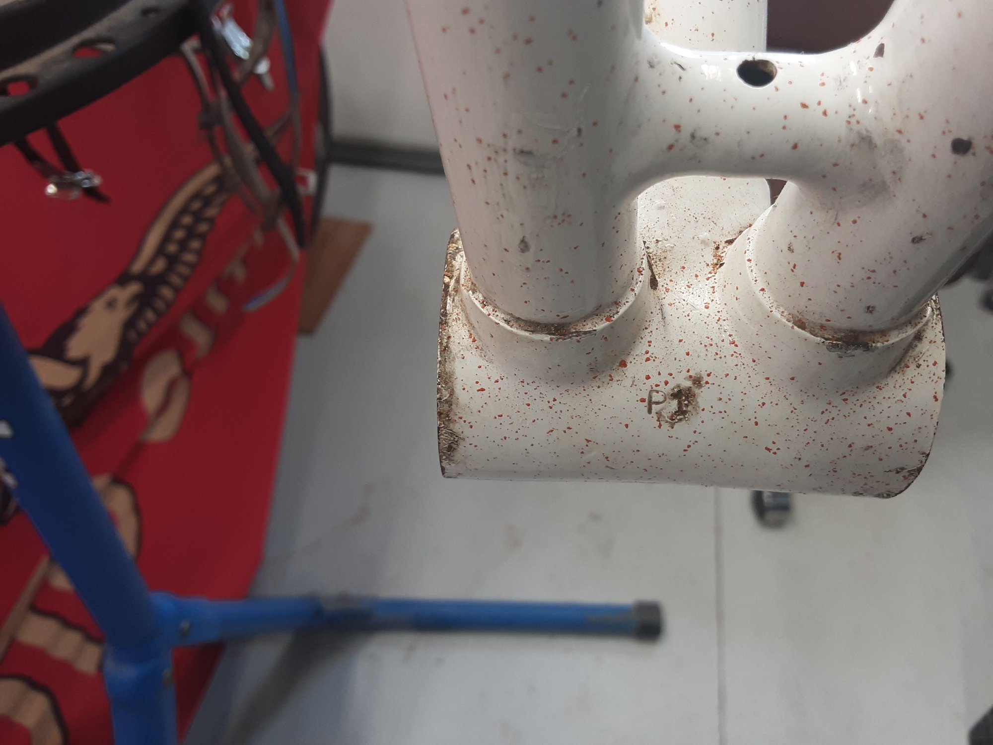

Someone demanded pics so here they are! Now for the questions, there is significant rust showing in places and there is over spray from a burst aerosol paint can, does anyone have suggestions on how to deal with these problems short of a repaint? I would love to send it out for a repaint but simply can't afford it at this time and would like to ride it some. The factory paint seems very thin and fragile. There is some pitting of the chrome on the lugs as well. I'm really looking for a direction to go on this frame. By the way I do have a complete set of decals!

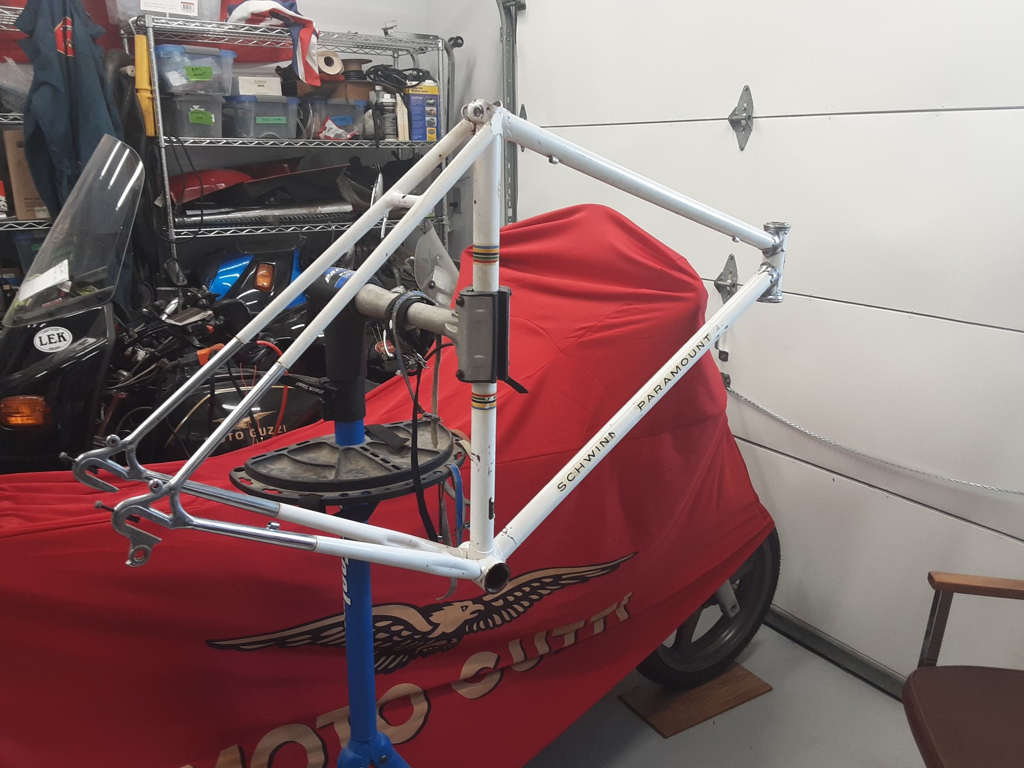

More pics!

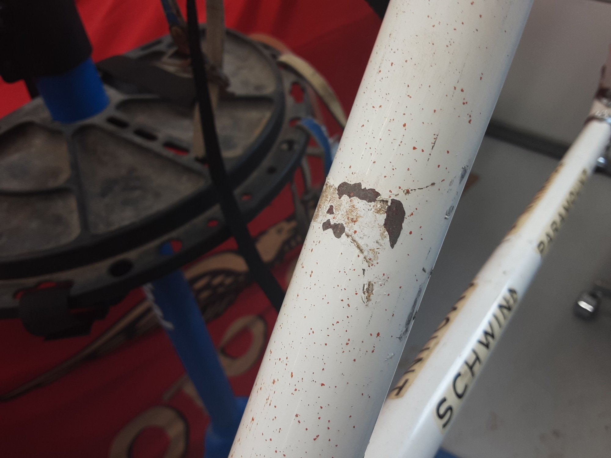

Looks more like red paint splatter than rust. Hit it with some fine microfinishing compound. Should come off. Polish with Meguiar's #7 and wax after that.

Kurt it's both, the sprinkles are orange paint that came from a ruptured can, entirely my fault. The rust is at the seat post lug and where components were clamped to the frame. I appreciate the comments about the paint and Meguiars. I suppose washing is my first effort just to remove crud.

That rust is not so bad that it is a cause for immediate concern, especially if you don't live next door to a body of salt water or are planning to leave the bike out in the rain. You can easily put a coat of paste wax over it and ride it as is for a few years if you wish.

Some of that may be Schwinn's red oxide primer showing through as well, nothing life threatening here. Whatever little is actual rust can probably be rubbed out. Any solvent will get the paint off the chrome, elbow grease and Meguiars should get it off the paint as Kurt said.
Yours looks almost identical to one of mine that will also be built up as an upright for a very good friend.

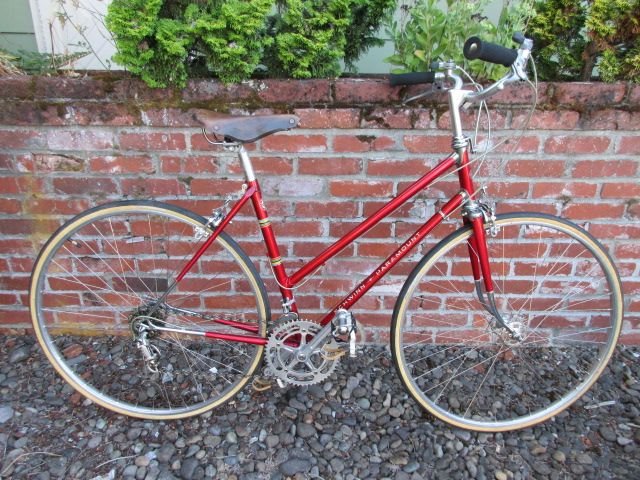

My 1968 Schwinn paramount tourist was set up with flat bars when it was purchased. I haven't rebuilt it yet. I prefer a drop bar build but I don't know if I want to do that to this bike. It just has so much integrity as it is that I may leave it as a townie. This is what the bike looked like when I bought it. I know that the original owner rode this bike set up this way for decades:

Pretty sure the geometry is the same on the Paramount Tourists. The only difference I can recall is that 3-speed Tourists (including the second-gen models) usually have a chainguard tab on the frame.
-Kurt
Now I'm wondering if the Paramount Tourist model has a different seat angle than the standard model. I thought it had longer chain stays but I don't remember. Years ago a repainted lots of them but not in the last 20 years.
Here is a picture of a light weight upright frame/bike I made for myself. It was a frame building class example. It has 71º angles. I have studied upright bicycle geometries and know that the classic Dutch bicycle has very shallow angles for their very upright positions. Behind my bike is one of my fitting bikes and it is easy to see how the saddle wants to be further back when setting up to use upright bars. It is obvious when riding one trying to find the best position. Behind my fitting bike on the wall is my frame design fixture. By placing the saddle/handlebar position found on the fitting bike on the design fixture, one can create the best possible geometry to match the chosen seat post and stem. Drop bars rotate the body (and your seat) forward (requiring a more upright seat angle) while upright bars rotate your body back (relaxing the seat angle). In a perfect world, the frame's geometry matches the rider's body position whatever kind of handlebars are chosen.
