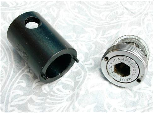

I never liked the self extractors on the C-Record. I removed mine (using a Campy tool made for the two little holes). They have reverse threads. I also had to buy a reverse threaded Campy puller to remove the crank arms, Those are difficult (expensive) to find today. I then used the crank bolts that you find on the 10 speed cranks.
Here's an image of the self extractor (removed) and the tool. (from VeloBase.com)

The bolts are the ones gearbasher provided a photo of- go figure there is a specialty Campy spanner tool for this job.

Campy made a tool to hold the 7 mm allen, so you can put a 15 mm box end on it to turn out the crank bolt. I've often seen them combined with Campy's "peanut butter" wrench. I never used one.
