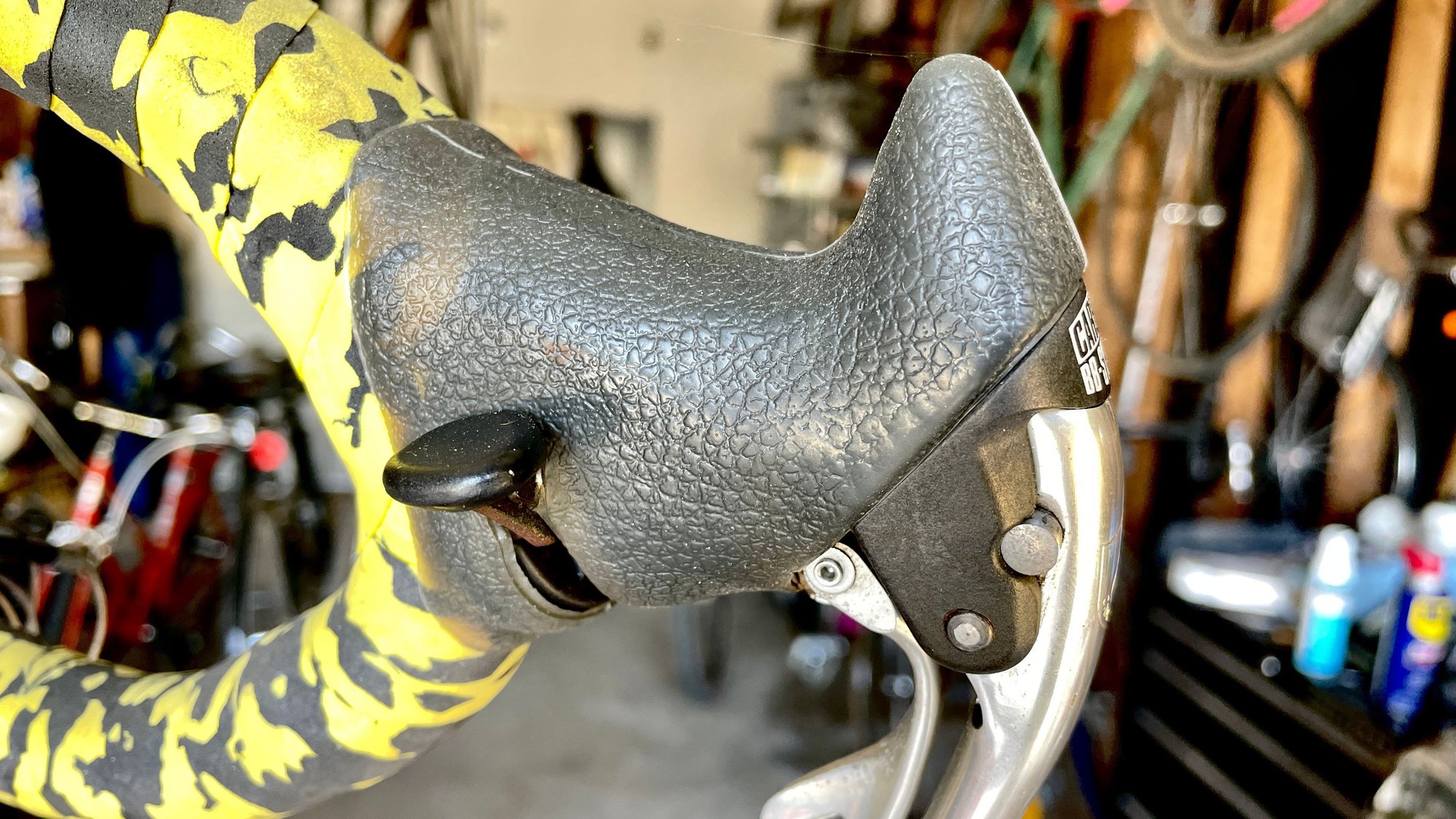

Hi all,
Have only ever removed/replaced non-aero or ergo levers on a road bike & these Campy Record 8-speed brifters are new enough for me not to be knowledge about, but old enough for me to worry about just yanking off the hoods in fear of possible ripping of the rubber & lack of option to replace if that was to happen.
Any suggestions for how I need to proceed for removal, & options for replacement hoods should the worst happen?
Thanks for any help.

I need to know how to get the levers off. I only know how to do it on the old style of levers that has the band with the nut thy you access when you open the lever & insert a hex wrench. I don’t see that capability on these.

I have the same levers and I know I haven’t touched them since I installed them, but I’m quite sure they installed with a hex just like any other lever. Undo the cable, depress the lever and look inside.

Pull the cover back gently from the top of the lever at the front, don't have to move it much. The bolt, if I remember on those right, is a 5mm allen, the ones on my Sachs were shallow so don't use a ball end. You should be able to notice there's a slight impression or divot in the top of the lever, that's the spot the bolt sits in, just slide the allen under the hood into that spot and wiggle it a little till it seats into the bolt and unscrew as normal. Once loose you will of course need to slightly pull the hood away from the tape, it won't want to stay pulled away unless you pull it around from the thumb lever but considering the age of the rubber I wouldn't do that. Also leave the wrench in until you have the lever all the way off, you may find depending on the curve of the bar, that you have to loosen more and as you will discover finding that bolt will be annoying. Not a hard job just requires a careful touch to avoid ripping anything.

Hex key (long and I believe it's 5mm) the bolt is accessed from the front on the outboard side. It can be done without removing the hoods. Just slip the Allen under the hood. See parts breakdown photo for location. Just north of where the "11" is pointing.

Russ Roth & gearbasher, I think this is exactly what I needed to hear & see. Thank you!

Still available. Look for EC-RE500
https://www.google.com/search?q=EC-R...hrome&ie=UTF-8
One piece of advice: when reinstalling them, don't make them crazy tight. Campy has a torque recommendation that I can't recall, only because when I used it, I cracked two bodies.

I found my torque chart. Campy recommends 10 N.m. (88.5 in/lbs.). Too much in my opinion. Like I said, I cracked two bodies using those specs.

Would agree, especially on carbon bars which are typically only rated to 5 Nm though most bars I've used have texturing to keep them from moving in that area so lower than recommended should be fine. For aluminum I tighten them till they don't move without a lot of effort since most people crank on them when sprinting or out of saddle climbing but I test as I go to avoid overtightening.
