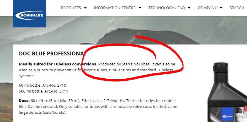

I mentioned it in the OP's other, hissyfit thread, but it's worth noting here. The highly regarded sealant? Uh, yeah -
WhyFi is online now
