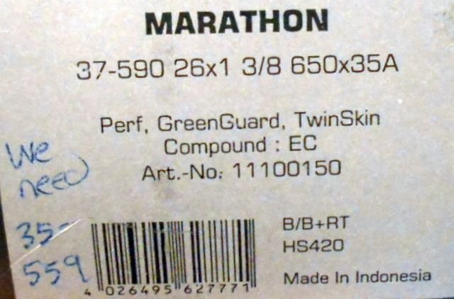

26" tire mistake
yes i know it has been covered here but i got burned for $100 on a couple of orders before the mistake was realized.
so that maybe someone else might get burned i am posting this friendly reminder.
back in the day when i walked into the payless Hardware Store around 1933, you could buy a 26 x 1 3/8" tire and it would fit a 26" rim.
not any more.
so be careful out there1
you need to realize that you want a number called 559, and not a number called 590.
one is for a 26" rim and the other i suppose is for a 650B rim.
i made the same mistake on a schwalbe marathon and a continental gatorskin
mistake number 2. this tire made it from London to the us in about 3 days with free shipping so i do not have the heart to return it. i will donate it to the local bike shop>

here is another chart from performance (scroll down)>
https://www.performancebike.com/cont...rgqhe?v=326281
here is what the label will look like if you screw up like this poor slob>

The 559 is pretty common for MTBs, and most modern bikes.
The other sizes 26x1 3/8 is for some more vintage bikes, old Raleighs, etc. I really think an online vendor should have some really big TEXT to verify a buyer knows what they are buying when they get one of these.
Several sizes have similar issues. I use 20" (451) on one of my bikes, and know to specifically look for that size.

Although it’s better to go by the ETRTO or ISO number when it comes to tire size, another way to tell the difference is by the fractional number. If the fraction of an inch is fractional, it is usually 590mm ETRTO tire while a decimal is the 559mm tire. That’s not perfect, however since there is another 26” “size” that is a 597mm rim. Those are Schwinn S sizes. There is also a 571mm tire that is known as a 26” tire (650C) and a 584mm tire which is a 650B. Your 590mm tire is a really odd duck in that it is an English 26” tire.

Nominal 26" tires are a hot mess. Ignore everything except the ETRTO tire size designation, which will look something like this: "38-559" where the first number is the nominal width of the tire in millimeters and the second number the bead seat diameter in millimeters. Rims can accommodate a range of widths, so the first number only matters to determine if your frame has sufficient clearance for the tire. Anything narrower than the current tire will work; anything wider, you'd better check how much clearance you have. The second number is the important one, in that it must match your current tire, or the new tire won't even mount on your rim.
N.B. 559mm is the common bead seat diameter for "mountain bikes." 571mm is sometimes referred to as "650C" and may be found on road bikes for small riders. 584mm is "650B" or "27.5" and is becoming a popular choice for gravel bikes and people looking to run wider tires on road bikes. 590mm is "650A" or "26 x 1-3/8" and is commonly found on British and Japanese 3-speeds.
I've also found it to be rather common on older department store "10 speeds"

The way Schwalbe uses inches to describe their tires is atrocious.
My understanding is that is how to know the correct tire for a classic English bike. 26 X 1 /3/8" is different from 26 X 1.375. The confirmation is the 37 X 590. Same for Schwinn with 26 S6 rims 26 X 1 3/8 but its 37 X 597

Originally Posted by cjenrick View Post
i guess i could always buy a 650B bike,
you can never own too many bicycles, right?
You bought 26x1 3/8, or 590 ISO.
650B is 584 ISO (usually marked 27.5").
Your tires won't fit.
650A is 590 ISO, but rarely used with that designation.
You could, of course, rebuild wheels with obsolete rim sizes.
But, if you want to used those tires, hunt for a vintage 3 speed, Raleigh, Robin Hood, etc. I think I also have a Gitane tandem with 26x1 3/8 wheels.
