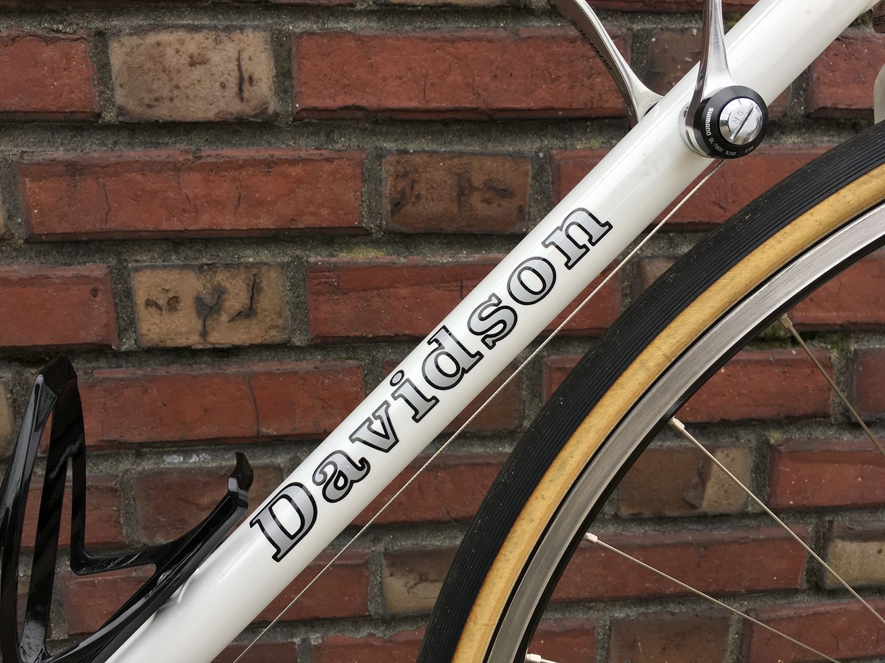

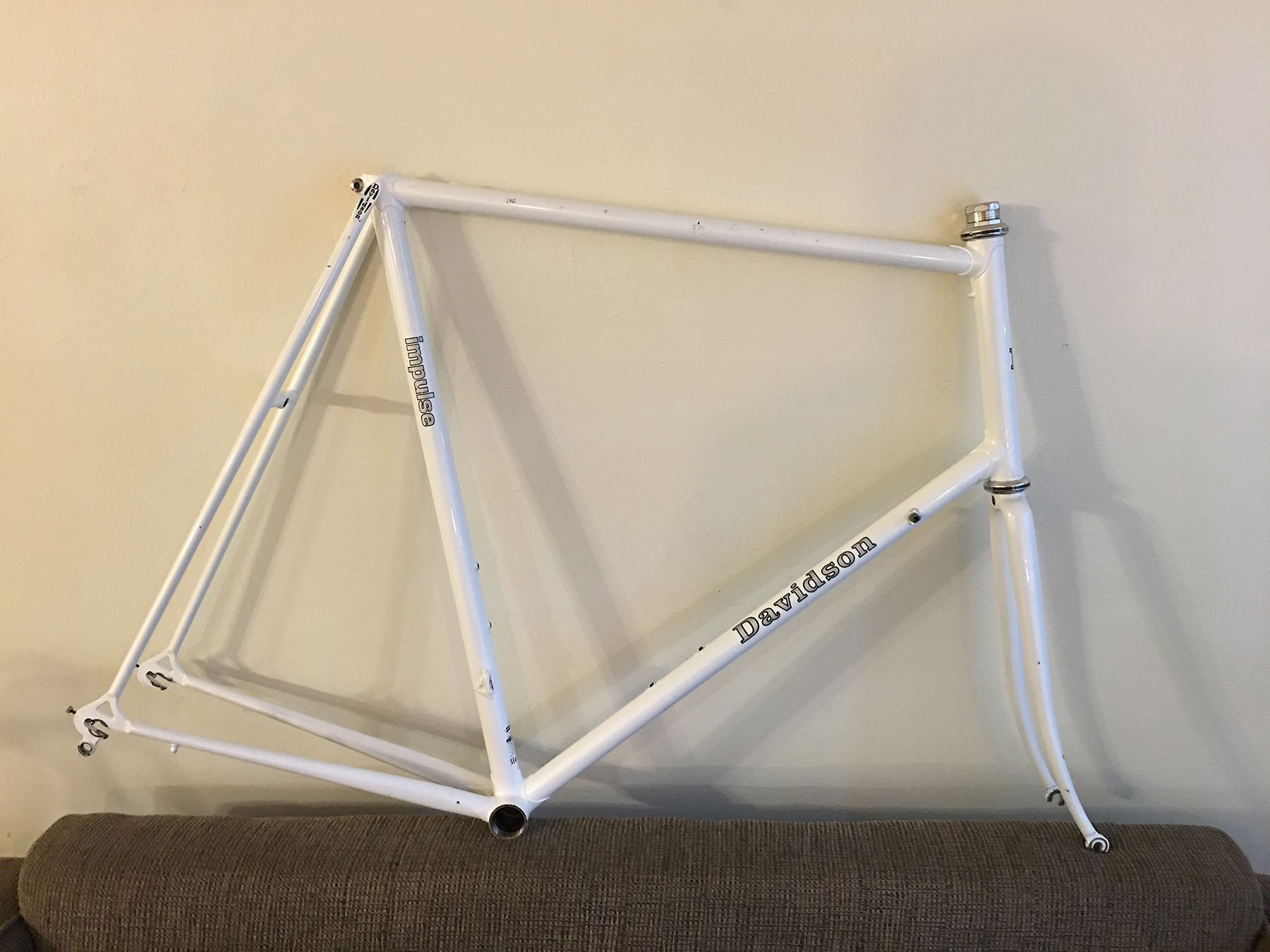

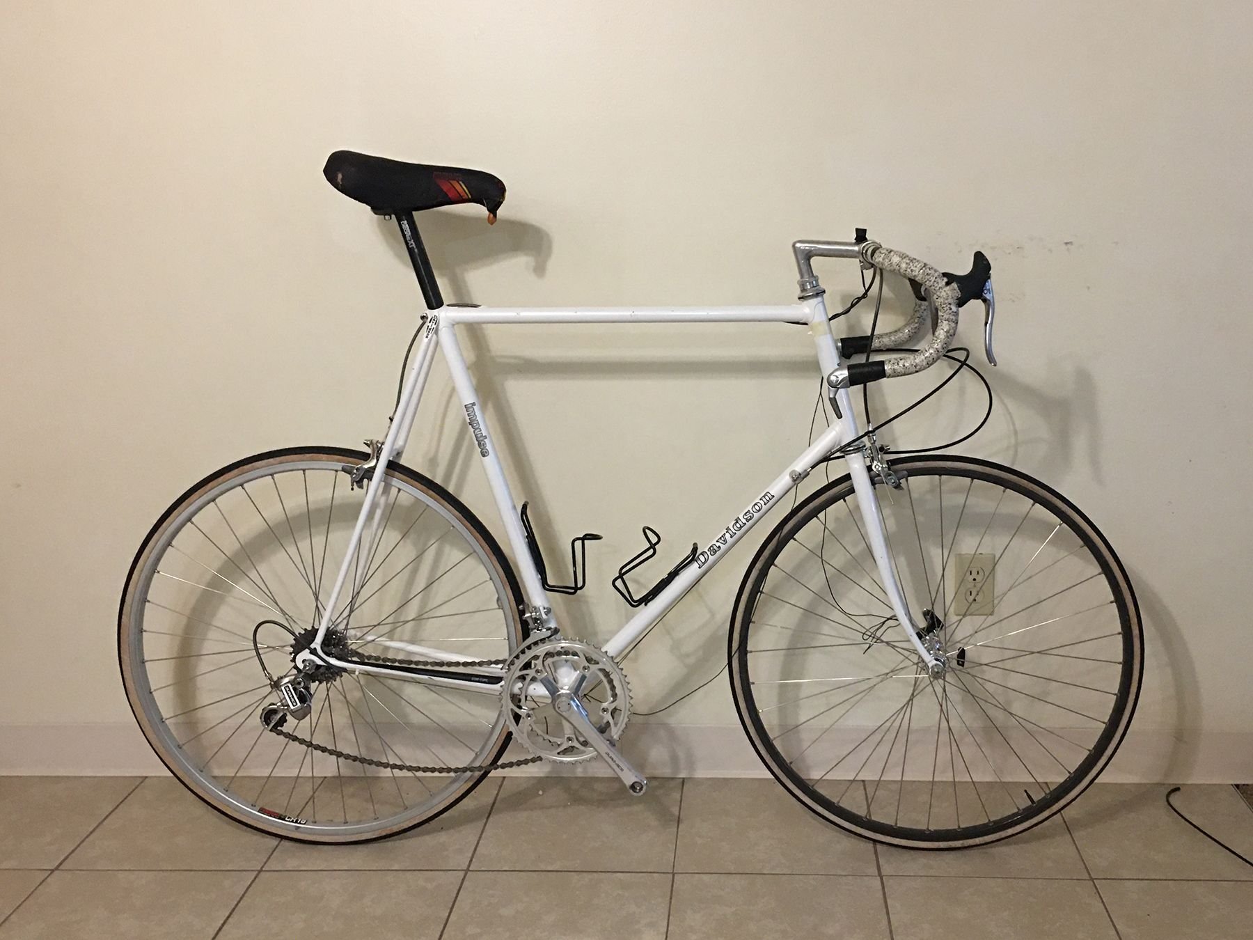

Seller photo:
Looks great, doesn't it? Sure, we have junked bottle cages, a roasted saddle at a bad angle, electrical tape that's a bit too liberally applied, a possible replacement hood incorrectly installed on the right Dura-Ace brake lever, and a flipping Sun CR18 replacement rim laced to a 7400 rear hub. Between that, the method of measuring, and the ad copy, I could tell the seller likely wasn't the original owner (which is fine, happens all the time) or much into bikes. He did insist he would seek out advice in how to package it correctly, and it came...embalmed.

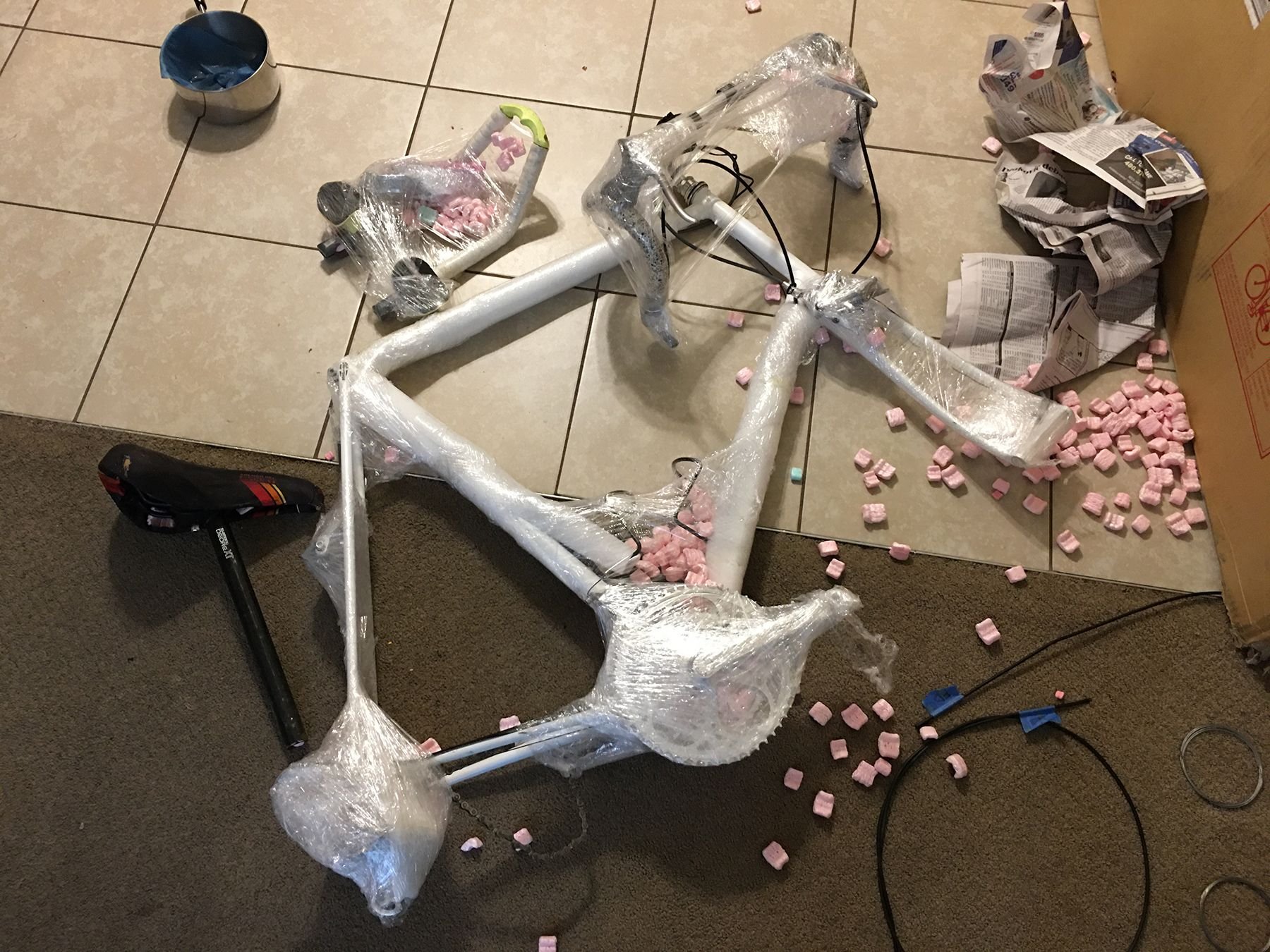

If you like miles of plastic wrap and a yard of packing peanuts, he's your guy.

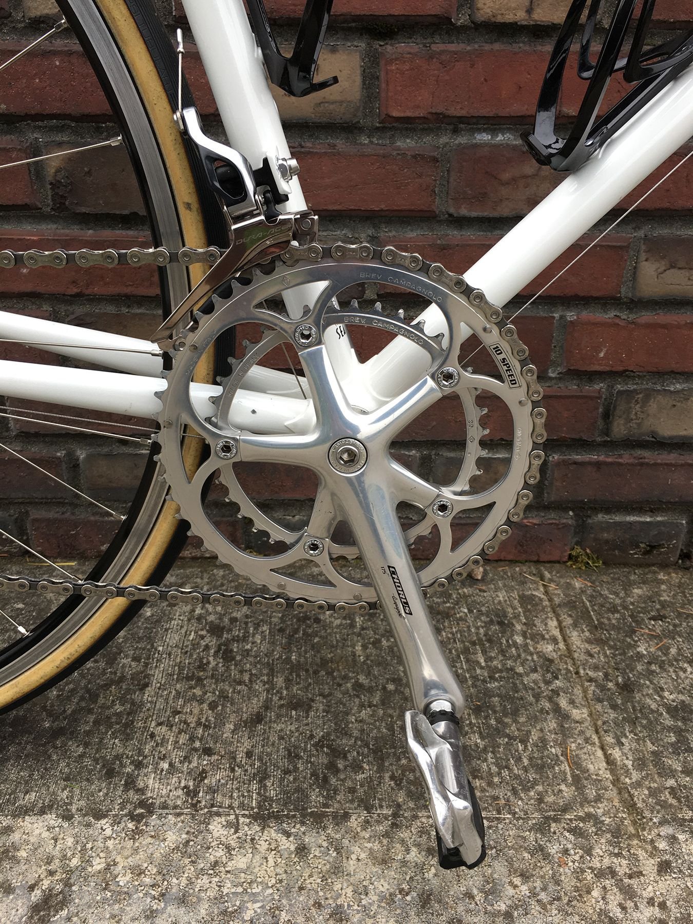

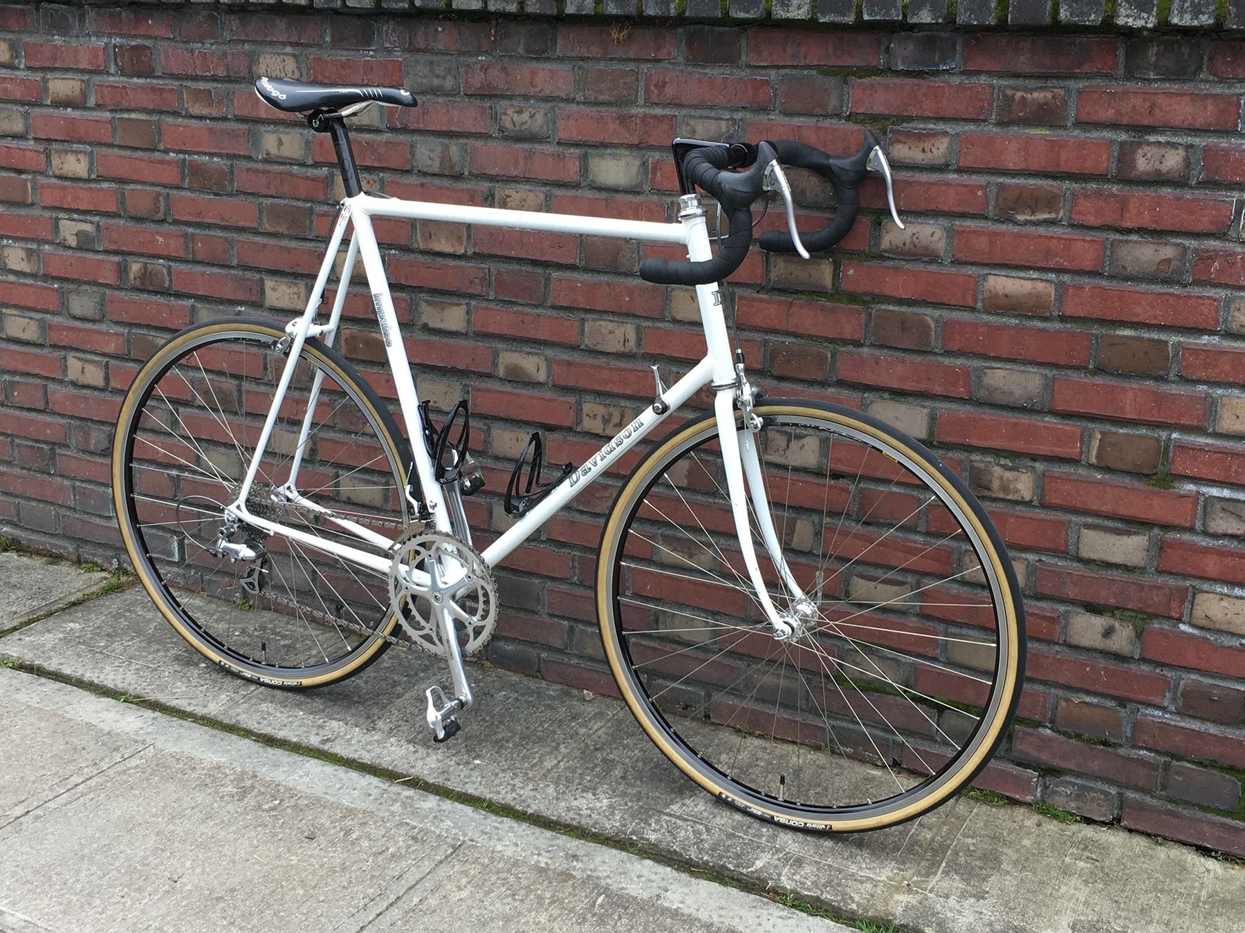

Loosely assembled, now with more exposed wires (ran along the bottom of the down tube and the fork blade).

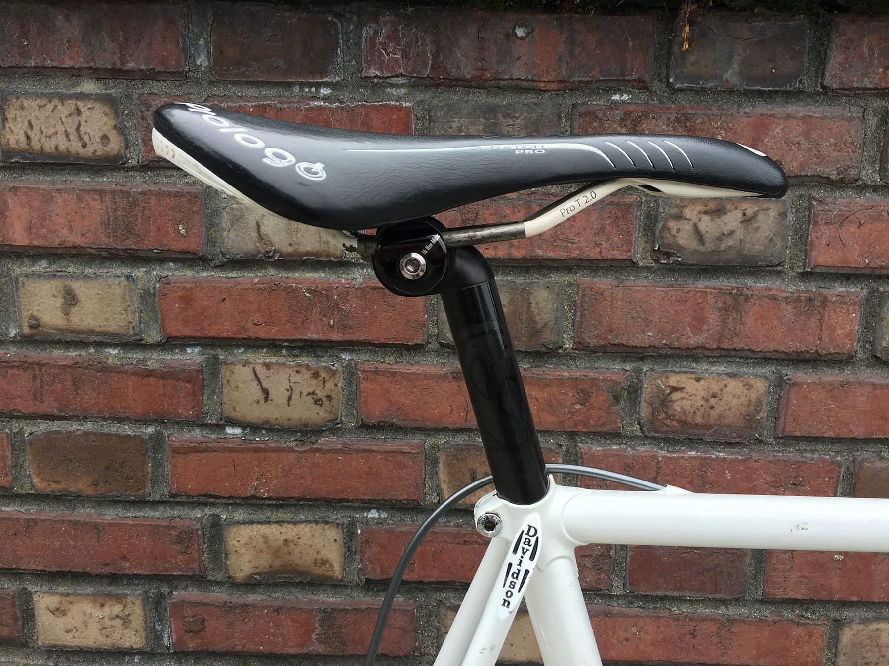

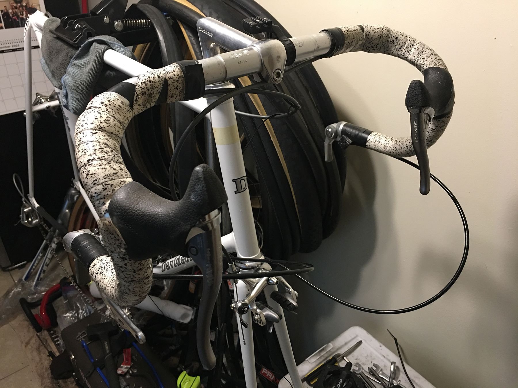

Packing bikes can be tricky, if not difficult. Everything protrudes and is subject to getting bent or broken. If not a bike enthusiast or an hour or so's worth of research and planning of how to pack it optimally, it's even more difficult. The frame being intact was the important part for me. As I would be inexperienced with packing things unfamiliar to me, we had my bike. And honestly, there was a lot of good in it. Load locking it in the super huge Specialized box would have helped, but there was a lot of honest effort, and the plastic helped any damage from abrasion. As with anything, there are bumps along the way, and we had a few here. In all, very minor and all correctable. The fork was undamaged and nothing came out of alignment.
Levers were turned in a bit oddly, but hey they're protected. That loose brake lever hood is actually the original 7402 hood! It's been stretched from sitting like that for so long--more evidence this bike has been unused for a long time in addition to other things, which I'll get to below.

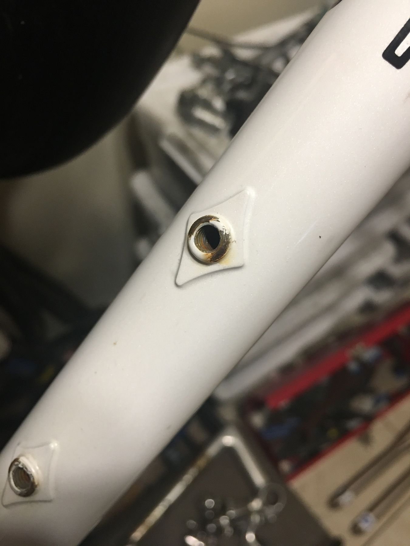

This bent somehow. Maybe in packing or moving it around beforehand, or shipping. It's a dollar and I've already cut and removed it, and have a replacement ready to install.

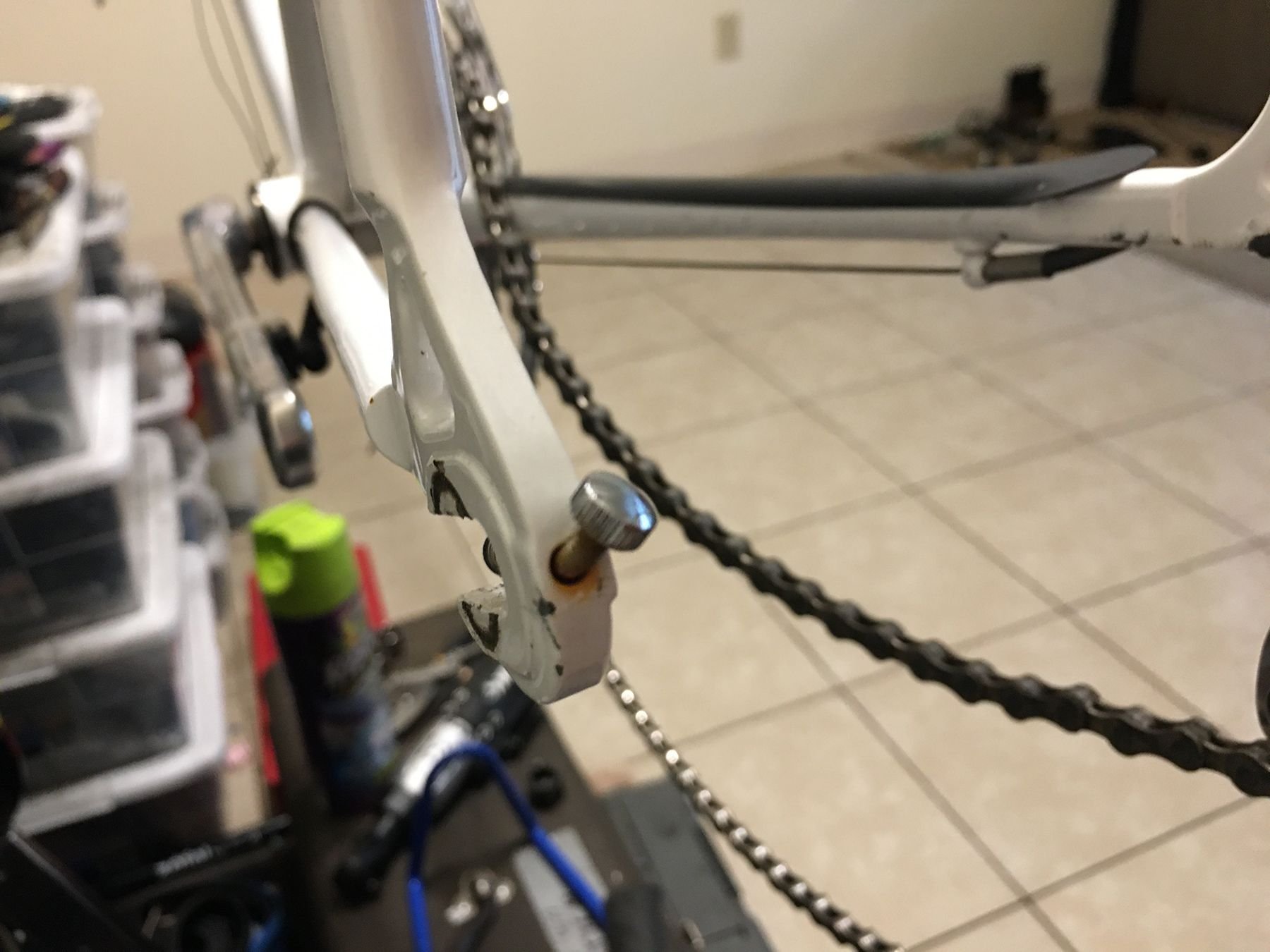

The rear dropout was closed slightly, cracking the paint. It took little effort to open it back up to be able to slide a wheel in. The paint crack is barely visible. Likely got bumped in transport somewhere.

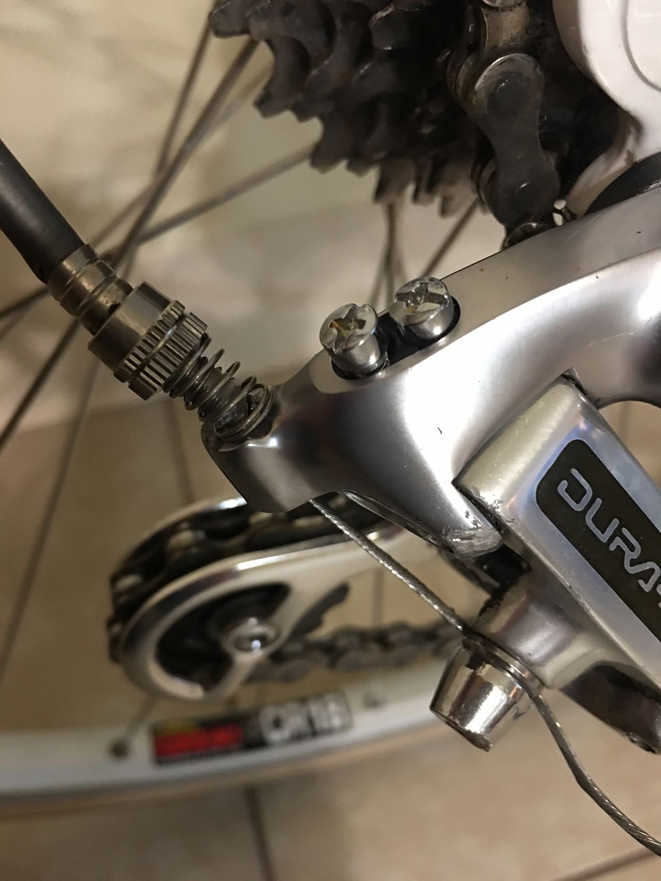

The 7400 "8-speed" rear derailleur is, outside of the parallelogram, nearly frozen in its pivots. Baffling. It took a lot of effort just to spin the anchor bolt to remove it when addressing the dropout situation. For something that looks this good, it's in a bad way, unfortunately. The below photo shows what happens when you're so distracted with how difficult it is to mount a derailleur that you forget the cable and housing are on the inside of the rear triangle and you bend/break the very pretty barrel adjuster. Sigh...

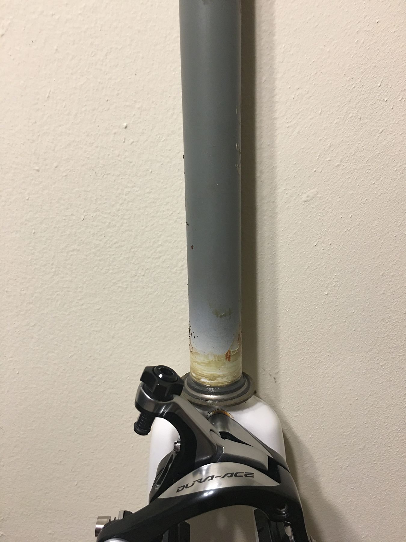

This is a 110mm long, full-meal-deal 225mm tall Technomic stem absolutely buried in the steerer. It should clean up pretty well I think. Lots of nearly solid grease making things look concerning.

Yup!, I always ask people that ship bikes to me to remove rear dropout adjuster screws as they wil always get bent up, during shipping and maybe even damage the rear dropouts.

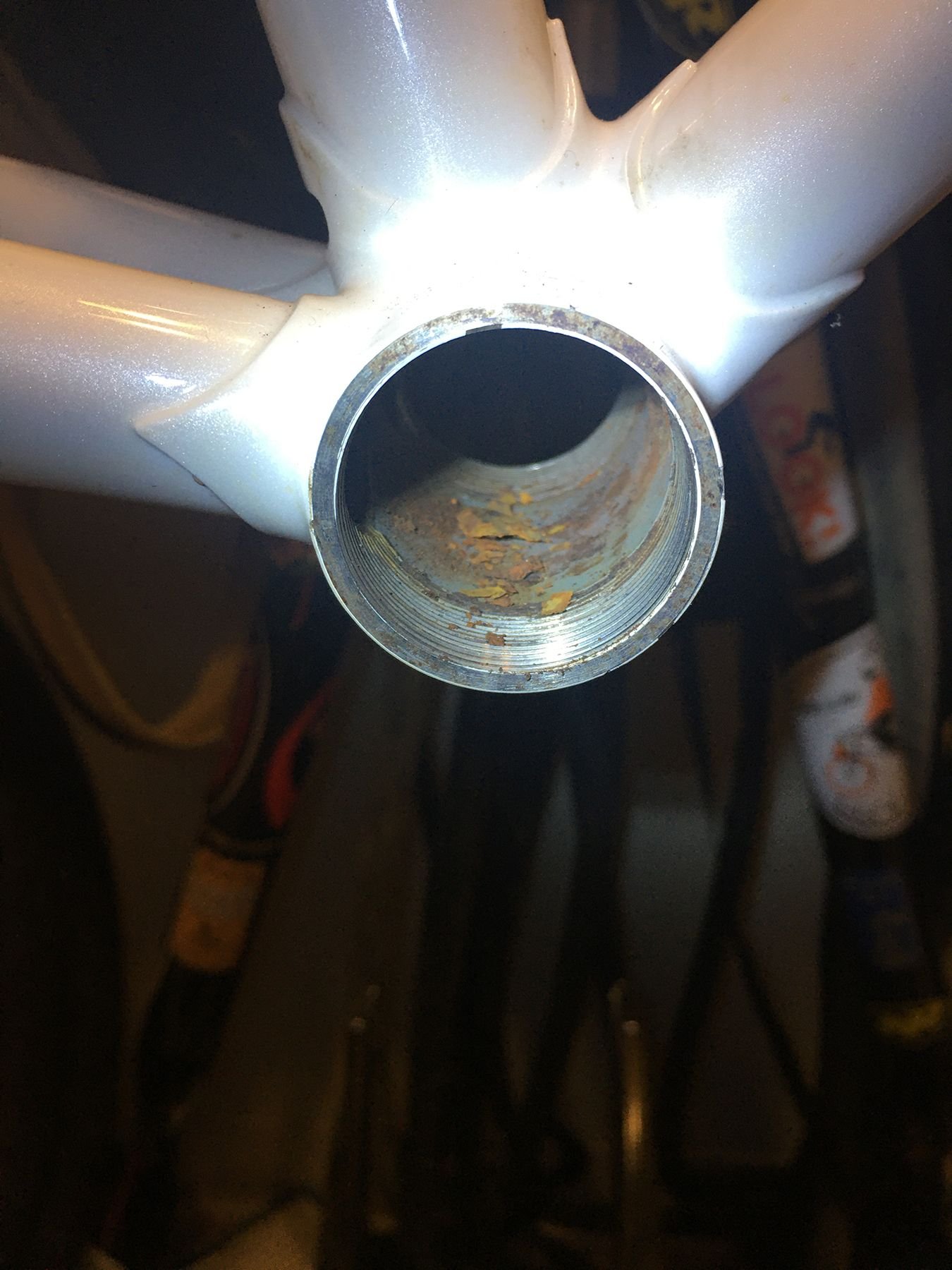

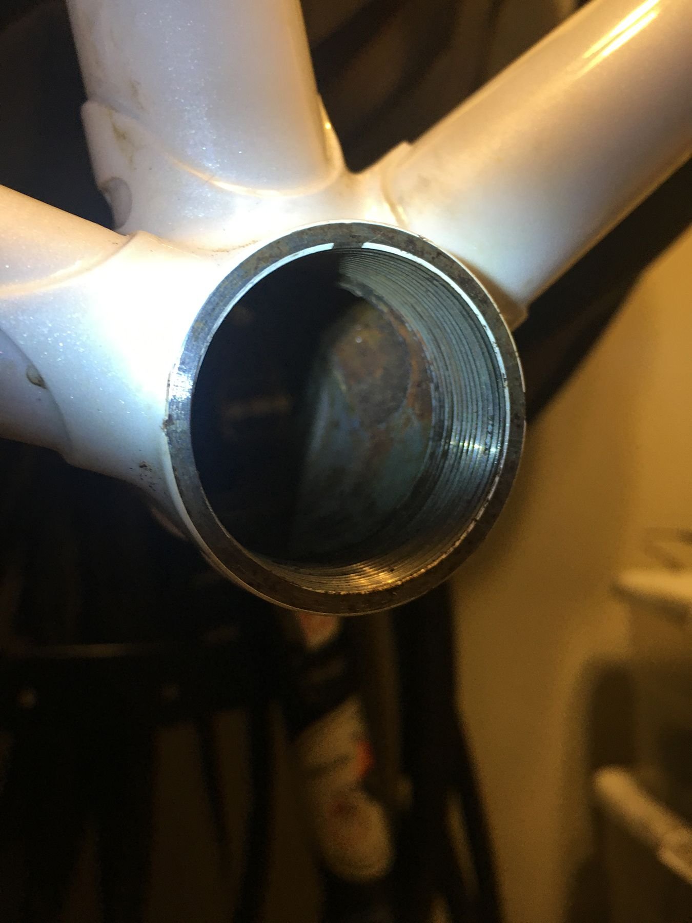

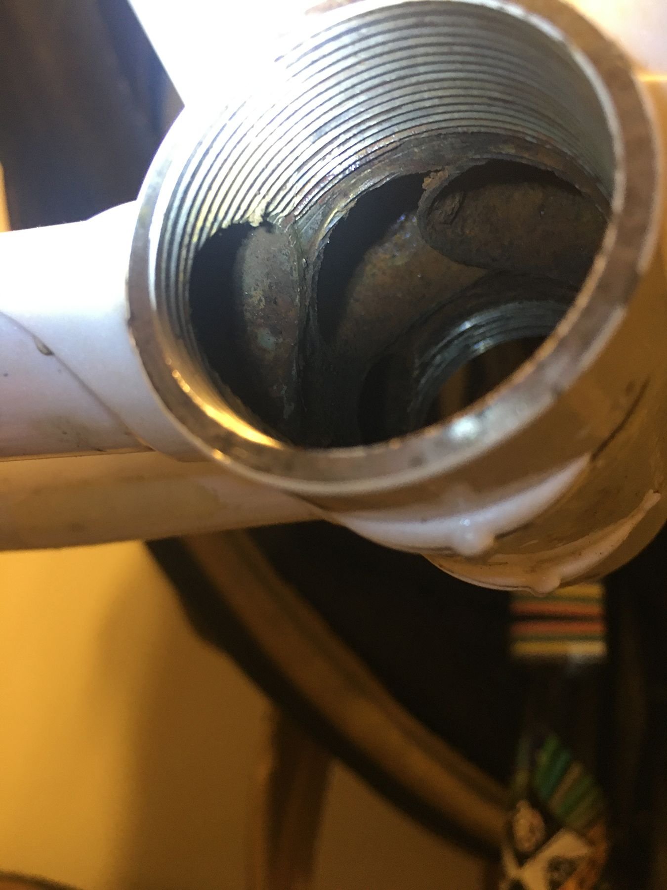

And to follow up with my stating that disassembly of the bike was a good idea, it was. A very good idea. There was considerable petrified grease and really gummed up threads all over the bike. I have had that before, but usually on bikes that looked in rougher shape. This bike spent it's last stint in the Phoenix area for however long, so anything resembling rust or gummed up stuff seems out of place. Still, the bottle cage bolt threads had slight rust on them, which I at the time thought might portend other less than stellar findings.
Thankfully, everything that could unscrew from the frame actually did so without trouble. The BB threads were a dream to work with as, once I broke the cups loose, they spun out by hand as easily as they could. The plastic dust shield/tube for the BB spindle inside the BB shell was practically sealed against the shell itself. Lots of smelly old grease, and I had to use a small screwdriver to gently pry and unstick the shield from the shell, then push it out with a seat post as the diameter matched the shield well enough to push it out without much more hassle.

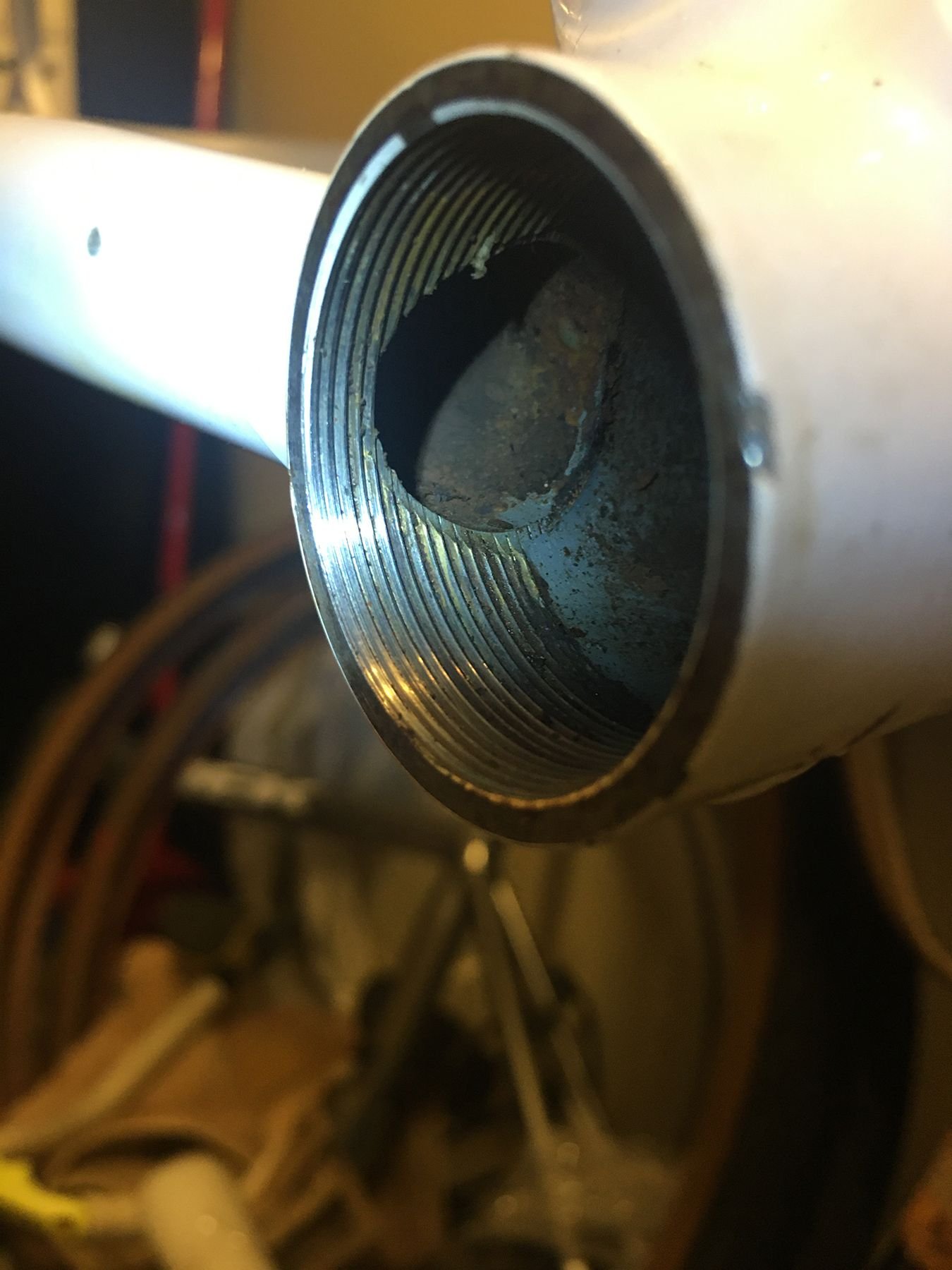

Well...you'd think an Arizona bike would have everything pretty dry inside but nope! The shell was showered with a lot of wet dirt and some rust bits. I did a bit of shop towel trying in the down tube, seat tube and chain stays, using the small screwdriver to lightly scrape any clinging dirt and/or rust from the inside of the tubes to get an honest gauge of the condition. Thanks to the dirt having collected and stopped at the base of their tubes, at the BB shell, that was where the corrosion was on the tube. Looking further into the tubes, it got a lot better and quite quickly. The base of the BB shell is in great shape. My conclusion is that I've seen considerably worse, and that this is in the range of acceptable to me, albeit on the more interesting end of it. The steerer was also somehow a touch wet when I took the fork out an hour ago (the bike disassembly was last night). And BTW, the 7400 headset was heavily indexed. Of course. I'll have to inspect it to see if that's salvageable.
So in the interest of some disclosure, here are some (top notch, lol) photos. Nothing I found will deter me from riding the bike or loving it less. Steel oxidizes, and I found plenty of evidence that gives me confidence in the frame. But seriously, people, take care of your bikes!!
The harbinger:
This was after a lot of cleaning and brushing away. More orange-colored friends! Also, look at that beautiful paint!
Mostly cleaned up BB shell. Looks good.
You can see the chain stay corrosion concentrated at the BB shell, but within about 10mm, the tubes are grey.
Blurry look at the down tube innards. Some texturing due to dirt collection at the BB shell, but it cleans up quickly enough.
The base of the seat tube seemed to get the worst of it. Probably a good bit of stuff from the top of the pre-mitered downtube that was making a roof over the BB shell. Also, as you can see, the BB shell threads are in really good shape.
The harbinger:
The harbinger:

It turns out that the change from the bigger black wall 28s and Dura-Ace 9000 brake calipers was the most perfect thing that could have happened to the build and overall composition. The gloss black elements--seatpost, stem, bars, bottle cages, rim beds (Open Pros), and front derailleur--were playing very nicely off the white paint, and the polished silver was looking great, but the aesthetic levity (and color) that the tan wall Vittorias added was the key. A lithe, tall, spaced-out 66cm frame now has the whole wheel assembly to match. Wonderful!
Final weight: 22.1 lbs / 10.05 kg with bottle cages and pedals. After this photo, I dropped the stem height 1/4" since on the very brief test ride, I wanted a little more weight over the front to tone down the steering before that evening's ride to Bike Works for volunteering. This lunch time photo shoot and subsequent 1 mile test ride was all I got before riding 18 or so miles round trip that evening, through the city and up and down steep hills. As always, a smart move.
The Bontrager carbon seatpost (one can find lighter carbon and aluminum examples, but 232g is more than fine) and this particular Prologo saddle were a great comfort aid as I tacked city streets with 25mm tires, on a road/race frame. The bars, at 42cm CTC, are technically my preferred width, but the classic drop profile and lever position meant the recess at the base of my palms was displaced outwardly, thus giving me an effective 44cm bar or so. Out of saddle efforts, especially with gloves on (hands can slip around in them slightly), were not the most natural; and in my experience, that fogs my ability to get a full and/or true idea of the characteristics of the rest of the frame/bike. Thankfully, I had dialed in the saddle position (per my measurements I've had for a while now) and my trusty (and timeless) q-factor Chorus cranks were on the bike.
As for the ride, it didn't take long for the Impulse to live up to its name. Yes, 25mm (vs 42mm) tires do impart an urgency to the movement of the bike, as does the tight wheelbase, but where as my very good Trek 1.5 frameset (when built) gives a responsive but stable ride characteristic, the Impulse, well, instigates by its very nature. The steering is nuts. Fast. Light. Ready to go wherever. NOW. Secondary steering happens easily with the simple weighting of one set of sit bones or the other. Load up the chassis either in the saddle or out, and feel it coil and spring back. It wants to go. Extremely enthusiastic, and so much so that it goads me into just sending it into traffic. Like the feeling you get when gearing up to overtake someone in a car on a two-lane road (before an oncoming car appears), this is that when asking/encouraging you to put the power down and shoot a gap, or just hammer it down a hill or along a flat or punch up a short hill out of the saddle. It's a bad influence, but in a good way.
Like my former 64cm Impulse, this frameset will take any power you put down, BUT! will not murder you for such capability. It never feels harsh. My 65cm Medici Pro Strada was a jackhammer, and only 25g heavier. This is the magic of the Impulse and/or a properly designed and built frame. I think the 64cm Impulse I had was a little punchier, but that's what smaller frames feel like compared to bigger ones, and this 66'er is no slouch. A bumpy set of streets over the course of a ride will fatigue the body more quickly (than a bike with larger tires), as will below-40° temperatures, which is to be expected. Thus, I will test how it does over a 24 mile loop I've done.
Looks even better in real life than in these photos, but isn't that true for many bikes?
I was able to get the right side brake lever hood to shrink back enough to be plenty useable (and stay in place enough). Nothing beats Dura-Ace 7402 brake levers for beauty and feel, for me. The road rash will always be sad to see, but they feel as wonderful as before to use.
The only short reach calipers I had on hand were these lovely 6600-era Ultegra calipers along with some single-piece (but fully adjustable!) pads. Their particular sheen actually matched the other silver components' sheen very well. But for chuckles, the "cheap" pads did pretty well! Still, this isn't the king 7800 Dura-Ace / Kool Stop setup, but I have remedied that!
The 9000-era Dura-Ace front derailleur adds immediacy to big ring upshifting, which is right in character with the frame. Its gloss black and overall design tie with the other gloss black elements, so it is staying. It's also a ridiculously light front derailleur. I don't know how they do it.
And as for the crankset, a 50/34T arrangement is total propaganda / ego stroking if you want to ride in the big ring when at cruising speed. This, compared to the traditional 53/39T combo. Working the 53T up front means running up the cassette in the back a bit and hoping you're not stressing the rear derailleur.
Thankfully there is enough chain for this 7800 unit to work with, and man is it so good to be back with my favorite silver derailleur. Others do a great job as well, but none are 7800s. It was also operating over my favorite cassette range, 11-28t, and that is also something to get used to after having a 34-32t low combo. I have to slowly re-harden up..

We have a few detail shots to show. Just the usual from me here...
I must say, the graphics are in much better shape, as is the paint, than my 64cm Impulse. I am very grateful for this.
Can't be 33 years old without some scrapes, I suppose.
I had this saddle on my last Impulse, and my 620. For good reason!
The biggest bummer about this frame, the front-and-center top tube paint damage. Take care of your top tubes, people!
So, here's a outside-photo preview of the evolution of this bike. I found used gloss black Dimension 40cm handlebars to give me a theoretical 42cm handlebar feel, lift my hand position up a cm or so, and give better hand/palm access to the brake levers. The handlebars follow Nitto's M151 bar profile and intended orientation pretty well. I shaved 10g off the old bars (just for fun weighing here) at 312g IIRC. Secondly, I obtained my favorite brake calipers--7800-era Dura-Ace (Mr. Broken Record over here)--and swapped the metal-shard-infused pads for some Kool Stops I had. And lastly, in another Recycled Cycles visit, a pair of nearly-new Rene Herse Chinook Pass 700x28 tires were being offered for decidedly less than the price of one new one, so why not see what the fuss is about? Dropped another 15-20g a tire (from the Vittorias) and I end up with a at-present 21.9 lb bike. Sub-10kg steel without exotic (though very nice) components. Oh, and a note about the RH tires: They looked a little shy in width for 28s (claimed approximate 28mm width on huge 20mm wide internal rims..) and sure enough, they measured 25mm on the nose. Just like tires back in the day!
We've had a number of days of rain, so I've been unable to get out and test ride this updated setup. Alas, we had a dry day today and it looks that way for the next week. A hair warmer as well. Night riding in the mid- to upper-30s is not ideal, though plenty enjoyable in and of itself. I'm really happy to be rocking the top-dog 7800 calipers, and I am confident that the raised brake lever position will help longer distance ride comfort/fatigue. No problems with accessing/using the shift levers--a much shorter reacquaintance window than before, to the point that STIs feel like cheating a little. That's hilarious. Hoping the narrower bars feel better and maybe tone down the very eager steering a touch, though I will say, I love the way it sticks it into a turn--very confidence-inspiring, and you just rail it through.
I honestly--as stated far above--had plans to have an initial/interim build (as shown above, more or less) before having that assumed inevitable confirmation of worthiness lead to a full Dura-Ace 9000 build. This is a Grail Road Bike/Frame for me. It goes no higher. It has the size, it has the looks, it has the proportion, it has the character. As such, it is worthy of modern componentry, to me. But I have absolutely fallen in love with the glittering silver spokes, hubs, crankset, everything, as it plays off all the other colors and components. I ran around in my head, trying to figure out how to get that same look, just with a 9000 build. But nothing glows like 7400 hubs. A more elegant crankset is nigh on impossible to find. You see where this is going. So I am staying with this composition. A 9000-era build, one that would take this bike to the 20 lb mark or below, will be for another bike. "Local Man Can't Quit Vintage." May it ever be so.
I will get some updated outside photos soon, do not worry. For now, another indoor shot.
