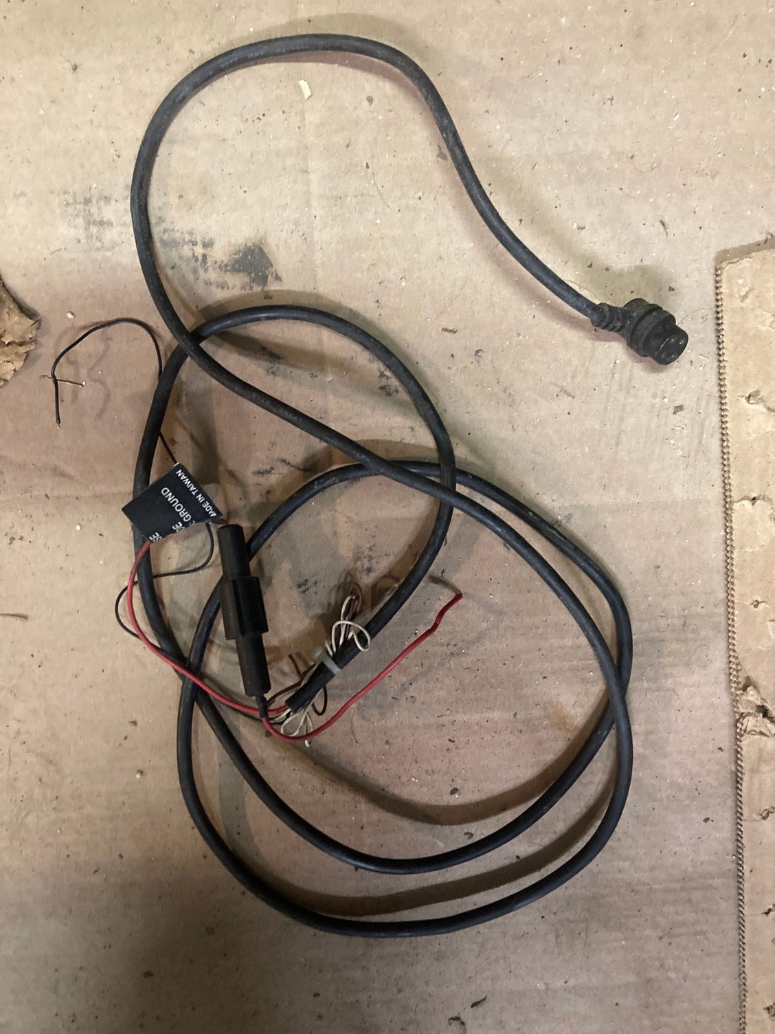

New owner of an E bike, it is a Wart Hog 750MD with dual batteries,
and up jumped a power connection problem, how to connect it?
I have the above GPS with external power plug 12v type and antenna,
that I want use on my Ebike.
If possible, how can I power this GPS from the bikes dual battery's,
this GPS uses a standard 12V cig plug, and my WH bike has a USB plug,
unknown power amount ? This GPS also uses 2 Double AA batteries for hand held use,
but they don't last too long, so I would like to power up from the bike power source etc.
I found this info for the antenna current draw spec's,
DC Voltage:3V, 5V, 3V to 5V
DC current:5mA ,10mA Max
Your thoughts and suggestions............
Tia,
Don

I use/have these items for my Garmin 60 gps,
the power cord is OEM that plugs into a standard 12v cig lighter plug, and powers the GPS.
The ext antenna which fits the Garmin 60CSx gps, and draws it's power from the GPS.
I need a way to use the OEM 12v plug and adapt it to my bikes battery power source, if possible.
My bike is NOT 12V, that I know of.
Tia,
Don
Tia,
Don

I just checked mine and it will power up/work without the double AA's installed, using just the OEM 12v power plug. I normally carry a 6-pk of AA's when using this gps, as you know the battery life is very short, the 1 minus mark against it.
I have used this set up on my ATV, with the charge cable/cig plug and added a cig plug on my ATV, when the 60CSx GPS is mounted to the handle bar plate, the GPS runs fine, and doesn't use the twin AA batteries, so I have a back up when I use the gps off the ATV, ie geocaching/exploring etc.
What I don't know, (beyond my pay scale), is if I can have a USB plug installed on the OEM power bare wire cable, I have both type, with and without the OEM round plug.
IF a USB plug can be adapted to the bare wire power plug, then maybe I can use it to get power from the bikes battery?
Thanks,
Don
It has been years, since I read the manual, I'll have to dig it out and review it.........
I bought it the first year Garmin came out with it, as it was one of the ones that took an Ext antenna, which I wanted as the tall timber often blocked the sats view etc.
Ball mounts did have a GPS holder and base mounts, as that is what I now use on the ATV.
Thanks,
Don

Guys
What is the NAME of the item or equipment, that will take DC 48V down to DC 12v 5a?
As you can tell, electronics is NOT my strong suit.....LOL,
I have a concern about the 48v DC bike battery and plugging my 12v DC 5a,
Garmin 60CSx GPS.
What would the best/safest way to do this?
Tia,
Don

This what you need?
I have and old 76 I’ve not used in years.
