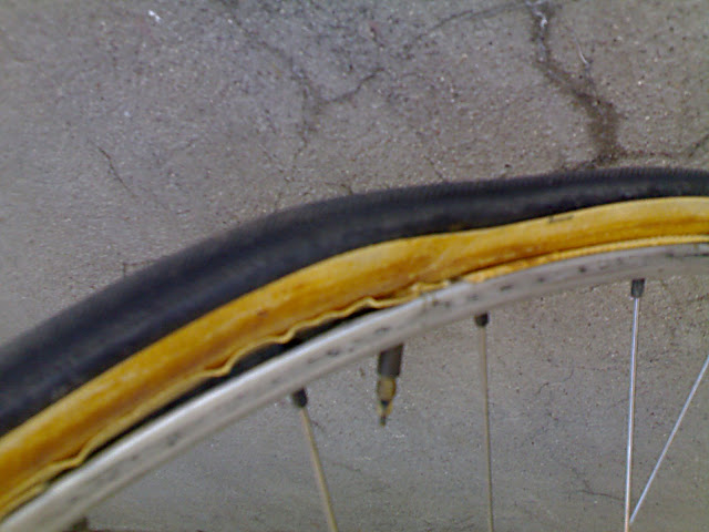

Any remedy for a lump? Developed in the last 15 miles of a 45-miler today.
dudeona3V is offline
None that I have ever heard of. The casing is shot.

Old 11-18-08, 09:51 PM
  #341
urodacus
Large Member
urodacus's Avatar
Join Date: Nov 2006
Location: Okinawa
Posts: 1,186
Bikes: 05 Giant TCR 0; 94 Le Mond Alpe d'Huez; 83 Colnago Saronni; 81 San Rensho Katana Super Export track bike, #A116-56; 97 GT Zaskar
yup: take it off and throw it away, and put a new one on. quick, before it pops on you.

Old 11-18-08, 11:44 PM
  #342
dudeona3V
dudeona3V's Avatar
Location: SRQ
Posts: 553
Bikes: '69 Raleigh DL-1, '72 Paramount, '75 Eisentraut, '80 A-D Vent Noir II, '82 A-D Inter 10, '83 Motobecane Grand Touring, '83 Stumpjumper, '84 Masi GC, '87 Recherche, '87 Tesch 101, '88 Tesch S-22, '88 Davidson...
That's what I figured. Any recommendations on something befitting a '74 Masi Gran Crit? Veloflex or Challenge Criteriums maybe?
What is wrong with it? the hump or the discoloration? I don't know that well the meaning of the word lump and the dictionary is quite vague.
If the problem it is the hump, it is super clear to me that the tubular it is not in the right position. Look at the valve. Take the tubular off the rim and re glue it. Done.
I see that apparently you got a flat right there nearby the valve stem. If that is part of your problem, just unsew it (the sew up got saw), and sew up that part of the tubular really well (15 minutes as much).
If the problem it is the discoloration and dryness in the lateral walls of the tubular, thats because the tubular is simply old. I have used even older tubulars, you shouldnt have a problem unless the road band is pretty old too.
