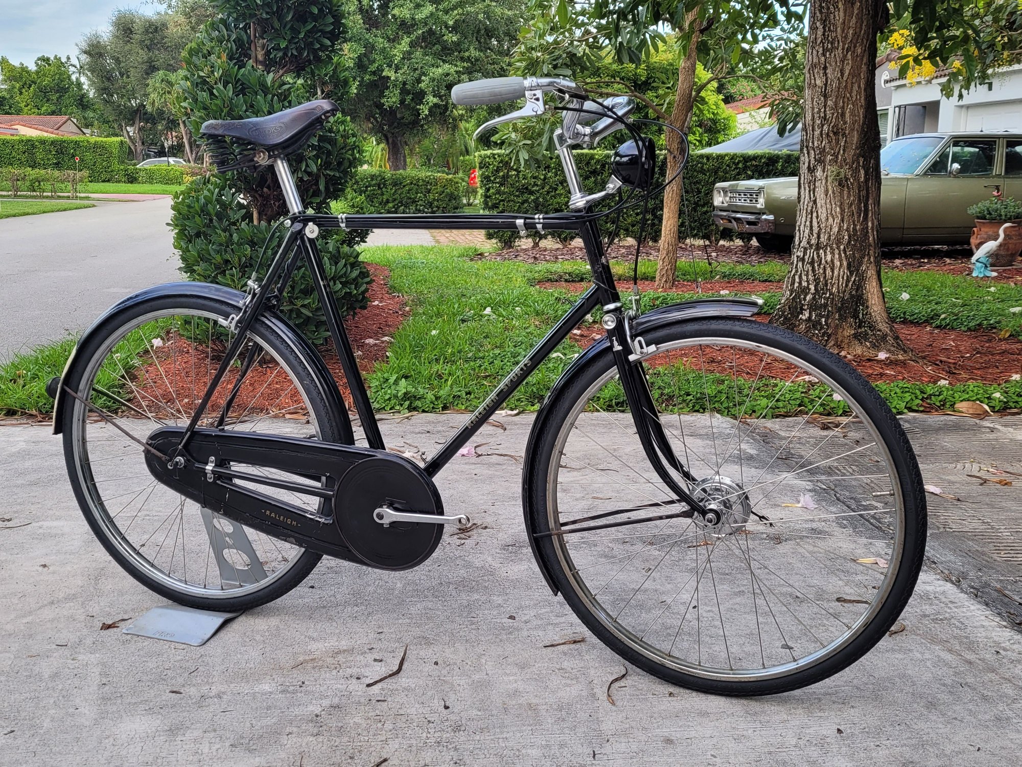

They fit nice and - as pointed out above - have a slightly thicker cross section over the budget stuff. Here are a pair on my '52 Sports:
They also fit onto the rim well and the bead tends to seat without issue. However, they're tight enough to give peace of mind that they won't blow off the straight-side rims.
-Kurt
P.S.: @SirMike1983 - love your Sports there. These black 1950's/early-1960's machines have to be the most satisfactory way to get into 3-speeds. Between the paint, bombproof chrome, and understated panache, they feel so good to ride and own - and it's a lot of fun if you're lucky enough to come across someone else with one too.

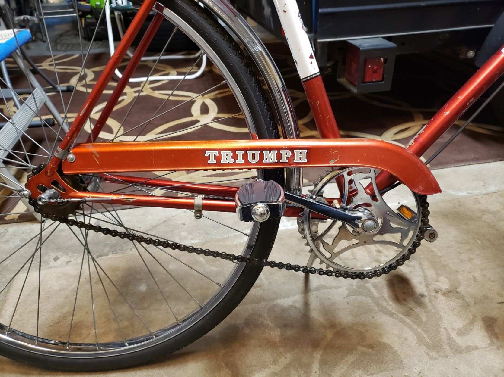

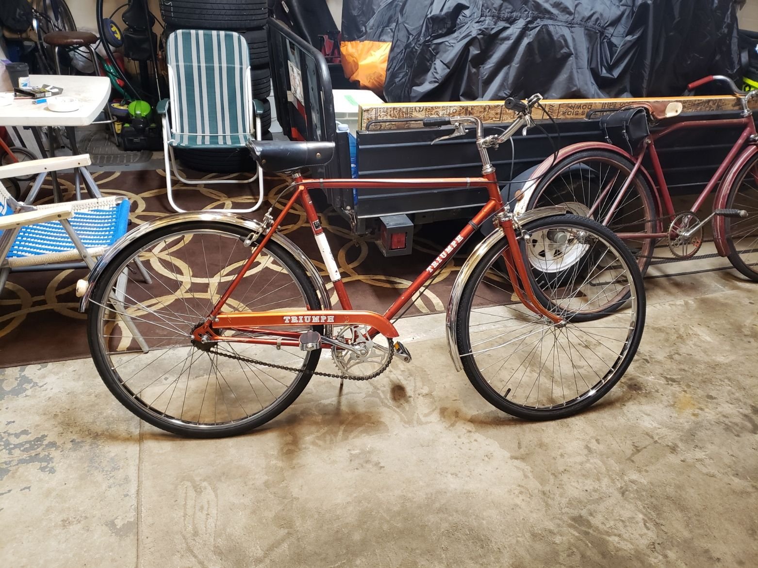

Triumph Made in Canada
Men's Triumph 3 speed Sturmey Archer AW 75-9 . Made in Canada.
Serviced and shined it up. Put on a set of Michelin World Tours.
Nothing really special but it rides nice.
Is it normal to have a Raleigh stamped chain ring on a Triumph bicycle?
This is the first one I have seen. I really cant answer that truthfully... It seems to have the characteristics of a Raleigh throughout the bike. I think Raleigh made these bikes... A lower end Budget bike??
Although it may be different on a Canadian built bike, but the Triumph bikes I run across here usually have a generic 3 spoke chainring and ball bearing pedals.
On English built bikes, I was under the impression that those pedals were also a late 60's thing, maybe even as late as '70 but our mid 70's bikes all had reflectorized pedals with bearings.
If I ran across that here I'd likely just assume it was either put together from spare parts or at the very least had a crank set swap at some point.
I see its got 36/36h wheels, what branding is on the rims on that bike? Dunlop? Sturmey Archer? or other?
