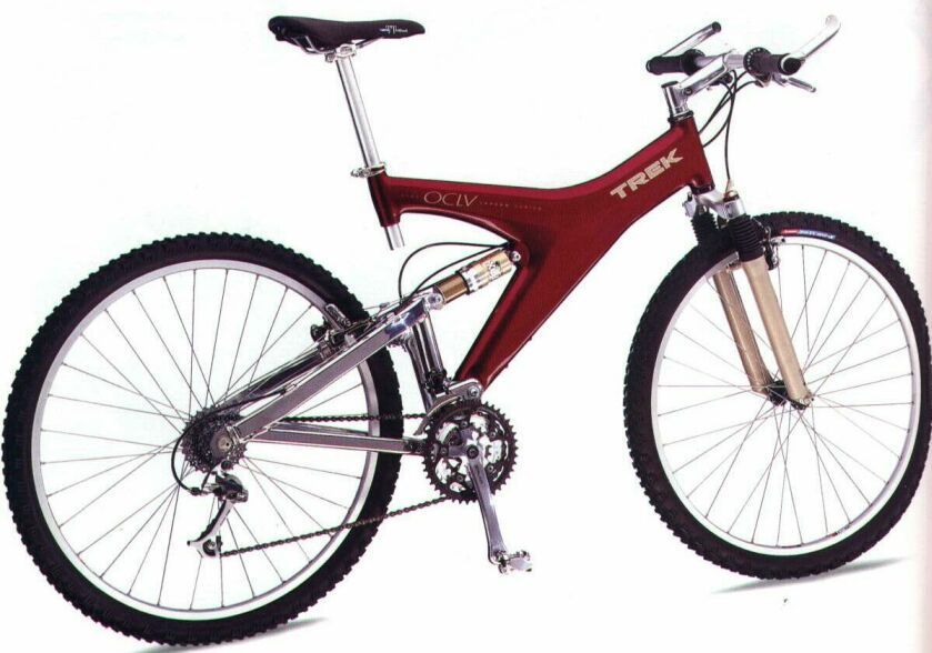

PS: Here are a couple of links for reference that show twins of the three Y bikes I'm working with. The first is a Y-33 with a URT with round tubing and provisions for mounting a rear disc. The second and third are earlier model Y-22's which use rectangular section tubing for the URT and V-brakes, with no provision for mounting a disc caliper in the rear.
https://www.cool386.com/y33/y33.htm
https://www.cool386.com/95y22/95y22.html

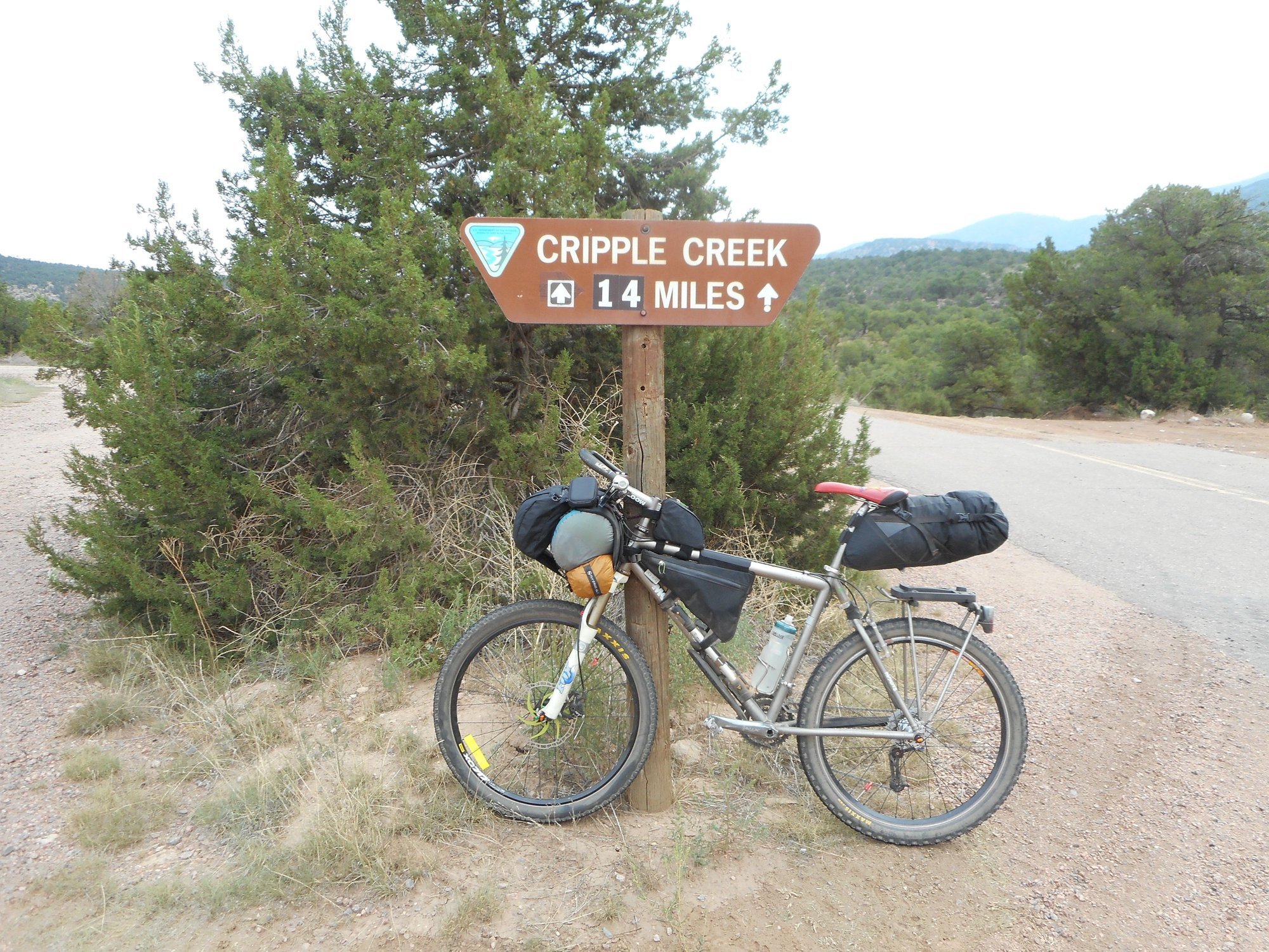

I donít carry much load on the rear while bike packing. Hereís 3 configurations I use from different trips.
The second one is where I used a set of very small panniers that only carried food items (mostly freeze-dried meals). Total load on the triangle was probably less then 5 lbs and diminished with each nightís camp. The fork leg racks are convenient but in the third picture, I did a whole lot of bushwhacking and the fork leg bags were a drag, both figuratively and literally. I put a hole in one of them while dragging it over rocks.
Although expensive, you might consider an Aeroe Spider Rack or Thule Pack-n-Pedal or something else like it. Bikepacking gear is changing and developing rapidly new stuff is showing up all the time. Almost all of it is far better than a seatpost rack.
