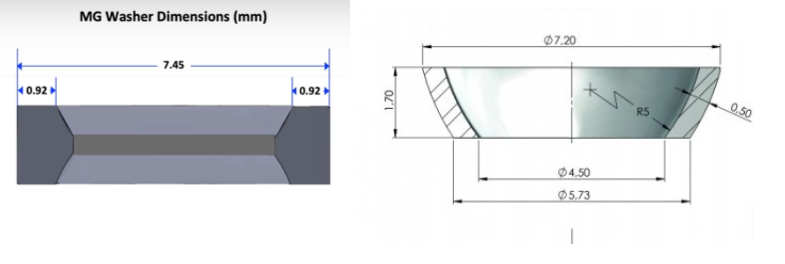

If you're going to take the time to rebuild it, I'd probably get a fresh rim to try with the washers. (That is, if you can find one.)
Thanks, that seems like the way to go. I have no experience adding washers. For 0.5 mm thick, but perhaps additional space if the washer is not perfectly flat. Does this have much effect on spoke length calculations?

True that aluminum fatigues and tandems are harder on wheels... but I disagree that 7000 miles was "pretty good". This wheel should have been bulletproof!
The Ryde Andra 35 is a heavy rim with thick walls... in ISO 584 size, it weighs nearly as much as the original steel rims (ISO 590) from my old English 3-speed! And with symmetrical dishing for the Speedhub, there are no extreme spoke tensions. So it should have been extra-kind to the rim, no spokes going slack or exceeding the tension spec under load.
Andy mentioned anodizing, and in poking around on the Ryde website, I learned that their "pre anodized treatment" means that the extrusion is literally anodized before the rim is rolled and machined. I thought the industry had learned not to do that, but perhaps it's why IPassGas had premature (IMO) cracking. I would imagine that he is out of any warranty period by this point, but it would be worth bringing up with the dealer and/or Ryde themselves anyway.
You mentioned that the nipples still have a couple of threads left... two 56tpi threads is almost 1mm if my math is right. The ideal spoke would come right to the end of the nipple head. So if you're buying new spokes and planning on 0.5 washers, I'd add 1.5mm to what you had and round to the nearest available spoke.

These rims don't have any eyelets. The hope behind a steel washer is that it would spread out the pulling force of the spoke nipple a bit. (On aluminum rims without eyelets, chamfering the spoke holes helps do this a little.)

... anodized before the rim is rolled and machined. I thought the industry had learned not to do that.
Thanks for your digging. Does rolling an anodized rim tend to cause the anodization to separate? I presume this would be of only a cosmetic concern. It still seems that the crack is a sign of an underlying problem, perhaps exaggerated by this anodization process.
My understanding from reading Jobst Brandt's rants about it, is that the act of rolling the rims after anodizing causes tiny cracks to form since you're bending an anodized layer that's more brittle than the plain aluminum alloy. Then those tiny cracks can grow from riding on the wheels. Lots of other companies roll the extrusions into rims, weld them, and then anodize them, so they're not "pre-cracked."
Since your rims haven't deformed around the spoke drillings, it's possible that the cracks you see are just in the anodized layer and haven't spread yet. I'd be curious how much more riding it would take for them to truly become a problem. Some folks will take a Sharpie and mark the ends of the cracks to check whether they are growing or not.

Is there any wisdom in removing the anodizing around the cracks and seeing if the cracks also exist in the aluminum? If the rim is fine, I'd say you're good to go, plus by removing the crack in the anodizing, the crack won't propagate into the aluminum over time and miles.

Did you contact Ryde USA or Ryde NL? In my experience, Ryde USA isn't up to speed on all of Ryde offerings.
From the Ryde.nl website- "ANDRA SERIES
The Andra rims can be ordered in many different wheel sizes and with the drilling angle for the spoke holes optimized for the hub and application. All Andra rims are built to withstand and carry more load than regular rims and can ideally be used for not only regular e-bikes, but also transport bikes with or without motor support." That looks to me like different drilling angles are on someone's radar.
Are all of the cracks on only one side of the nipple and in the same relation to the angle of the spoke? From your pictures, I would believe even the Polyax nipples are not making proper contact with the spoke bed causing localized stress on only one side of the spoke hole. The nipples might be pushing down on one side of the hole and prying up on the other at that angle. 7000 miles of loaded tandem touring is very good service life if this is indeed the case.
If you do disassemble the wheel, you might put some marking ink on a nipple and actually see what kind of contact is being made with the rim.
Sapim makes three different profile nipple washers to match different spoke bed shapes which might help distribute the stresses around the hole. Your pictures suggest the nipples might be too short as is, but you will definitely need longer with the addition of washers. But if the nipple is unable to fit properly because of the angle and diameter of the spoke hole, they might exacerbate the situation.

Thanks for the reply. Yes, Ryde NL said "All Andra 30-rims have standard drillings spoke holes under angles." And from Ryde literature those angles are 8/2 deg rad/axial. I contacted bike shops in England and Australia knowledgeable with Rohloffs that said the same. Independent of a rim marketed as "Rohloff specific", which I agree that term does exists, these angles are ideal for a rohloff hub. In addition, if I put a spoke into a hole and try to feel where it would best like to point, the angles do change from hole to hole in the correct direction to the hub for that hole position and at the above angles.
The 4 cracks are on the side of the highest stress point (the side on the obtuse spoke angle). I was thinking the Sapim HM nipple washer would be best, with a conic profile. However, I think the HM will just mimic the nipple surface contact and so NOT spread the pressure point at the rim hole. Sapim's literature is unclear on this point saying "HM Washers decrease friction of nipple", which does not equate to increased strength. IMO 7000 miles is not good. I am contacting Ryde, but in the meantime I will not change anything to learn if the cracks grow significantly in time. 105kgf is appropriate for these rims rated for 140kgf and also what rohloff suggests. Anything less for a loaded tandem would not be good.

Originally Posted by Ross200 View Post
Bill Mould offers some interesting(in a science guy/engineer way) thoughts on rim cracking at the spoke holes in this video. Some thought provoking responses in the comments also.https://www.youtube.com/watch?v=qKeeHDuoFq8
Thanks, I generally appreciate his videos, very well done. He does discuss the Sapim MG washer (BTW, he uses a lot of great test gear!) He assumes that the washer is relatively flat against the rim. For the Ryde andra rims, the holes have a radial drilling of 8 degrees which is a good angle for Rohloff. So it would seem that the MG washer has a cross section that would help distribute pressure and be flat against rim. Any additional nipple angling would be taken care of by the conical shape of the polyax nipple. The HM washer would be a poorer choice, since the polyax nipple has the conical shape. Here are cross sections of MG and HM washers. Mould's video clarified that the MG washer is not just a simple flat washer from a hardware store.

The hard anodizing used in some rims will contribute to cracking. It is harder than the Al. and more prone to cracking and taking the crack through the al.
