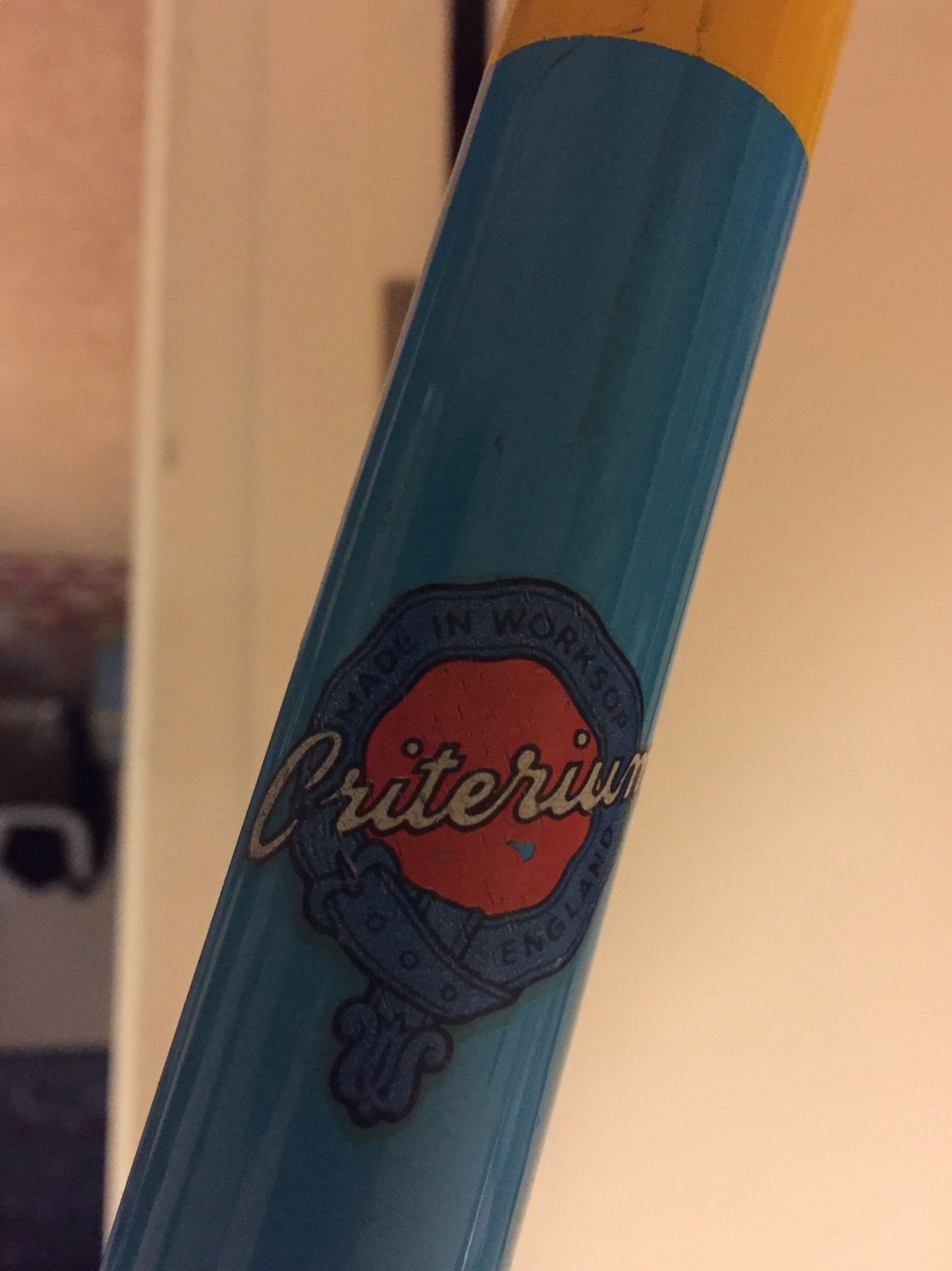

hi all, over the weekend i came across a n+3 bike. Itís not a top of the line and is on the upper edge of too big for me, but couldnít resist it the chrome lugs and the victor seat cluster.
After a little bit of reading online it looks like itís a Carlton Criterium from around 1970 with all OEM parts, including the saddle. Having steel components, itís actually not quite as heavy as i was expecting, still not a fancy reynolds tubing, and should clean ip quite nicely. Itís not a fancy Italian stallion but should be a fun project.
Now, any clue on how to read these numbers, canít make it match anything i find online...?
Thanks for your help!

Unfortunately there is info on how to date them in the range of '39 to '67 and the later range of '73 to '81
But the space in between is a bit of a mystery.
Quoting from a website that doesn't exist anymore, but you can see it here via the Wayback Machine: Dating Carltons
"From 1968 to 1972 two numbering systems were used. The majority of models had simple numbers, up to seven digits, sometimes with leading zeros, stamped on the left rear dropout, at the top of the seat tube to the rear or under the bottom bracket. I do not have sufficient data to analyse these numbers and relate them to specific years."
Please do post here any info you can find -- good luck!

I found an almost identical twin (slightly different crankset) online on retrobike forum Carlton Criterium | Retrobike that describes the bike as a 1970 but iím not sure how they came up with that date.
iíll go through the catalogues, it seems like there are quite a few online, and work by elimination.
even if i canít identify a precise date, i should be able to get a ball park, and either way it will satisfying to clean it up and bring it back to some glory.

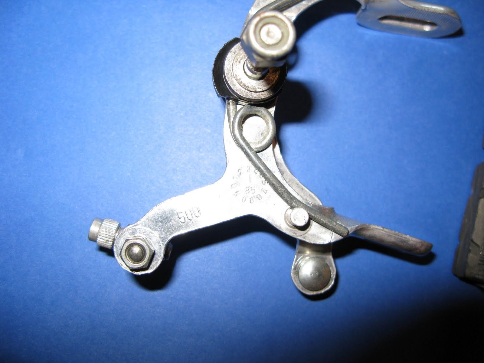

the cycle's Weinmann brake calipers may exhibit a date mark on the backside of the caliper arms in the form of a clockface, altough suspect they are a bit early for this type of marking

I have a scan of the 1970 Carlton catalog here, not very high-res unfortunately. I can see that the Criterium model had a Williams crank, the same one as on the retrobike forum. Williams chainrings also have a date code stamped in them, so that can help dating a bike.
You different crank could mean an earlier or later model year, or just a running change -- as we know happens -- real world bikes don't always match the catalog spec. Or your bike could have had the crank swapped by a previous owner.
I know, I'm not helping! Good luck.

Williams chainset specification in 1970 catalogue -
one can often catch them using illustrations from an earlier year in their materials - perhaps under time pressure to get the publication to the printer.
subject cycle's chainset is Verot model 52:
Presently thinking 1971 for a birthdate of the cycle.
