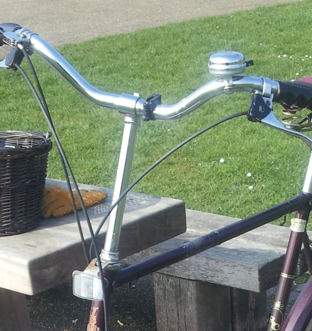

This is the stem I'm trying to remove.
I cannot find them anymore so it has to come out.
I will take pics of the stem with everything removed.

Are the cables keeping it from lifting out?
Those brake cables are stretched to their limit. Cables can be surprisingly restrictive. I'd unhook those cables and go from there.

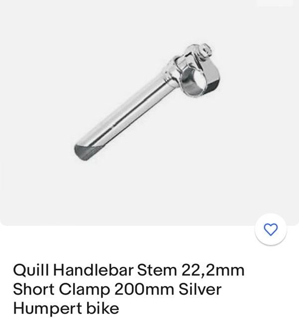

It looks like this type of Humpert stem (taller than the one in the pic I’m posting, which comes from evilbay). Looks like a traditional wedge, no surprises. Yes, if you have not disconnected the cables yet, I agree that this is likely the cause, since you’re able to get all kinds of movement.

As one can see all cables removed. Nothing should stop it to come out.
As I mentioned earlier, it moves free, not without effort though.
