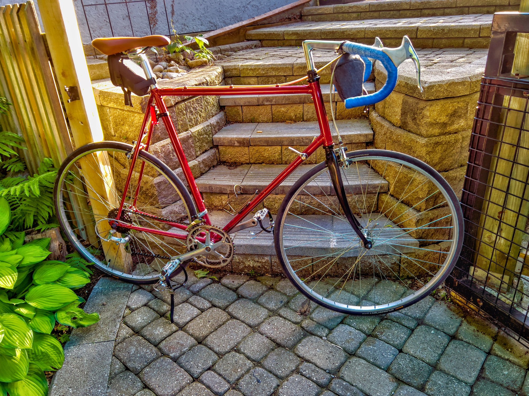

there are some problems here first and foremost you have to post a pic of the bike.....drive side visible....ok that is the only problem
but tell us the bike year and model, and what components you have
is it 120 or 126mm
I am of the group that think going to a 14x28 is a great idea
Mid-1980s Gardin TNT Frame at 63cm
700x23 Continental Grand Sport Race
126mm at the rear
Upon further review, I'm actually using a 14x28 on the rear.
Biopace 52/42
Shimano 170mm crank, A350 FD and RD
Diacompe 505 brakes.
Sorry about image sizes - not sure how to shrink them yet.
Nothing fancy by any stretch.
Tango1 is offline
126mm at the rear
Biopace 52/42
thanks like the bike and problem corrected.
I would ride in the small ring and focus on doing decent spinning. go into the big ring on downhills and with the wind behind you for now

sweet bike btw
i like the blue tape
