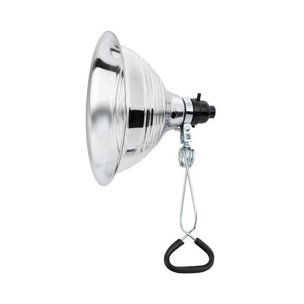

These are about $15.00 at your favorite local hardware store. I use two, and clamp them where I need them.

Those clamp on lights that Rolla suggested have been around longer than I can remember. They worked fine back in the day even though the bulbs were prone to getting broken due to being pretty much unprotected and the reflectors would get hot enough to burn down the shop if you weren't careful. Now with modern LED daylight bulbs which are often plastic and quite bright, they are a great, simple solution for many lighting needs.
And just looking at the picture reminds me of my dad. I think I'll go get one today.
I thought this is a heat lamp? We have one from raising young chicks.
These are great for many things and the bulb is what determines if you want to use it for heat or just use a bright LED bulb for lots of light without the heat.
