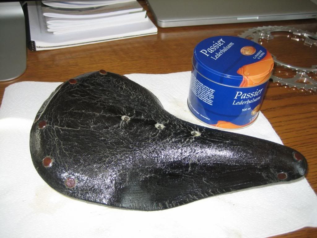

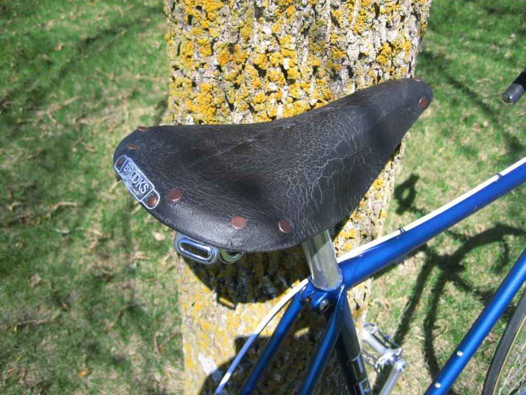

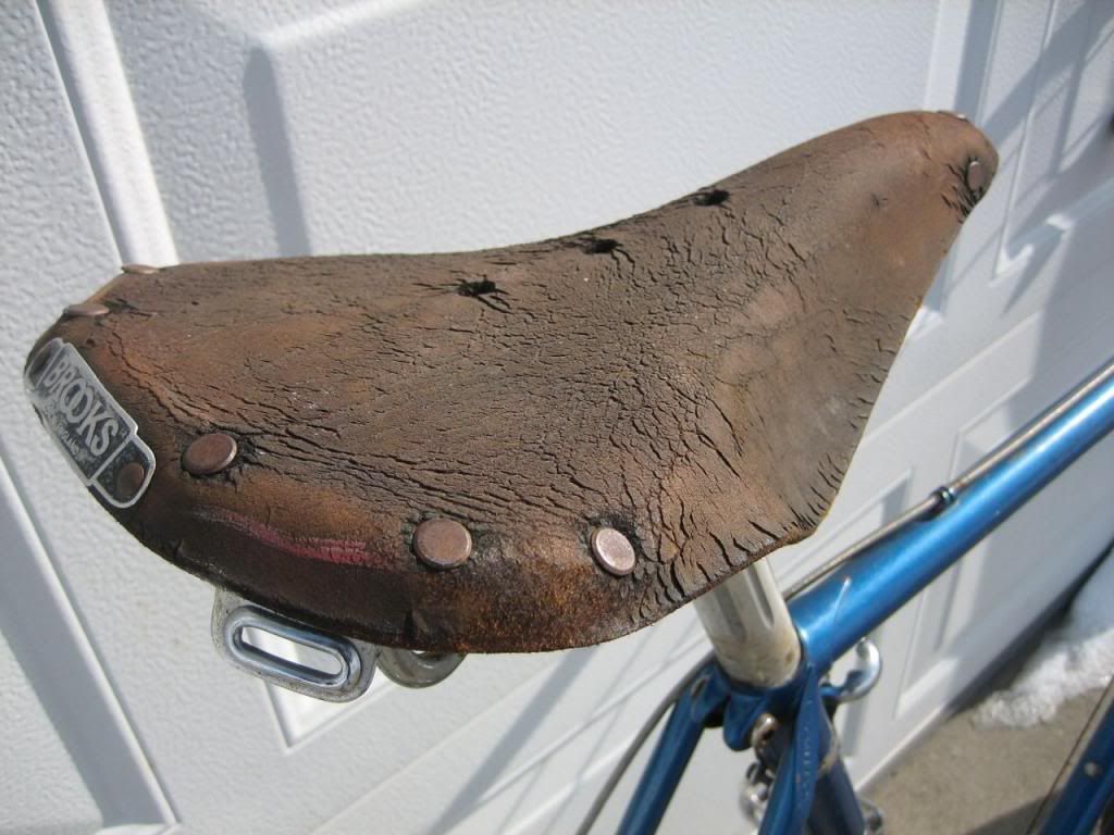

Made an attempt at rejuvenating the saddle for my son's Trek 510. He did not want to just toss it. The bike, including saddle, apparently sat out several years, directly exposed to the Minnesota weather (rain, snow, sun, heat, etc). I cautioned him to keep a close eye on it.
He rode it most of last summer before it self destructed. To and from work every day, plus plenty of errands and recreational riding… so maybe 75 to 100 hours. He was quite bummed when it tore, but then happy when he received a new B-17 for Christmas.
Agree 100% with Road Fan… "Nothing you can do will result in the weakened fibers being rejuvenated, nor rejoin the broken ones. You might be able to make the surface look better but that does not make the remaining leather like new. It's still weakened."
