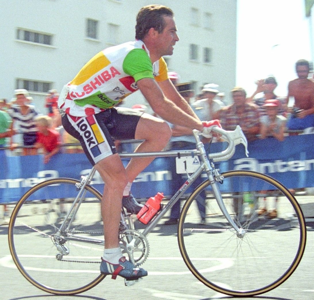

I believe it is the opposite. When French fit is mentioned it is usually referring to Bernard Hinault's book and the fit is stretched out with a flat back.

The Badger lists his frame as a 53cm with a 56.5cm top tube, 8cm saddle setback and an 8.5 drop from saddle to bars. Certainly stretched out, even with a 11cm stem. You'll note that in the photo he nearly has a flat back even when riding on the tops.

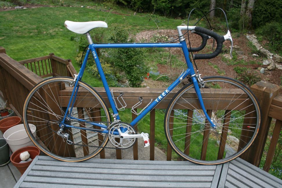

French fit is a sizing method - though the term is a bit archaic.
All statements below are general and there may be exceptions to each.
French fit is supposed to be a slightly less aggressive position than a 'racing' position.
French fit is supposed to be comfortable for longer rides = randonneur distances.
French fit results in less saddle to handlebar drop.
How you can achieve a French fit depends on your preferences, and the bike's geometry. Raising the stem height seems to be the 'standard' and easiest application. Sizing up the frame to gain a taller head tube is another popular way. With the taller head tube the stem does not need to be raised as much, delivering a more tradition road bike appearance.
Every picture tells a story, don't it
^^^ Traditional fit (forgive mismatched tire)
^^^ French fit, note taller headtube, less seatpost.
