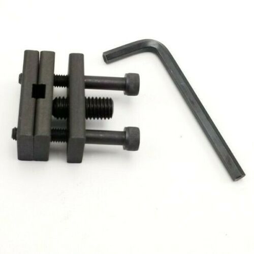

Need a tool to connect split chain together, i believe its called "chain press", but way too expensive for this simple design $15.
I have this chain breaker tool, can i convert it to use as chain compressor tool say if i put something that prevents pin from going trough the opening at the exit/opening end where the pin come out of the chain?

I used a washer to act as a spacer back when I used that type tool.

That chain press is for the master link on a motorcycle chain. I've seen guys on the trail replace a master link with a small socket and a rock, but the press is a lot easier. There's no need for a chain press with a bicycle chain.
My question was more on how to connect the new chain permanently (without using quick link), but with pin that you need to press in. how can this be done without a chain press?
I don't want to use quick link because sometimes they fall off and i want to use this for coaster (brake) hub.

You just push the pin in with the chain-break as others have explained above. Line it up with the pin on the tool and push it in. A chain press pushes two pins on one side of the master link into the plate on the other side. Lookup motorcycle master link and you'll see what I mean. By the way, track sprinters use quick links so I wouldn't be too concerned about their integrity on your coaster brake bike if you decide to go that route. All of my bike chains have quick links.
