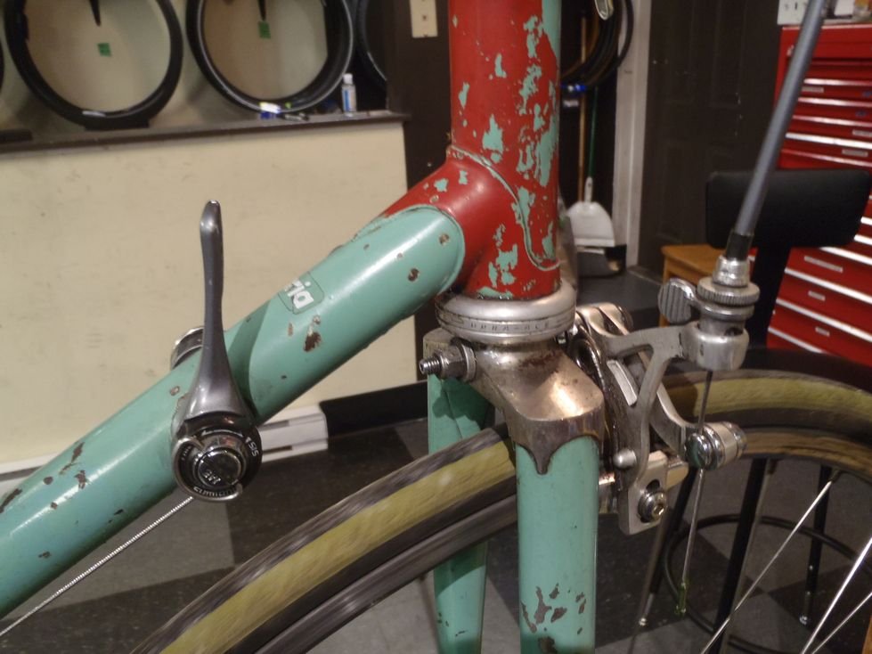

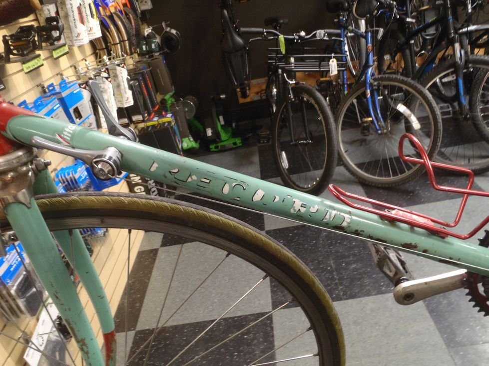

This belongs to one of the employees of the LBS. Once upon a time it had chrome stays and forks. The fork blades are fat like old Columbus and he says it has an italian BB. Nothing on the bike is original.

Bianchi had a longstanding model in its lineup called the Record. THe Celeste paint is also a clue.
I could not find any online photos of a Bianchi Record where 'RECORD' was the main label on the DT, though.
Raleigh also made a bike called the Record but this is not one of them AFAIK. Raleigh Records were cheaper bikes with plain dropouts without a built in derailleur hanger.

joinery of stays to dropouts reminiscent of Teddy Carnielli's treatment

Juvela sure may be onto something, and the stay joints being a clue pointing to Bottecchia is certainly one I'd never have noticed. Since this reportedly has an Italian BB shell he's in the right territory, cannot tell what the DOs are but likely these are Campy or GPM. The thing with Bottecchia is that details like seat stay caps and forkcrown are all over the map and since that marque also spans many decades plus model-levels it's hard to nail down the make, however you DO see occasional examples that use this style (Italian) crown as well as sometimes those trad stay caps.
Since the RD cable routing is above BB shell and the brakes are nutted, I would say this frame could fall into the era that Bottecchia used metal head badges: so when you have it in hand check for the two (vertical) rivet holes in the head tube, filled in or not, and report back.
What I don't know is how much "Contact building" Carnielli did that may never have been badged as a Bottecchia: he certainly did a little bit (LeMond, for example) but need someone with more depth to chime in.

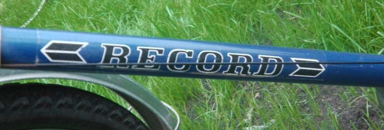

The Record decal is part of a generic set. I suspect it was used by the odd bike shop as a "house brand":
just returned to the thread to edit me post and mention that this might be a possibility
wonderful to see you beat me to it - and complete with documentary evidence no less!
thanks so much non-fixie!

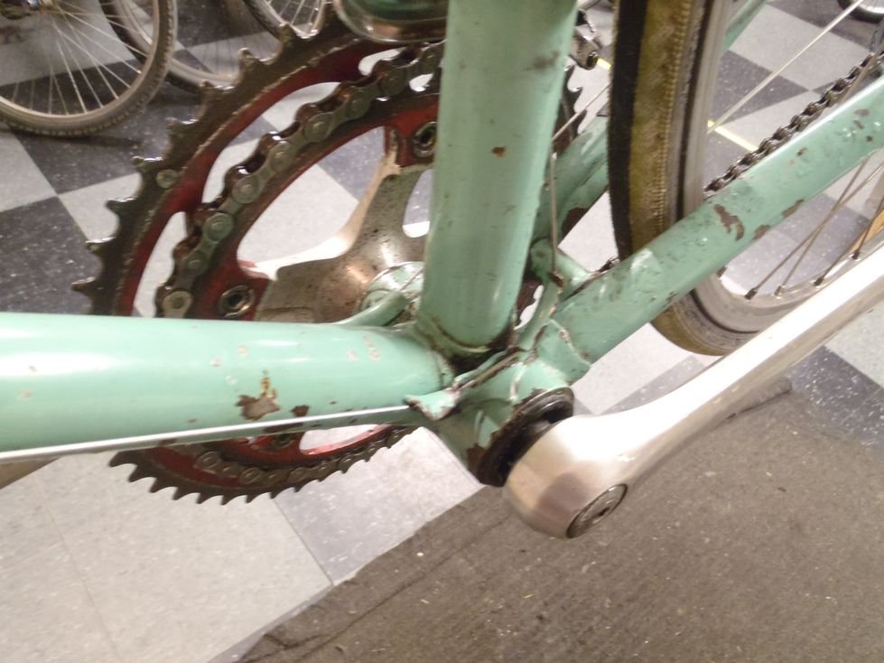

one piece of information we have not as yet received is what the underside of the shell looks like

I agree with juvela - seeing a clear pic of the underside of the bottom bracket shell would help. Are there any numbers anywhere on the shell? Also, what do the top tube cable guides look like (or is routing internal?)?
Is bb threading Italian for sure?

As requested, pics of bb cutout and the seat lug. The head lugs have no cutouts.

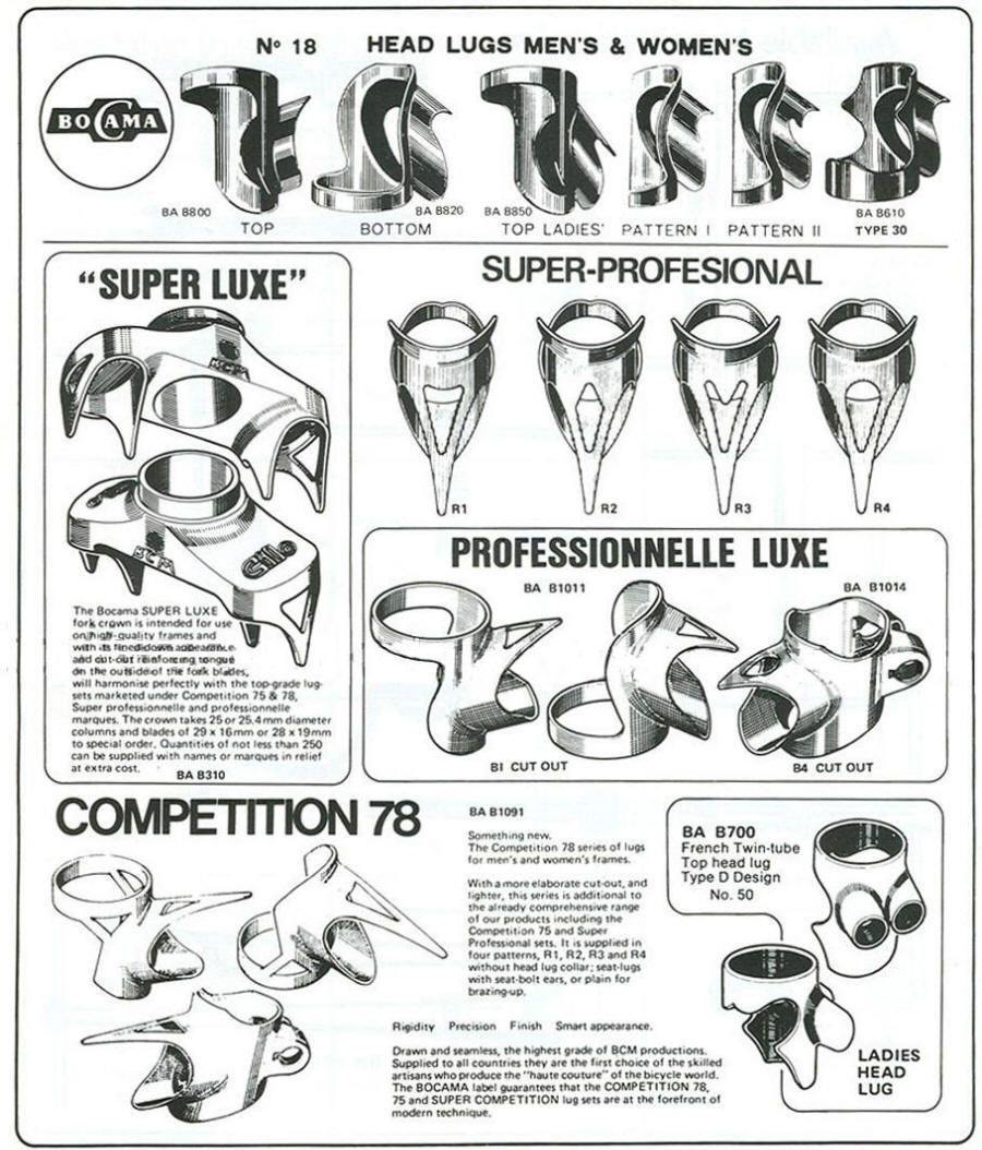

BOCAMA refers to the cutout pattern exhibited by the seat lug as R1
the fact that head lugs demonstrae no cutouts suggest frame was construced by someone "using up what was in the parts bin"
a second possibility might be tube replacement...
[cutouts more elongated on longpoint lugs and shorter on short point models]
