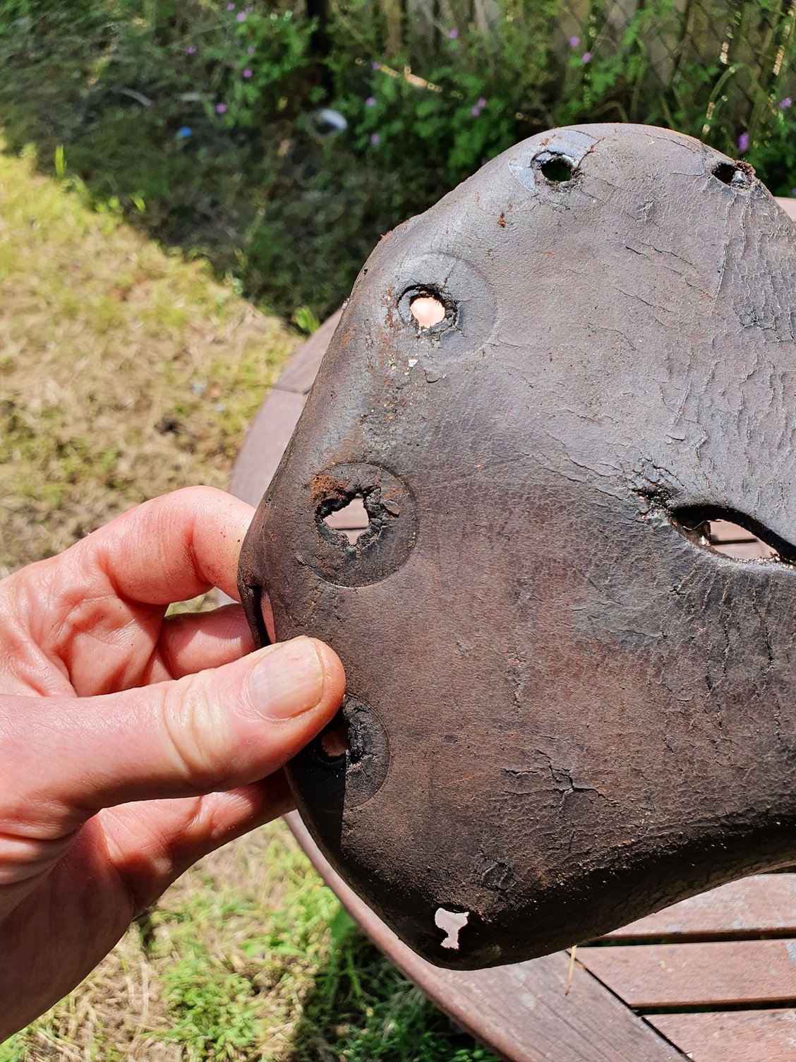

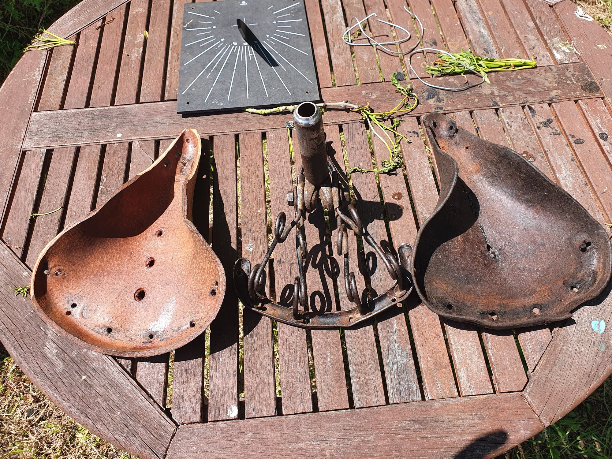

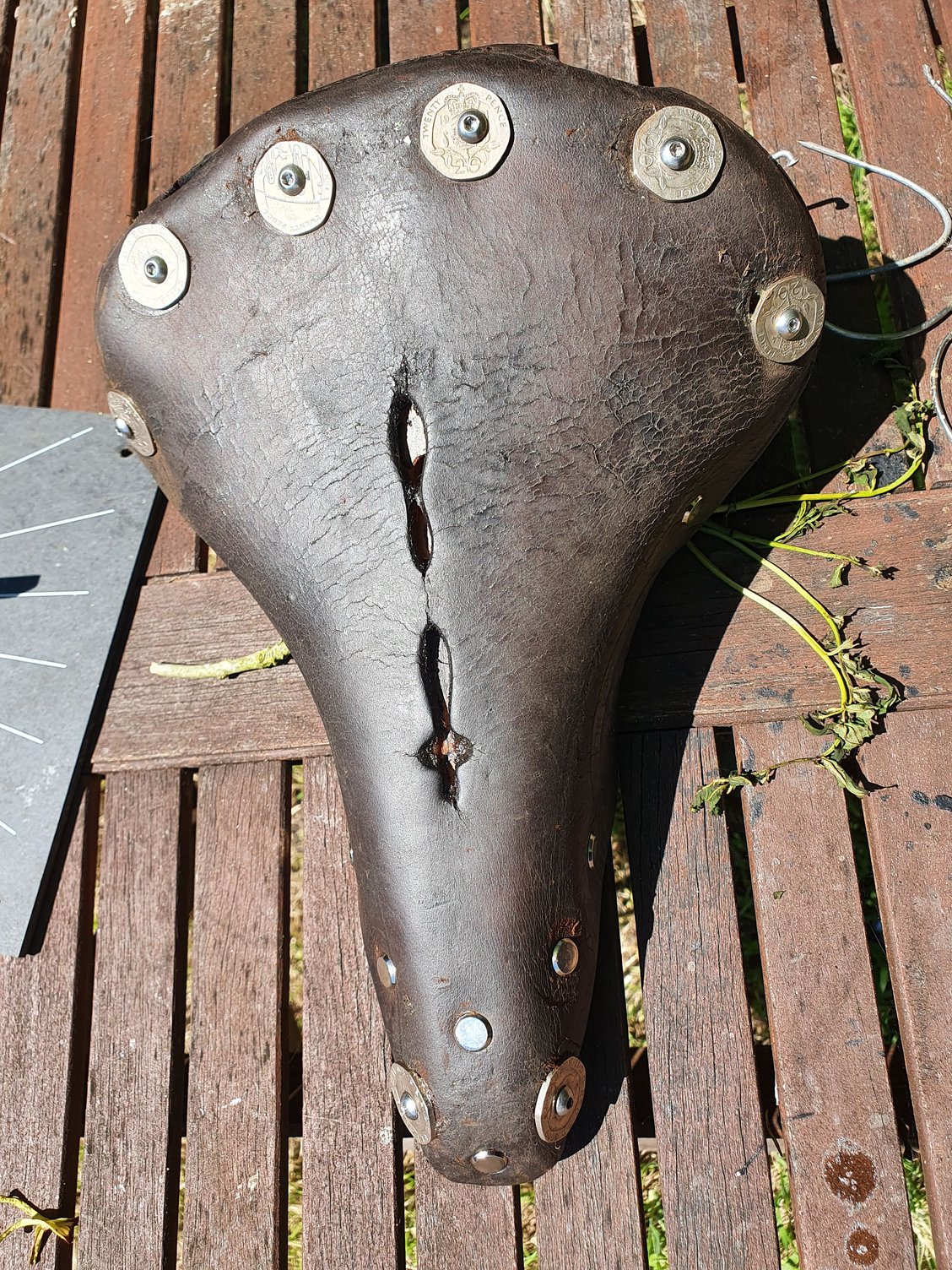

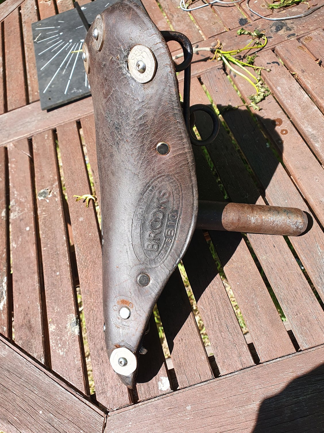

Saddle up for another 100 years?
BEFORE
111 year old saddle for my 1903 Sunbeam nose problem
BEFORE
Rear end completely detached

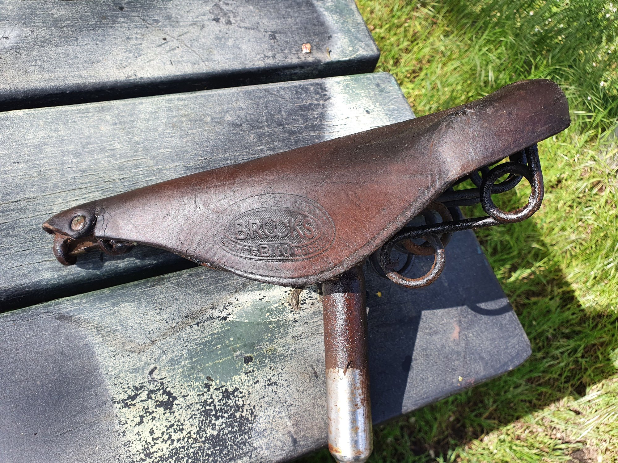

Proofed it with dabbing as it sat in a barn for a hundred years
Shaped a leather saddle to underpin the original
Used some leather glue to help out.
Brooks B10
AFTER B10 Might use a small rivet on the nose after I ride it a bit.

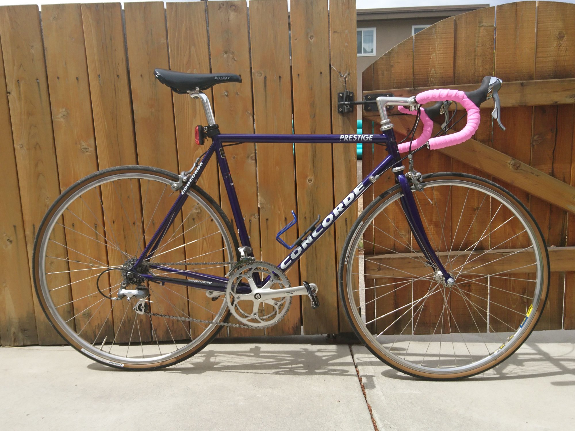

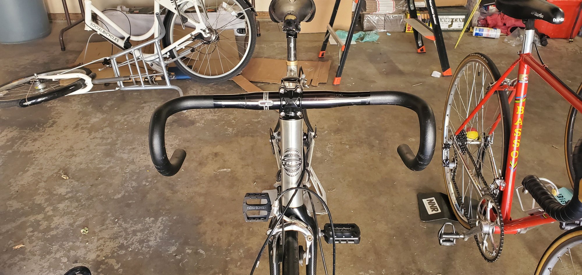

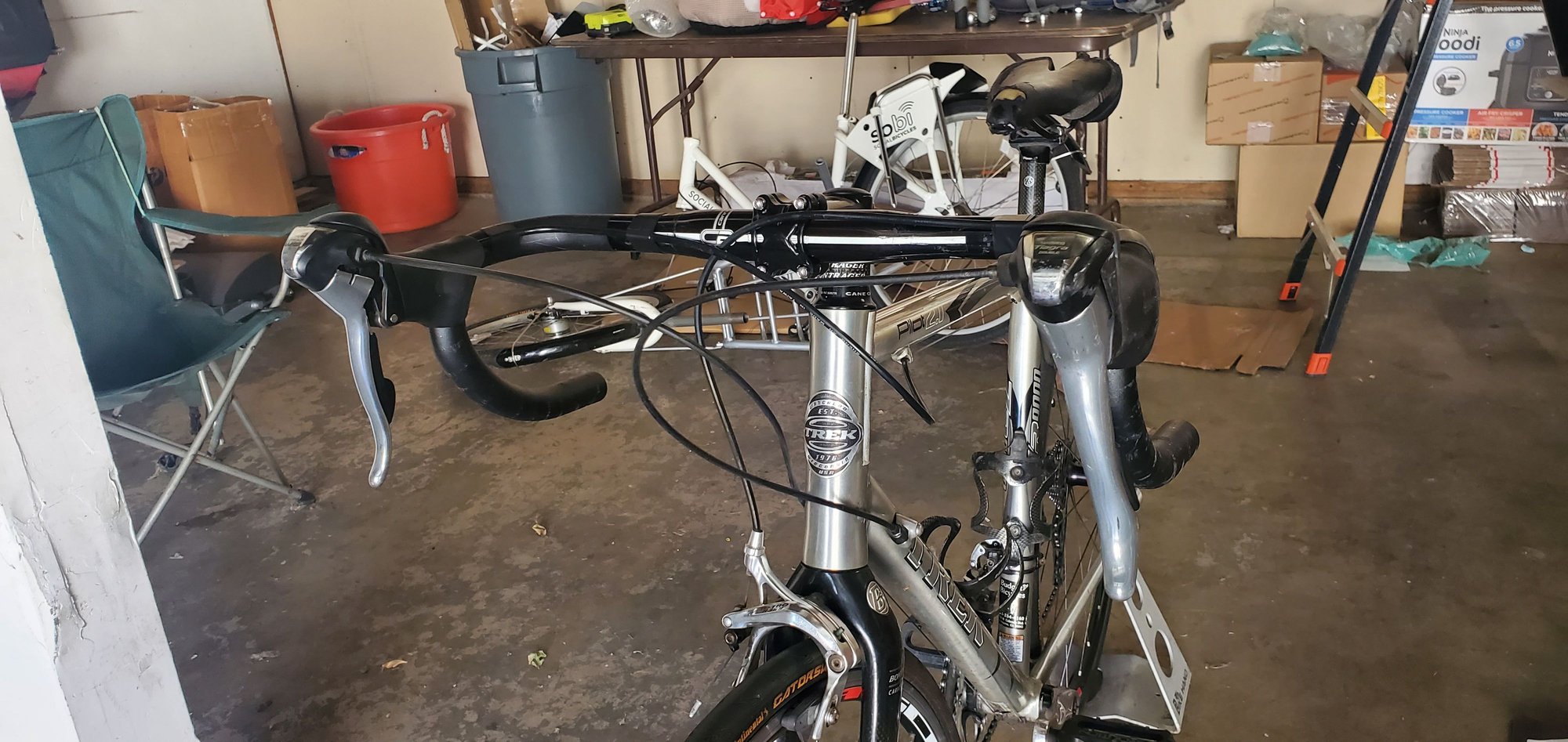

This didn't require too much work. Swapped out the Cinelli cockpit for some Nitto bits to better suit me, and go with the Made in Japan theme (Tange frame, Shimano, Ritchey bits). New and chubbier tires too for better ride comfort. Shortened the chain.
Before
After
Nitto Pearl stem and Mod 55 handlebars
Nitto Pearl stem and mod 55 handlebars
Drivetrain still needs a bit of work (incorrect length BB, high gearing not so great for my fitness or local terrain).

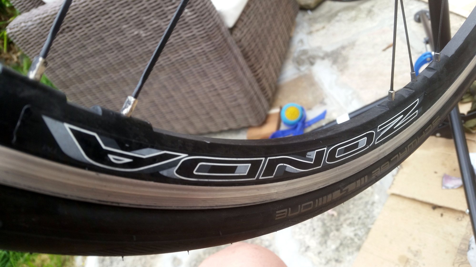

Quite a few of my mates are getting into cycling, but they seem to forget what "cleaning" is... or maybe they never knew, I dunno.
Good thing for them I seem to like working on bikes as much as riding them.

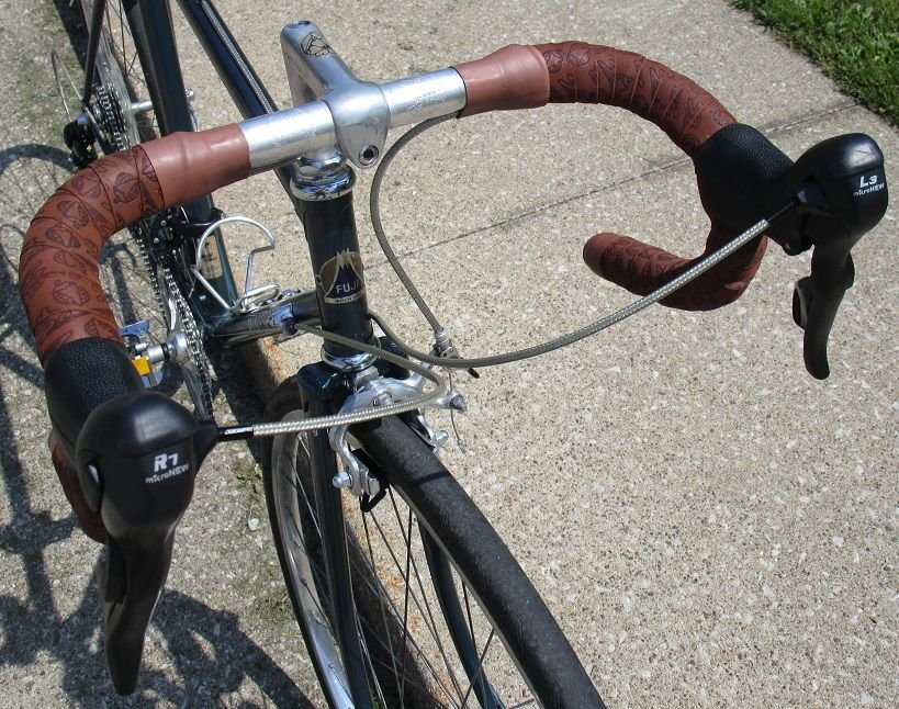

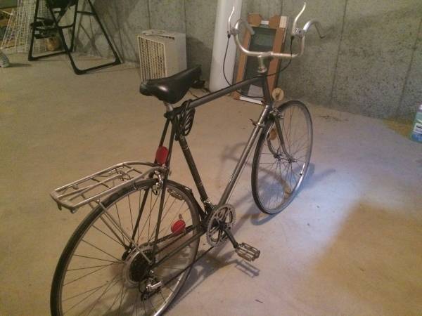

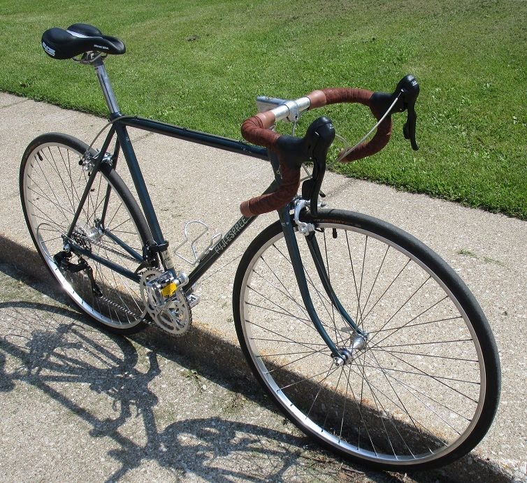

Another Fuji springs back to life!
Too many changes to list, in addition to a complete overhaul. It's a perfect fit, so it was worth it!

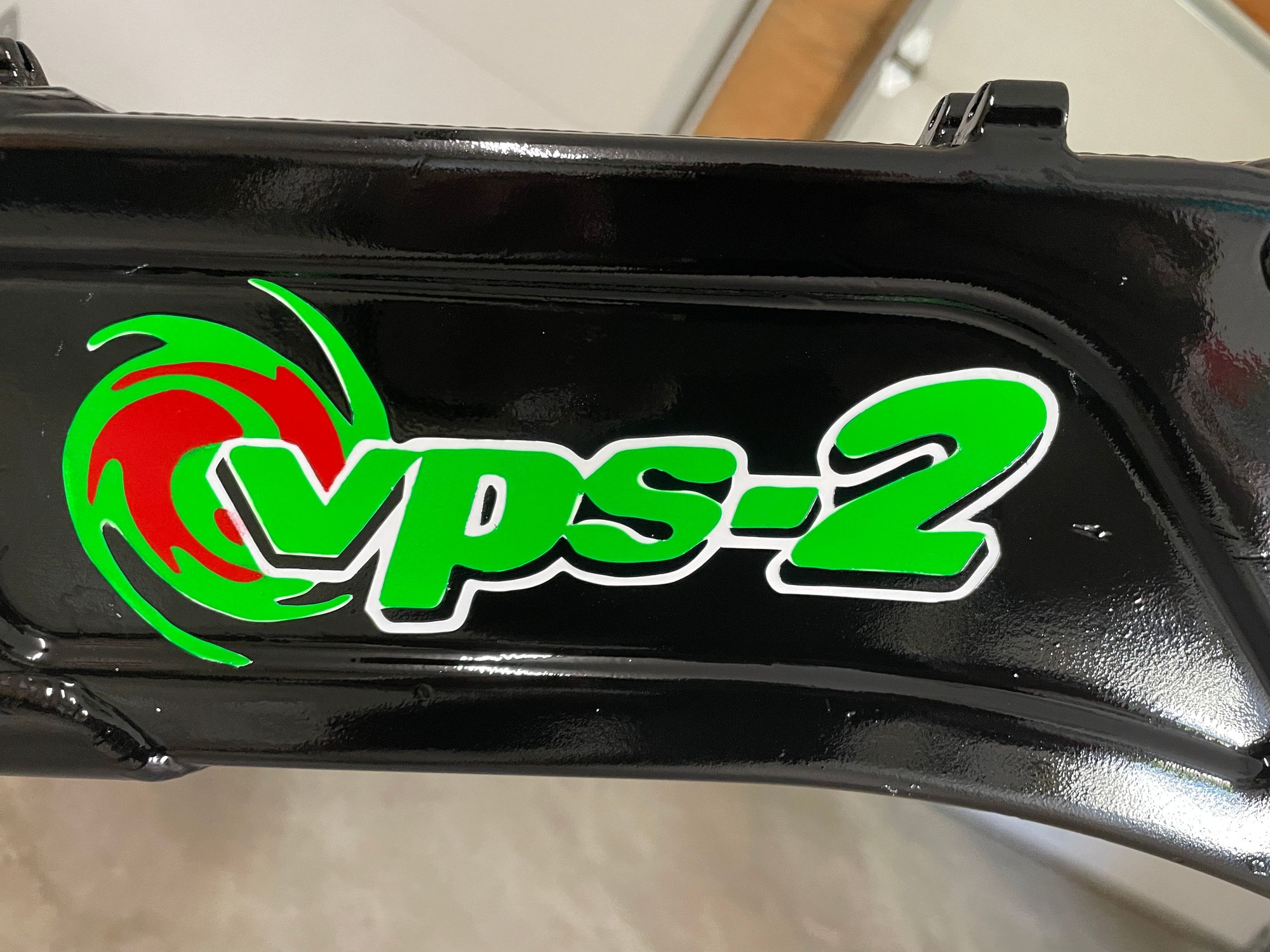

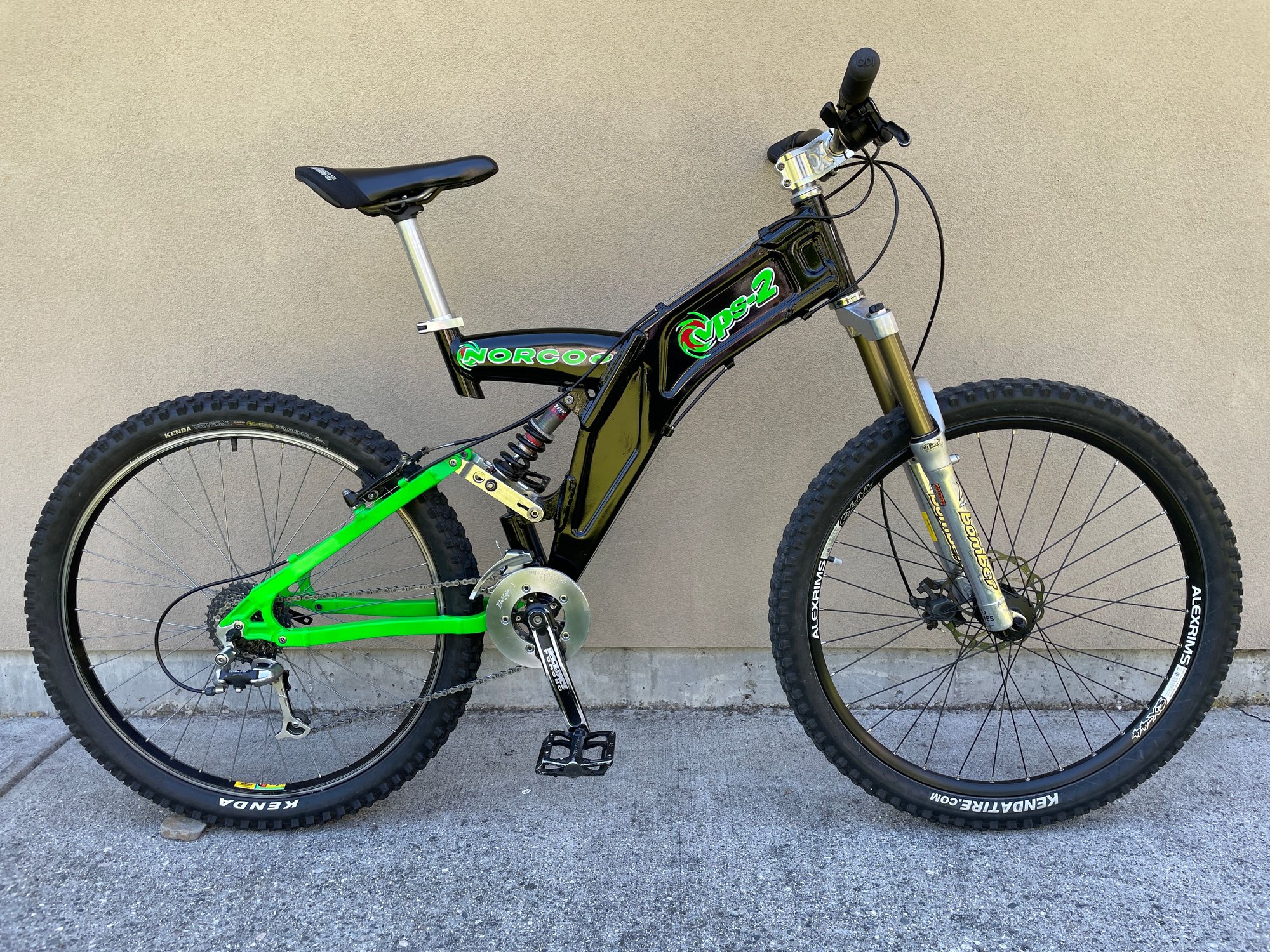

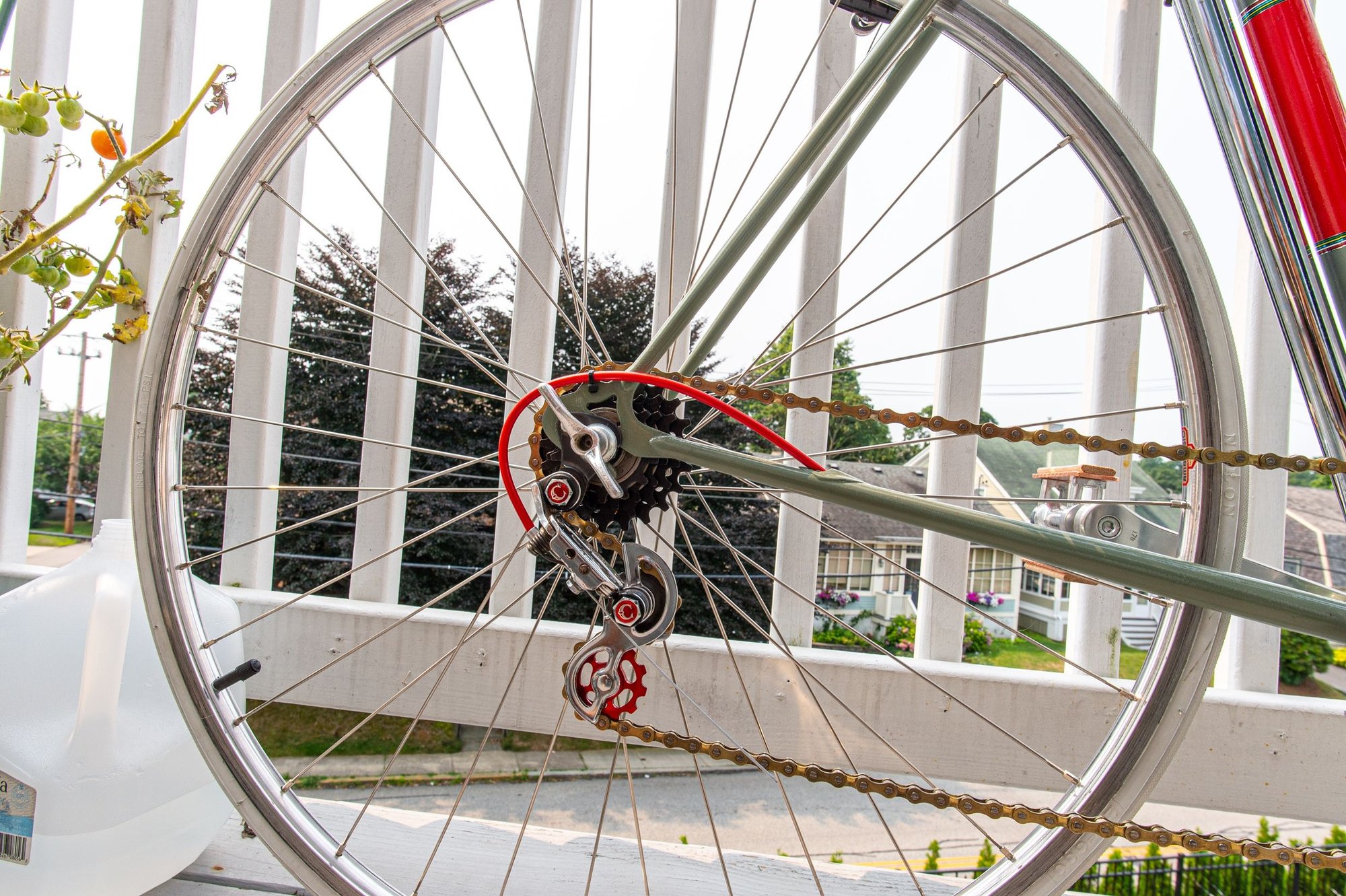

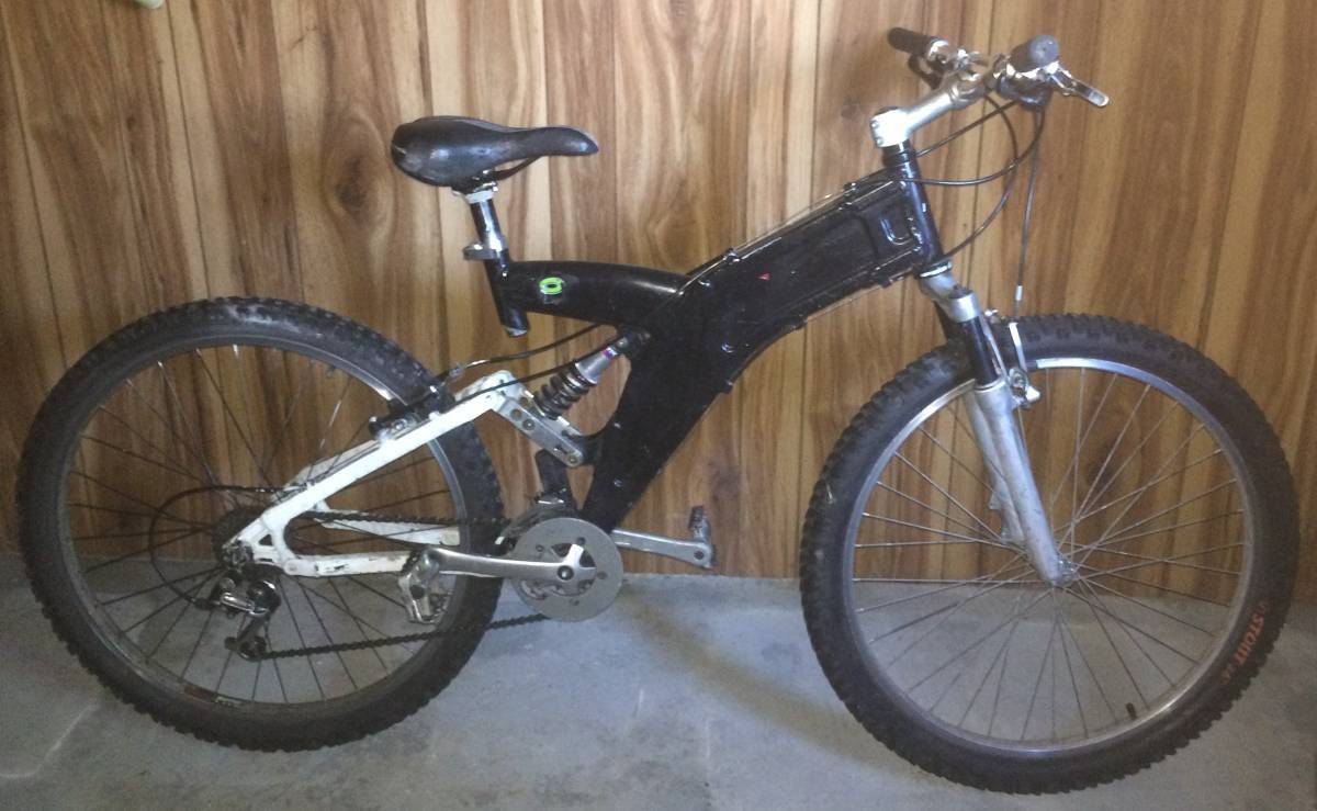

This is not a typical build for me but could not resist as it is my guinea pig build where I'm trying my hand at custom stencil logos with rattle can paint, pretty happy with the result, bought one of those vinyl cutting machines. Bit of learning curve though placing layered stencils and lining them up. Bought this sad FS bike for $50 figuring the parts would justify it. Learned it is a 1999 Norco VPS-2 which sold for well over $2,000 USD. Picked up a Marzocchi long travel fork, new frame pivot bearings, etc. Plan to sell it (without the Race Face cranks or XT RD). Was a fun build for sure
As purchased
After rebuild and logo close up

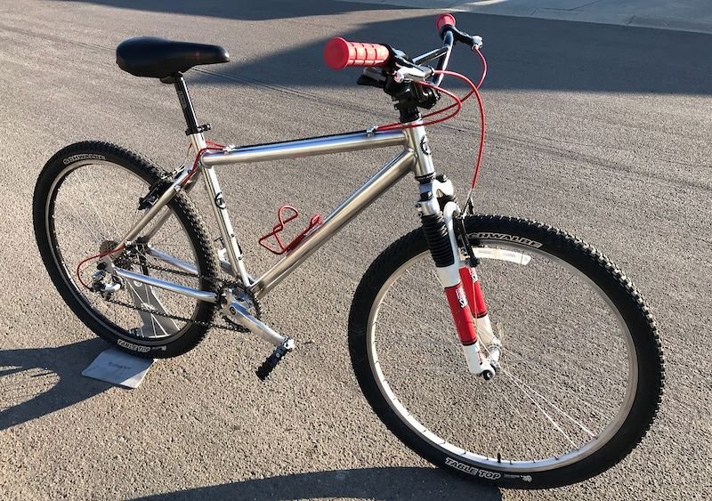

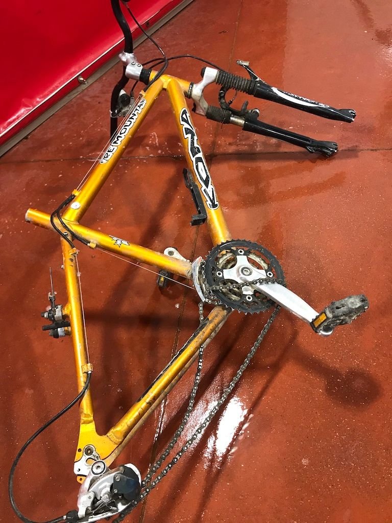

As found at the recycling depot
As is and done

retrodude those Norco's were very popular here in Vancouver in their day. Nice decal work.

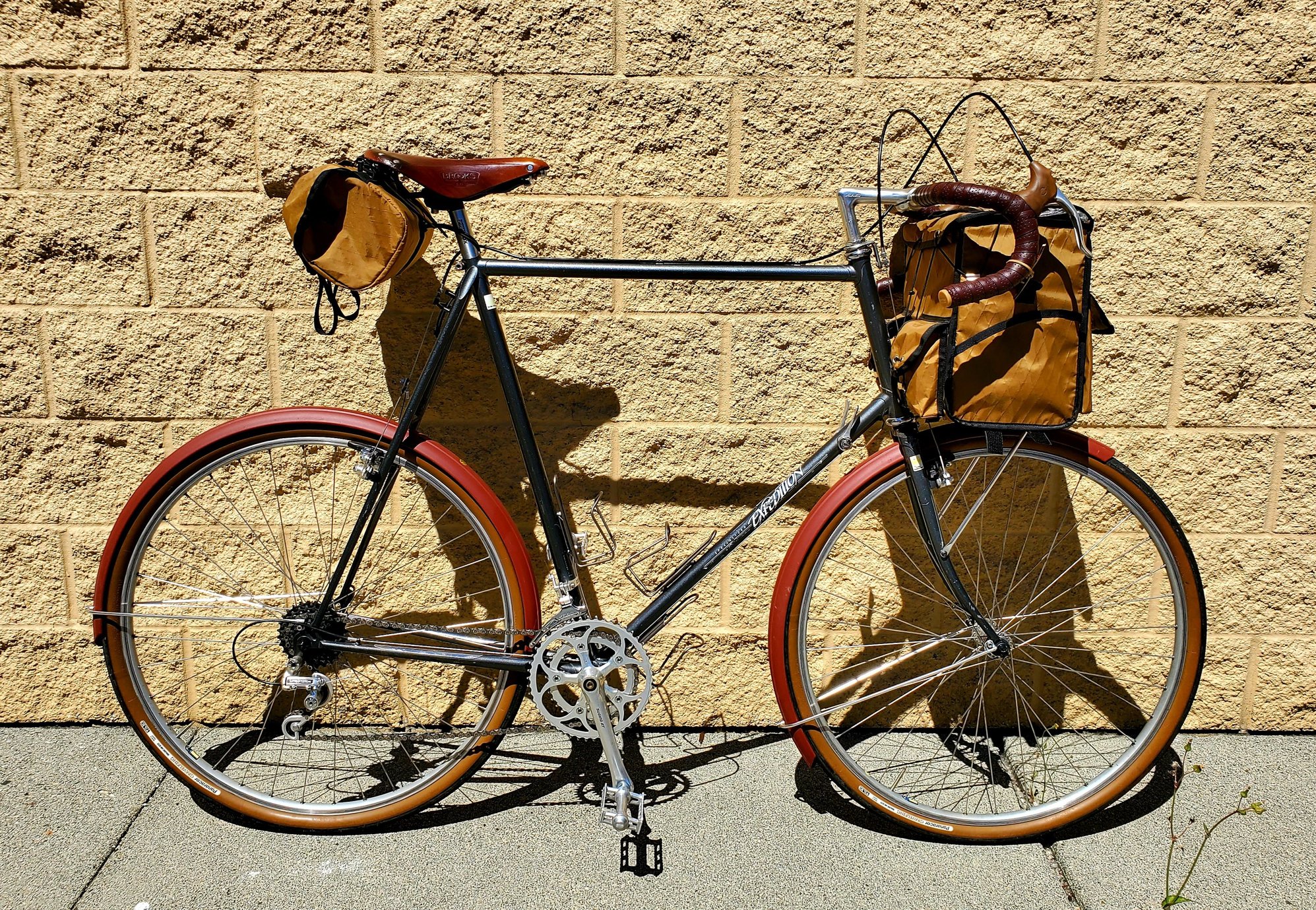

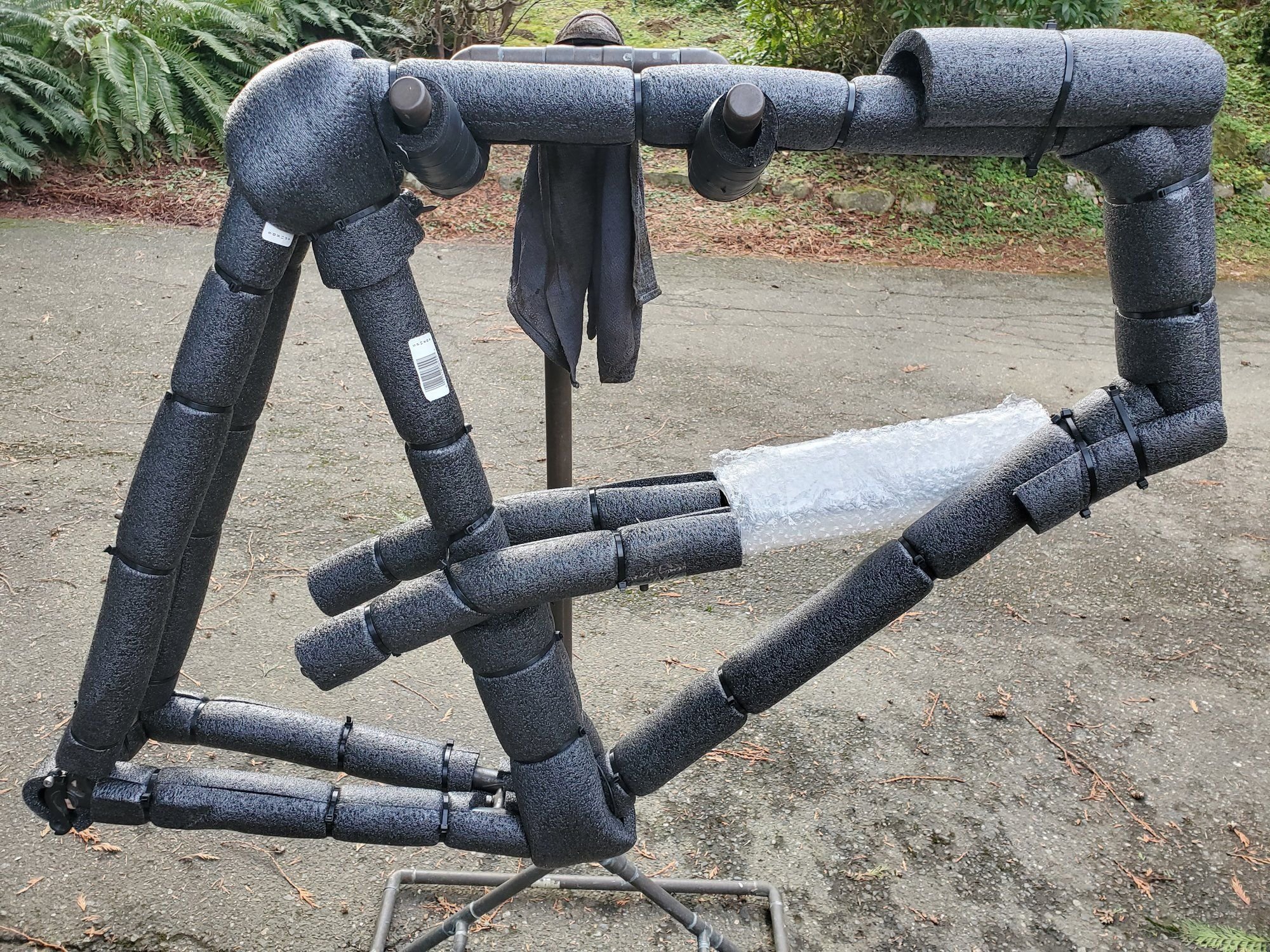

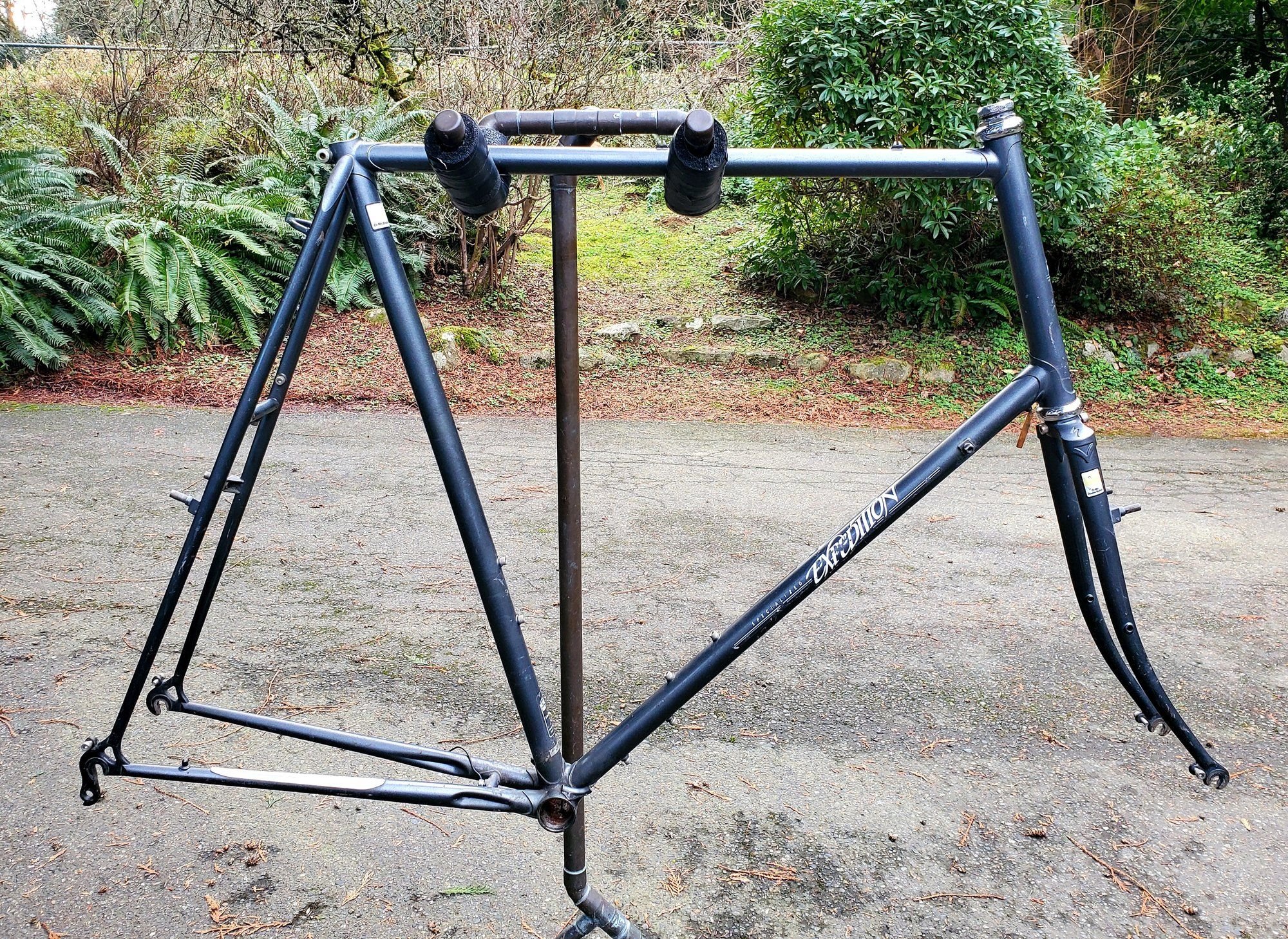

I received this frameset from a forum member over the winter
Built up with parts I had on hand, as well as a few things I had to source. 1984 Expedition.

That is so classy, wow

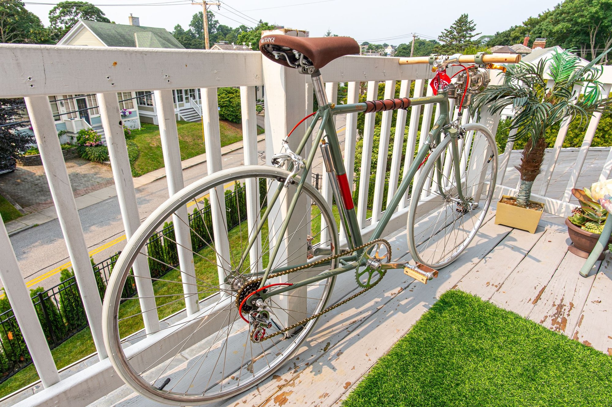

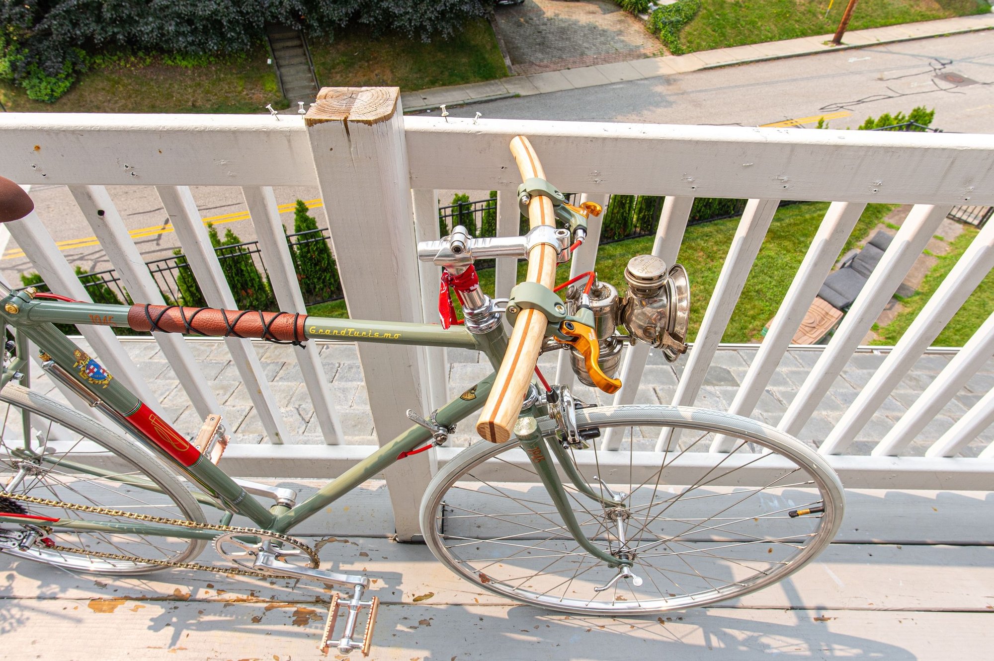

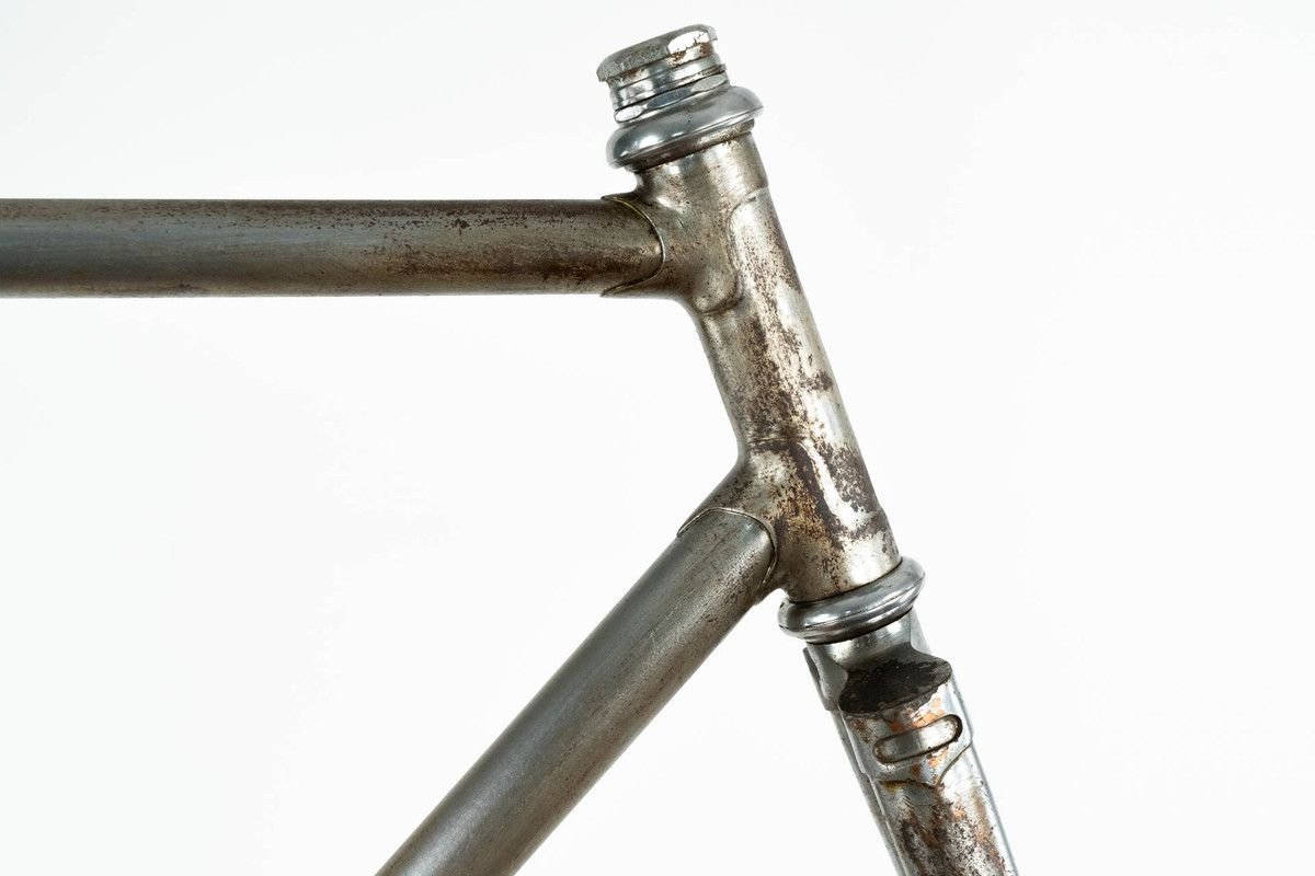

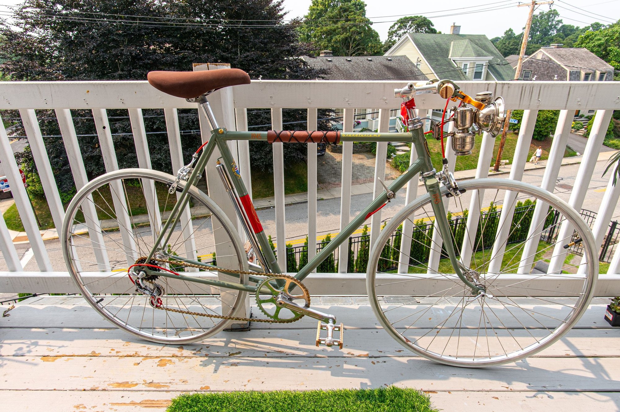

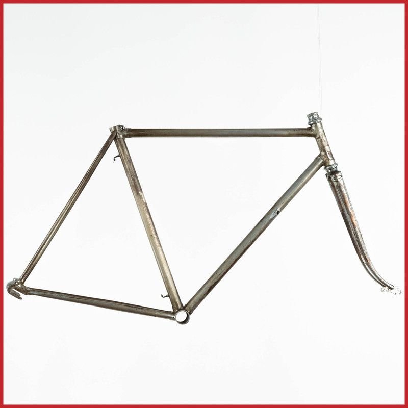

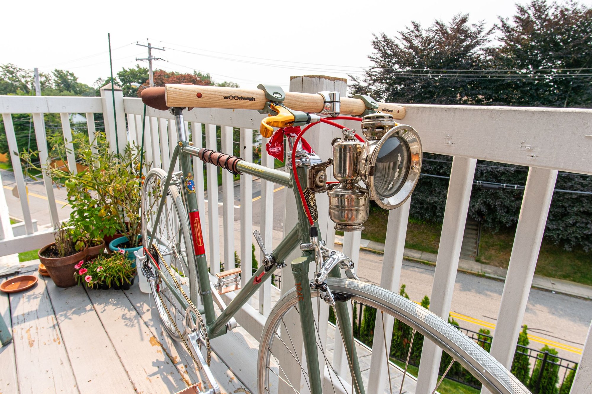

well, finally got some things done on this unknown 40-50's era mystery italian frame in need of love. mostly stuff from the parts bin, with ambrosio rims and cheapo K35 27 inchers, FB brivio hubs, campy single downtube shifter with veloce RD (that may not be a keeper... we'll see). VO cranks and saddle, dura ace BB, dia compe gold finger BMX levers, tektro brakes, and a generous donation of some chain links to make this happen. added a bandana on the stem and some innocuous grand turismo left over decals so it can have a name! just need to tighten things up and add some cable end crimps, and it's off for a test ride. i'd like to organize some vintage bike rides in my Newport area this fall, so had this in mind for making this bike. (like i needed an excuse!)
from art bikes... no idea for the manufacturer
frame.

The lamp on the front is incredible cocoabeachcrab

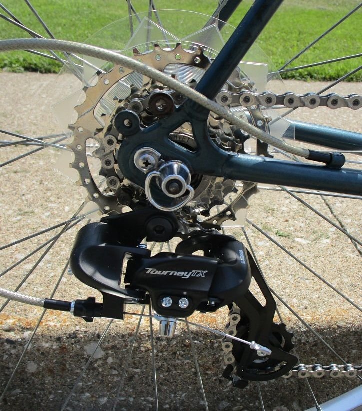

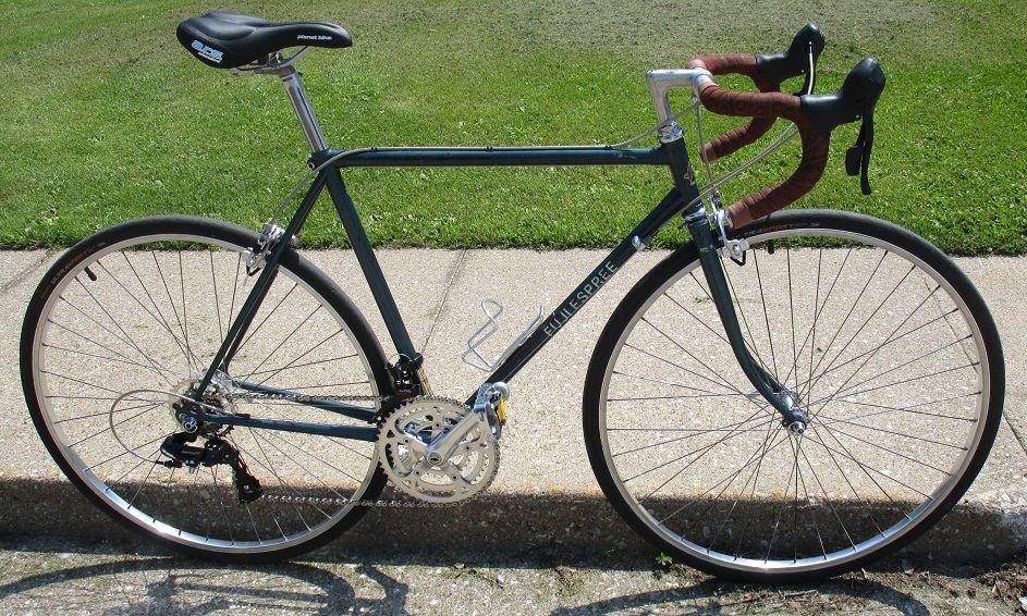

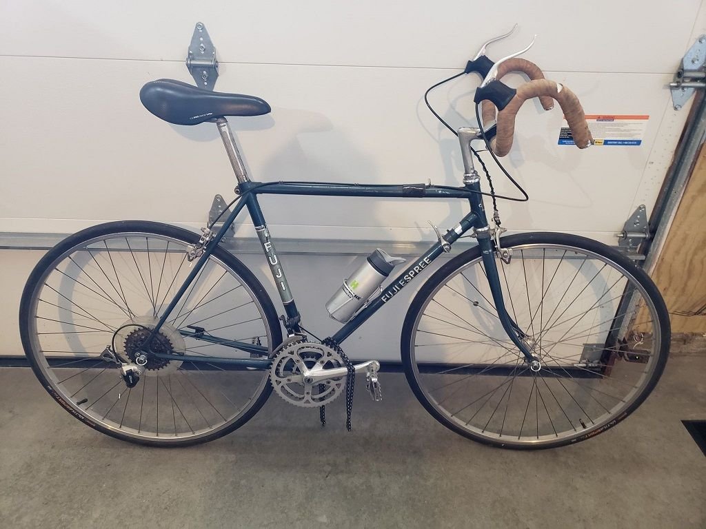

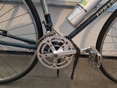

I did this 1985 Fuji Espree for a lady who bought it new in 1985 then rode it on 4 consecutive full RAGBRAI rides and 2 partials. She bought a new bike and the Fuji got borrowed by kids and shuffled to the back of the garage over the years. she gave me the bike with the condition that she got first chance to buy it back it back but then told ne to go ahead and sell it but she'd like pictures when it was done. As she and her husband were leaving he slipped me his number and said he'd buy it back when it was done and do whatever it needed and make any improvements I thought she'd like. I made some upgrades for her like the brifters and replaced the 6 speed freewheel with a 7 speed. I cleaned the rust and clearcoated the frame and fork but didn't do any paint touchup. She wanted to keep all the scratches as they were part of the bikes history. Every piece was cleaned and polished, all bearings cleaned and regreased.
We sprung the surprise tonight, she was totally surprised and thrilled.
BEFORE:
AFTER:

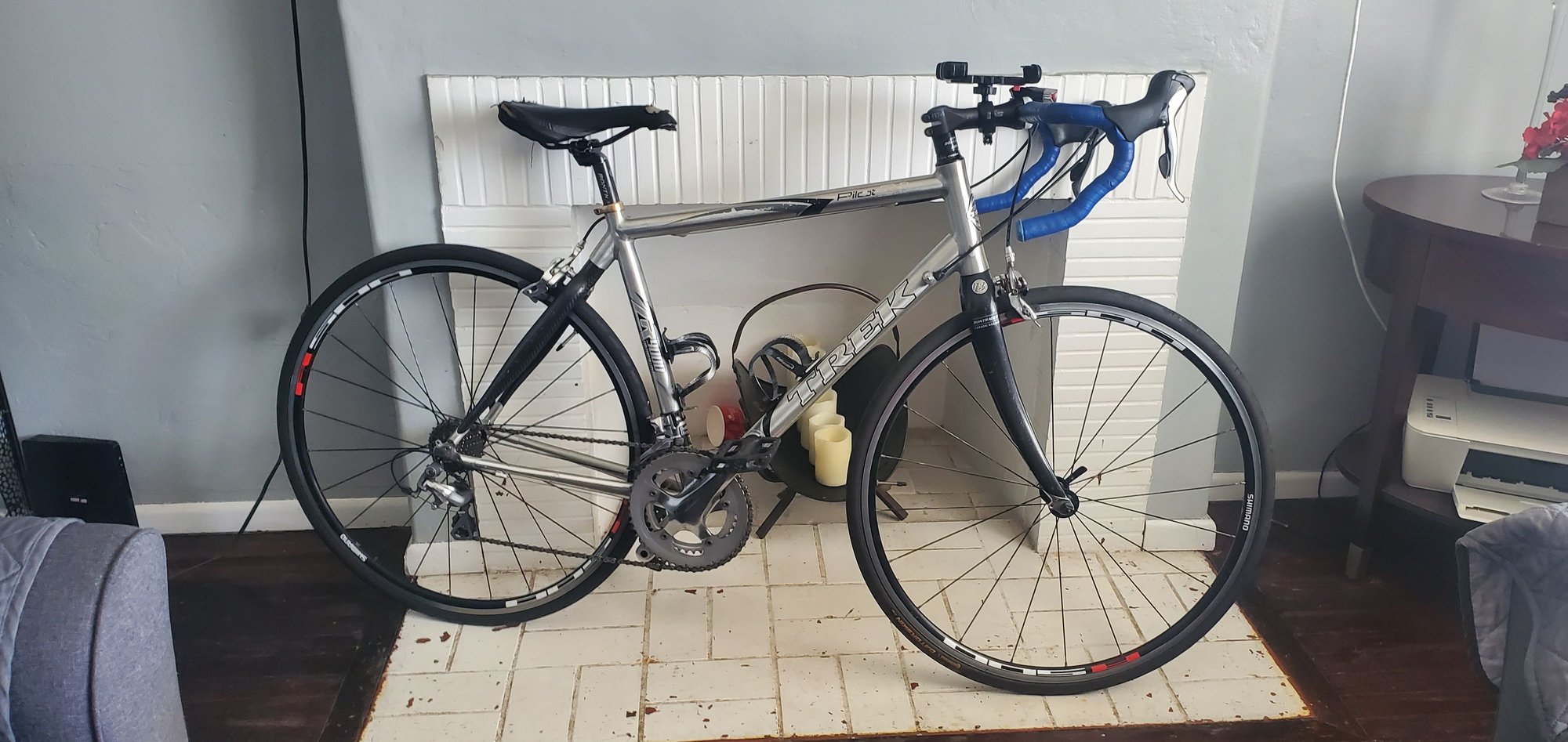

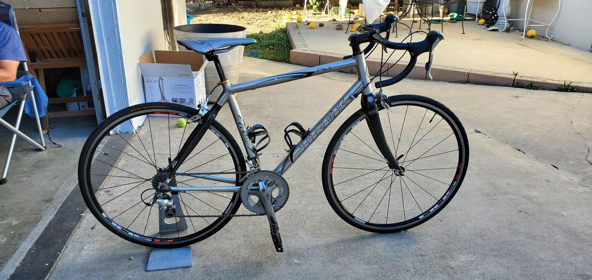

This Trek came back to me after 11 years since building it for a friend who had a $400 budget.
Before
After.
