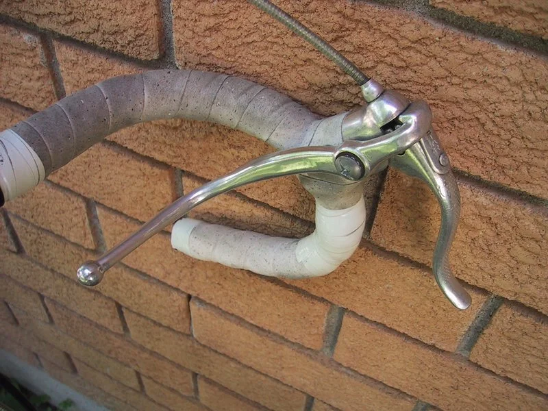

Liked 1,822 Times in 1,051 Posts
Originally Posted by Mr. 66 View Post
What's a bike safety lever?
These things, also known as turkey wings. They bend heavily when used and barely work.
The brake manufacturers probably came up with this first, but the acceptance of the term "safety lever" is just (another) boondoggle from safety nannies busying themselves with bicycle-related matters they don't understand and shouldn't have screwed with.
The only safe alternative to this came about when the cyclocross interrupter lever was invented.
-Kurt

They were introduced in Europe in the late sixties, I believe, on touring bikes. They add the benefits of the Guidonnet levers, which were popular in France, to the traditional drop bar levers. They appeared here on pretty much all demi-course machines in the early seventies.
The Weinmann version, and with that the Dia Compe and early Shimano copies, would flex a lot, which kind of ruined an otherwise good concept. The CLB versions, which used a secondary lever with a T-profile, flexed less and were nicer. Shimano and Altenburger later made versions with secondary levers made from steel plate, which - finally - worked the way they should.
However, like the others, they still rely on the right handlebar shape and being mounted at the correct angle. I spent a lot of time last year trying out various levers, bars and mounting positions, but I did come up with a combination that works really well.
WIN "Winpista" handlebars with Shimano DEL-80 levers. I say they work even better from the tops than from the drops:

Nubuo Ozaki, assignor to Yoshigai Kikai Kinzoku (Dia-Compe) filed the USA patent application for their brake safety level in October 1966 and it was granted in October 1968. The patent may have been filed slightly earlier in Japan.
Thank you! I thought it was a Weinmann design. Apparently it wasn't.
It's always been my understanding that Weinmann wanted the safety lever and that it resulted in a reciprocal technology exchange between the two companies. However, I also thought this took place in 1963. There are reportedly 1964 Japanese catalogs with products labelled as Dia-Weinmann (see attached). So, maybe the levers date back slightly further in Japan or maybe they weren't the reason behind the relationship between the two companies.
