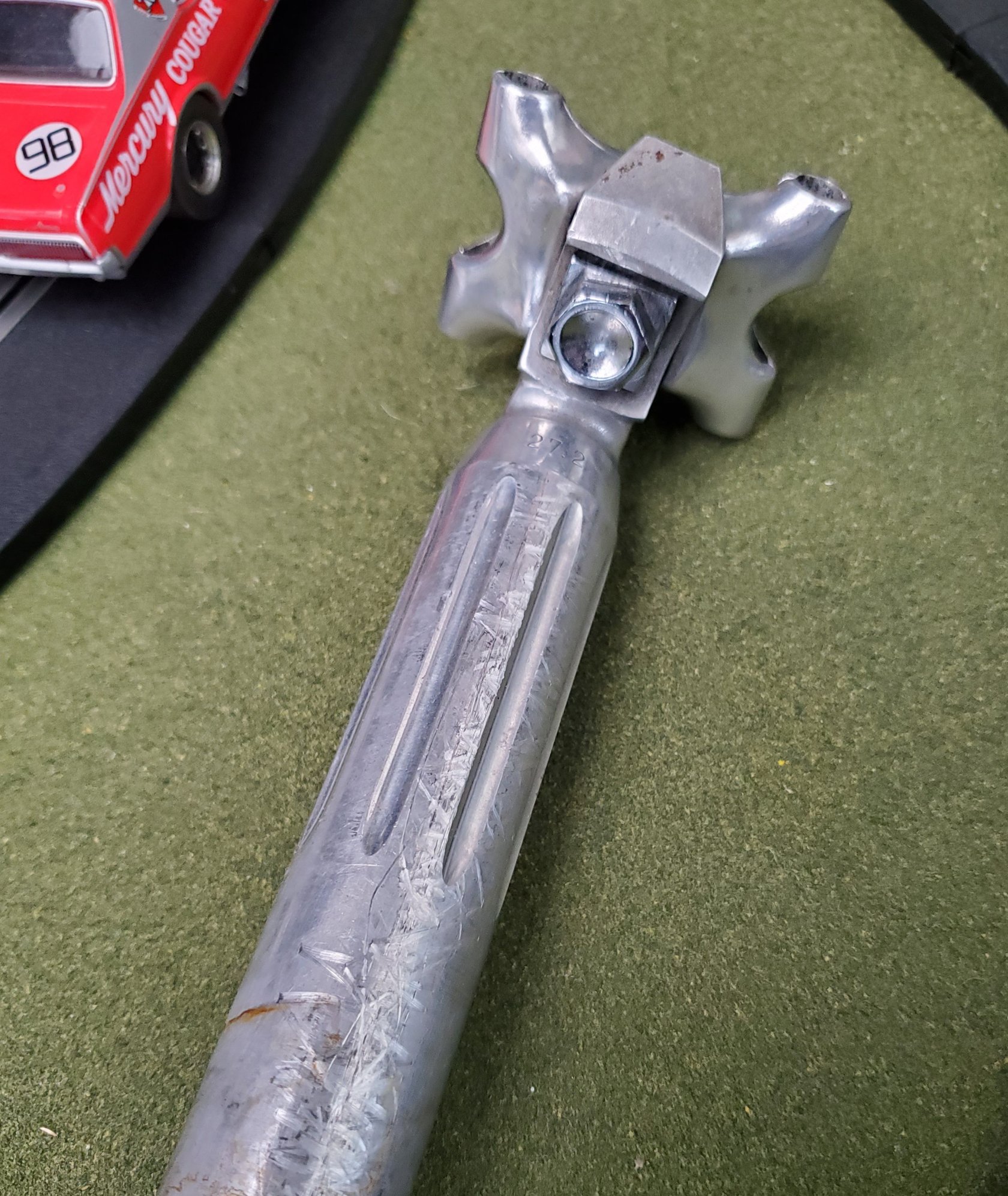

What's everyones preference for getting rid of the zigzag? Is there a dedicated thread for this that I'm not finding?
I have a Super Record seatpost that is marked up, but nothing too deep. I haven't tried to polish it yet, but I'd guess that some Mothers will remove part of the damage.
Thanks in advance for any help on this.

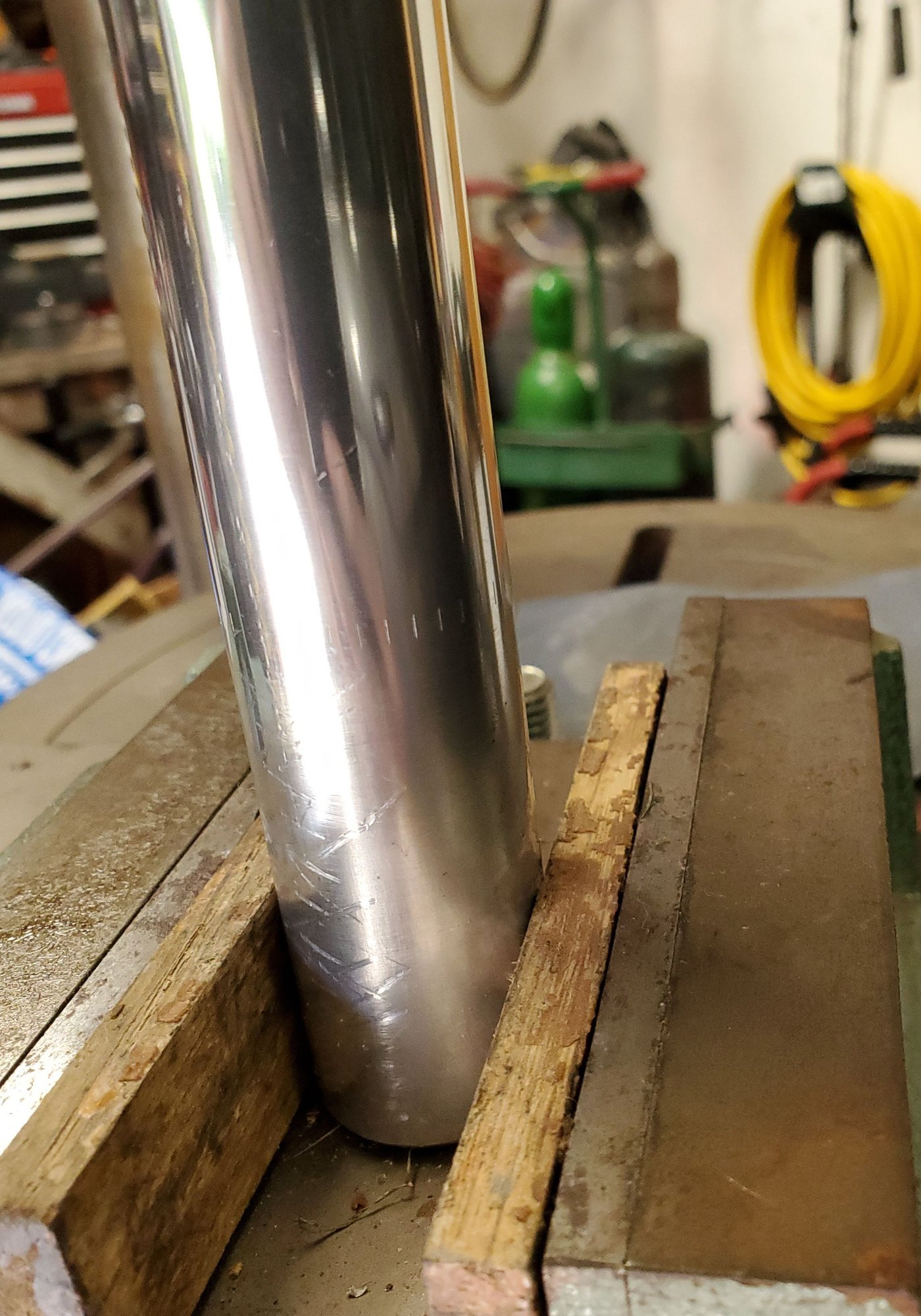

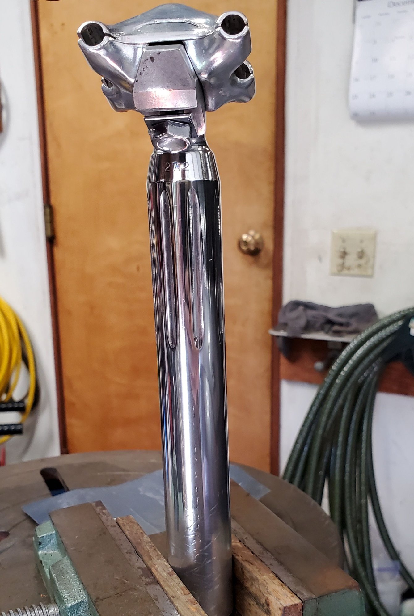

Old 06-07-21, 05:52 PM
Roger M
Location: Snohomish, WA.
Posts: 2,866
Quoted: 469 Post(s)
Liked 2,442 Times in 646 Posts
The "before" shot
Update:
I was going to pitch it, after Charles said it was too far gone...
However, I took the advice from some of you here and set about trying to save it. I used materials that I have(meaning: too lazy to go to the hardware store).
Sandpaper: 500/1000/1200
Mothers mag/aluminum polish
I wet sanded the **** out of the backside of the post with 500. I didn't take all of the marks out because they were deep(didn't want to remove too much material).Then I hit everything above the min. line with 1000 and then 1200.
A soft towel and Mothers finished it off. It is no show piece, but will make a nice rider for my blue bike.
Thanks again for the help.

Old 06-07-21, 07:55 PM
randyjawa
randyjawa's Avatar
Posts: 11,674
Mentioned: 210 Post(s)
Quoted: 1372 Post(s)
Liked 1,748 Times in 937 Posts
When cleaning up a zig zaged seat post, it is important maintain round. Put another way, as you file, sand and polish the post, take the time, using a set of Vernier calipers to ensure that the post is still round and the same diameter, top to bottom. If, however, you file, sand and polish only the section that remains visible, round is no longer as important.
