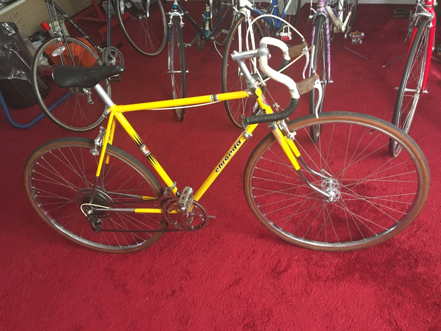

Anyone ever heard of the "Clara" brand? Made in Italy, has just enough Campy on it to bait the hook for a prospective buyer. I suspect it was a 70's bike shop house brand, other than having some Campy bits it looks pretty entry level otherwise but I think it will clean up well. Whatever it is, it's mine now, for better or worse. It checked the "obscure" box, the "my size" box, the "I don't have an orange road bike" box and the "price isn't too crazy" box so I took a gamble on it. If nothing else it will look good next to the Gitane Interclub and Nissan Cherry.

Ouch on that left brake lever cable...and a left handed rider set up?
very cool looking...

In Italy that is how bikes are set up, brake-wise: left-rear, right-front.
+1 on the cool looks. I like it! Looking forward to seeing it cleaned up.

Apparently Clara is not a well-known brand or shop, so it may well be a product from one of the larger Italian manufacturers, in which case juvela may be able to help us.

Thanks guys, it was another one of those sittin' in the car in the parking lot at work before I went in browsing Marketplace things, I fought off the urge for a full 90 minutes this time though. So far the past few weeks those have paid off in spades but my luck has to be running out, I just hope this one isn't it LOL. It's coming out of NY so I won't lay hands on it until next week sometime. Not diggin' the steel wheels and 3 piece hubs too much, I think it at least deserves some better wheels but otherwise I'm not going to change much other than consumables and that saddle. Might be a good home for the Ambrosio hookless clinchers and RFG hubs that came on Carlton. He's gettin' the 600 high flange hubs and Araya rims that came on the Volkscycle with the full 600 Arabesque group along with the rest of the Arabesque. I think this acquisition is the cork in the bottle on any more bike buying though. I have a lot of bikes to get done!
Trying to figure out that crankset, the closest I could find so far was a Solida but it wasn't quite an exact match.

While this is pretty typical of a boom era, upper entry level, Italian marque, I can appreciate why the Molteni orange would add some extra appeal. I'm getting a Bianchi-Chiorda vibe but that may just be the seat tube banding and Agrati lugs. Serial number?
I'll ask the seller to send it if he hasn't packed it yet.
He'll send it in tomorrow along with more pictures, he said he'd really like to know what it's roots are as well.
Pulled up pics of 70's Chiordas and I think you called it right out of the gate. Wonder who sold "Clara" branded bikes. It's currently in NY so an East Coast shop I presume.but then I've had some "well traveled" bikes.

I'm convinced, Clara is a Chiorda in disguise.
Now..... where did she come from? Anyone recognize this?

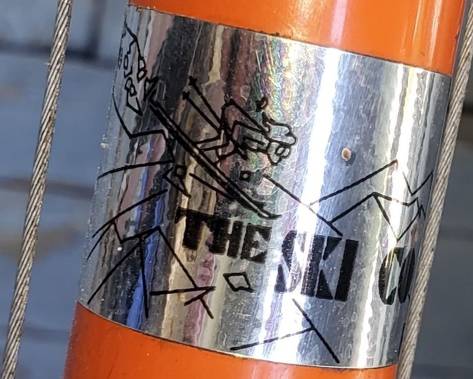

Fingers crossed Clara is currently in the custody of Fed Ex.
I found a website for "The Ski Company" in Rochester, NY and sent them a message with a pic of the label to see if it's the same place.

frame -
constructed with Agrati "AM" pattern lug set nr. 000.8040/E/U
upper head lug item nr. 000.8044
lower head lug item nr. 000.8043
seat lug item nr. 005.8049
bottom bracket shell nr. 022.8307
crown - cannot see clearly eno' for positive id
dropouts - Agrati nr. 000.8002
fork ends - Agrati nr. 000.8010
these features raise frame above the Chiorda base -
a) constructed with true three-piece head rather than bulge-formed
b) tubular seat stay bridge rather than plate style (chain stay bridge does appear to be plate style)
c) half chrome blades and stays
d) chrome crown
fittings -
Agrati chainset and headset - not shown clearly enough for model id
3TTT Tourist stem/bar set

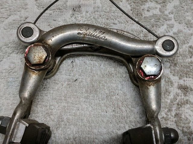

economy Balilla centrepull brakeset; note that in this arrangement there is no provision for a quick release
do not recognise pedals; "usually" these come with Sheffield 655 or 665
let us know if you discover a marking on dustcover or barrel

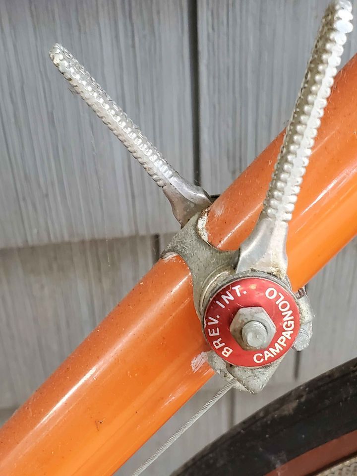

most interesting fitting is the Campag shift lever set; these date from the mid-1960's and were produced in several variations; they appear in no catalogue from the manufacturer suggesting they may have been produced for OEM use only; began a discussion thread on them here: https://www.bikeforums.net/classic-v...a-experts.html
they were superseded with the launch of the Valentino gear ensemble which makes me think the bicycle could date from the late 1960's rather than the early 1970's, although both clear possibilities...
its presence may represent a case of using up old stock
wheel rims may be Maccari
​​​​​only spot you might encounter a date marking would be the gear block, the manufacturer usually employed Regina, though there may be some with CAIMI as well
like others, would expect marque to turn out to be the creation of an importer or retailer
"dollars to donuts" the Clara name comes from a wife or daughter
hope you enjoy lots of good fun with this new pony in the stable!

Wow, great info juvela ! Thank you!!! An importer or shop brand was my first thought. From the pics the decals look 70's, they're printed on clear adhesive film. I'm guessing applied by the retailer.
I found a pic of a VERY similar bike carrying the brand name "Gloria" in the "bikes no one else has" thread. Maybe Gloria and Clara were an attempt on cashing in on the "Stella" marque? BTW Clara means bright or clear in Latin. Maybe a play on that.
UPDATE: After very brief investigation it appears my theory about "Gloria" bikes is grossly incorrect LOL. It was it's own brand and several levels above poor Clara.

chainset note -
when you have Clara to hand one check you can make is the bottom bracket spindle
its centre section may carry a marking
some of the possibilities include:
a) "57" - indicating the distance in mm between the bearing shoulders
b) "C" - indicating "corsa", i.e. designed to be used with a two plateau drive train
c) "OMG" in an oval recess for Of.Me.Ga./OFMEGA - Officine Meccaniche Giostra
d) "AGRATI" in a small block letter font
wrt transfers -
keep in mind the possibility they may have been applied here
not suggesting this is the case, just a possibility

Those shift levers were being spec'd as late as 1974. The metal hex nut is a replacement for the OEM plastic wingnuts that looked like Mickey Mouse beanies. The friction plate did not hold it's setting well, causing the lever to slip and resulting in unexpected shifts. Tightening down the wingnuts more only caused them to crack.
We got these shift levers on our 1974 Chiorda shipments. We only carried Chiorda for that one year and I refused to stock them when I took over as manager at the end of the season. Also, the subject bicycle appears to have the Extra version of the Valentino rear derailleur, suggesting it is no older than 1969. Based on the serial number, I suspect it is 1971-1972.

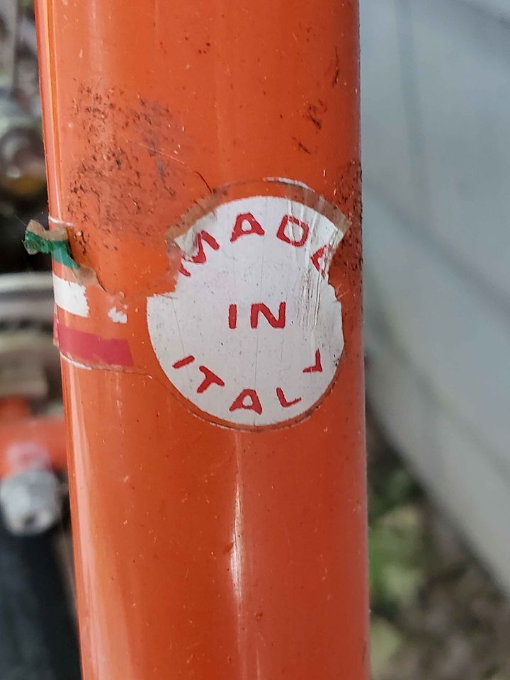

Somehow, juvela you made me laugh... OMG on a bottom bracket is funny! It should be stamped on all of my “saved” bikes!
and I have been trying to place the orange...it is creamsickle! Clara Creamsickle!

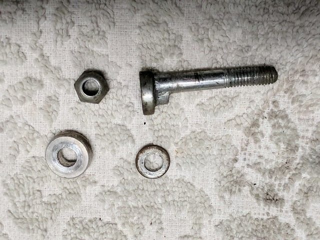

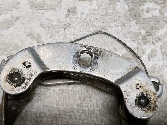

MM -
in case you have not previously had occasion to work with Balilla centrepull brakes they have a feature which permits them to be dual reach, i.e. they can be mounted to give two different reaches
the hole in the backing plate to accept the mounting bolt is a vertical oval rather than the usual circle
the head of the mounting bolt is asymmetrical with a lobe on one side
the head can be mounted such that the lobe is either upward or downward
searched for years to locate good images of the arrangement an just found these posted by member Skip Montanaro last fall...

MM -
in case you have not previously had occasion to work with Balilla centrepull brakes they have a feature which permits them to be dual reach, i.e. they can be mounted to give two different reaches.............
I hadn't even heard of Ballila before being introduced to Carla! Pretty neat feature.
