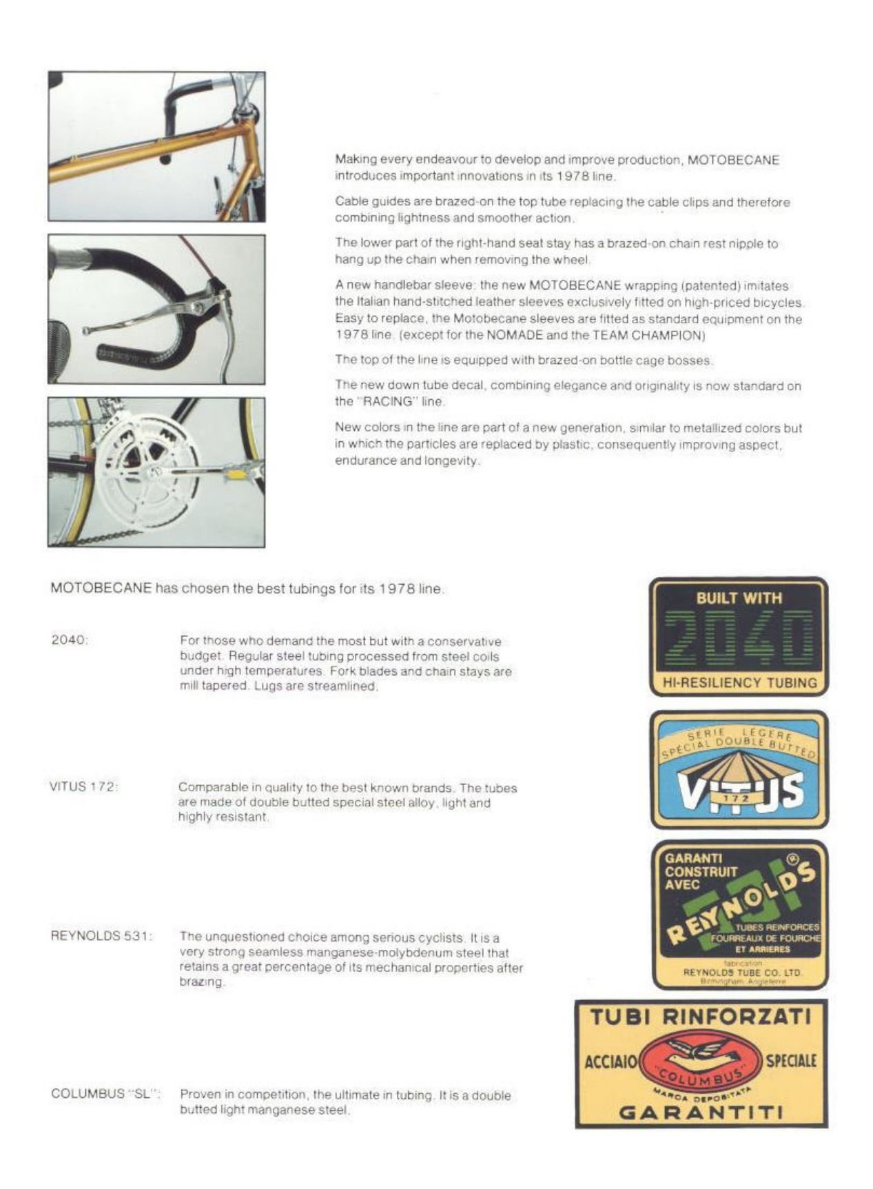

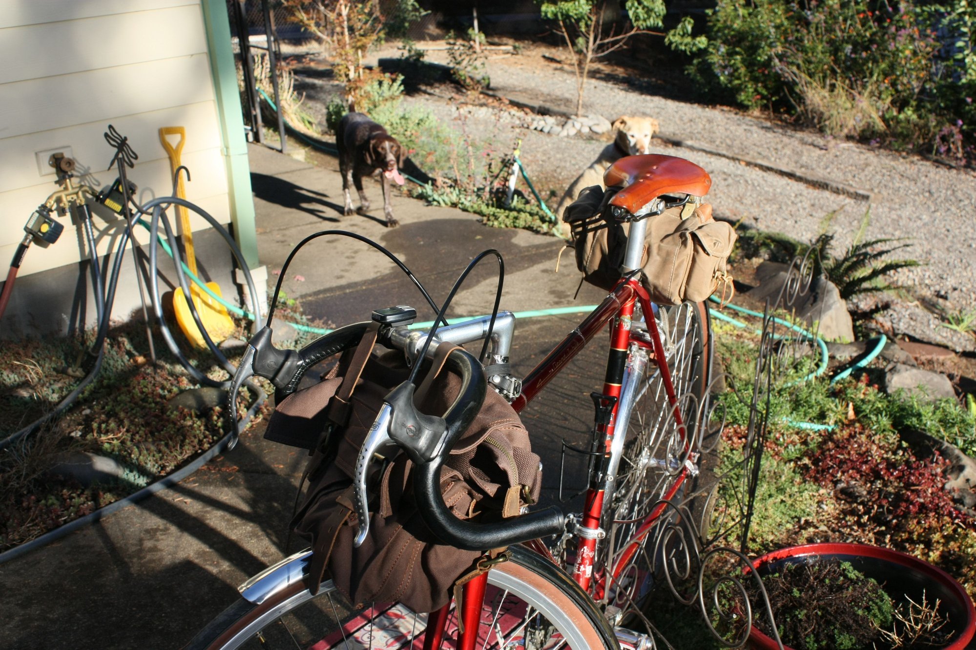

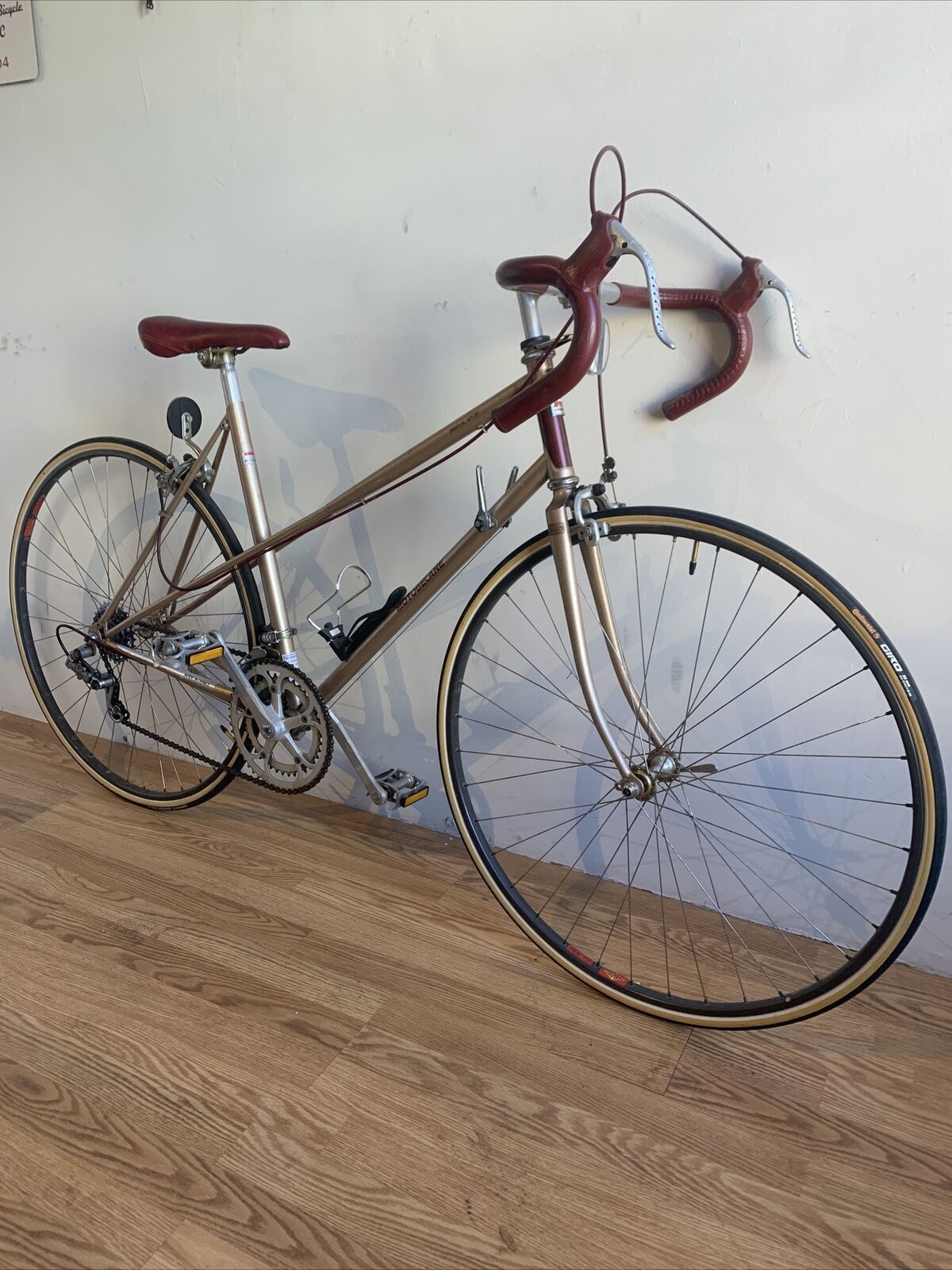

Cotton tape is about it for a 60's bike but a possible alternative is to find a bar/stem/brake levers set with the "Pleather" bar wrap sleeve Motobecane introduced in 1978. This is what I did a few decades ago when I built up my 1st Grand Jubile from a bare frame. Their Catalog says "easy to replace", but the set I traded for already had its hood portion amputated (by someone who didn't agree) to allow for some Shimano 600 replacement levers with standard rubber hoods. My set has a French 22.0 Balleri stem, but somewhere in late 70's-early 80's Motoecane began phasing in non-French components too. These were produced in large #s and I still see bar sets at swap meets & on eBay so you might find one that fits a standard headset. Don
poor scan of 1978 Catalog
from eBay ad
Mid 70's Grand Jubile

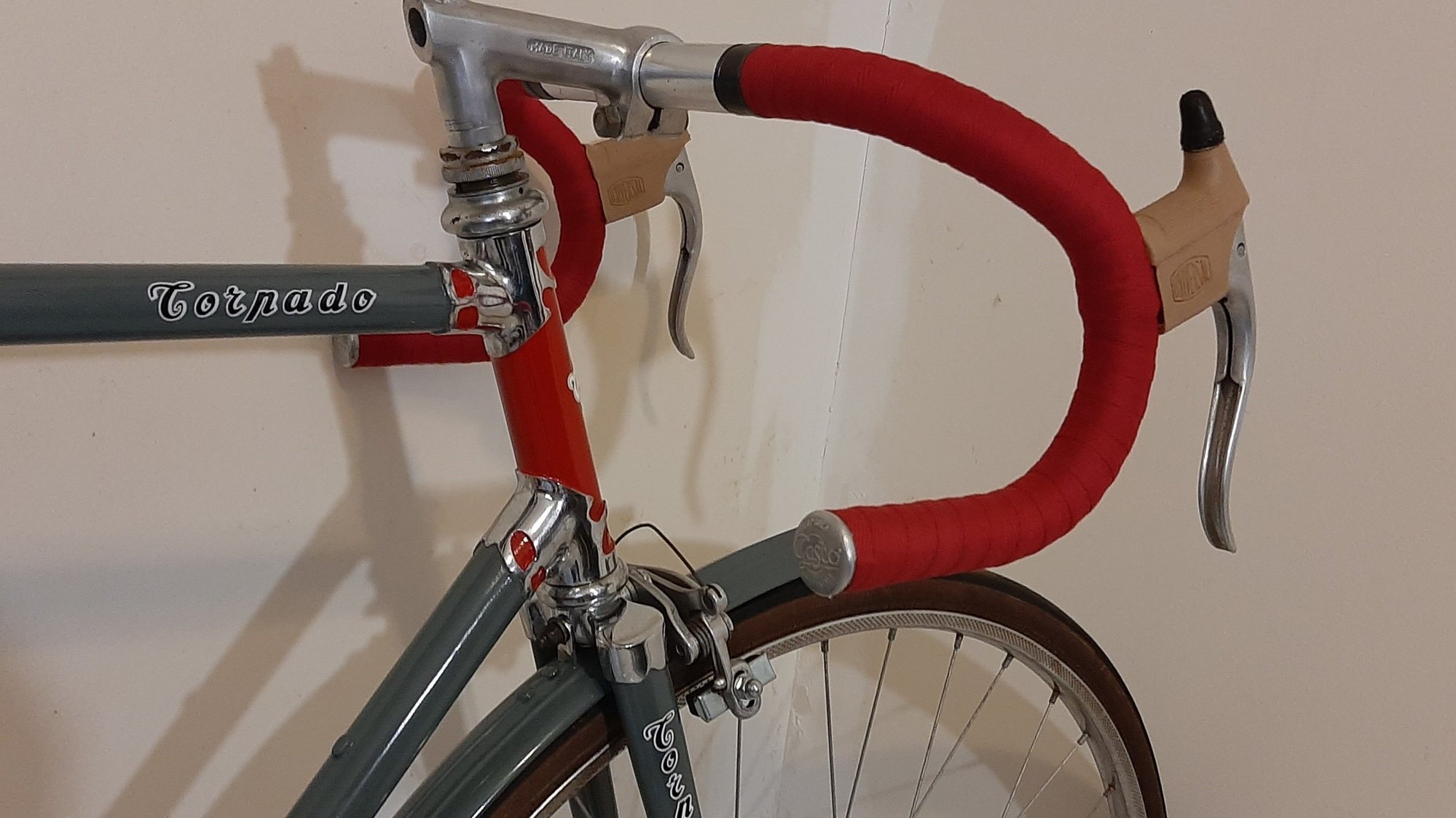

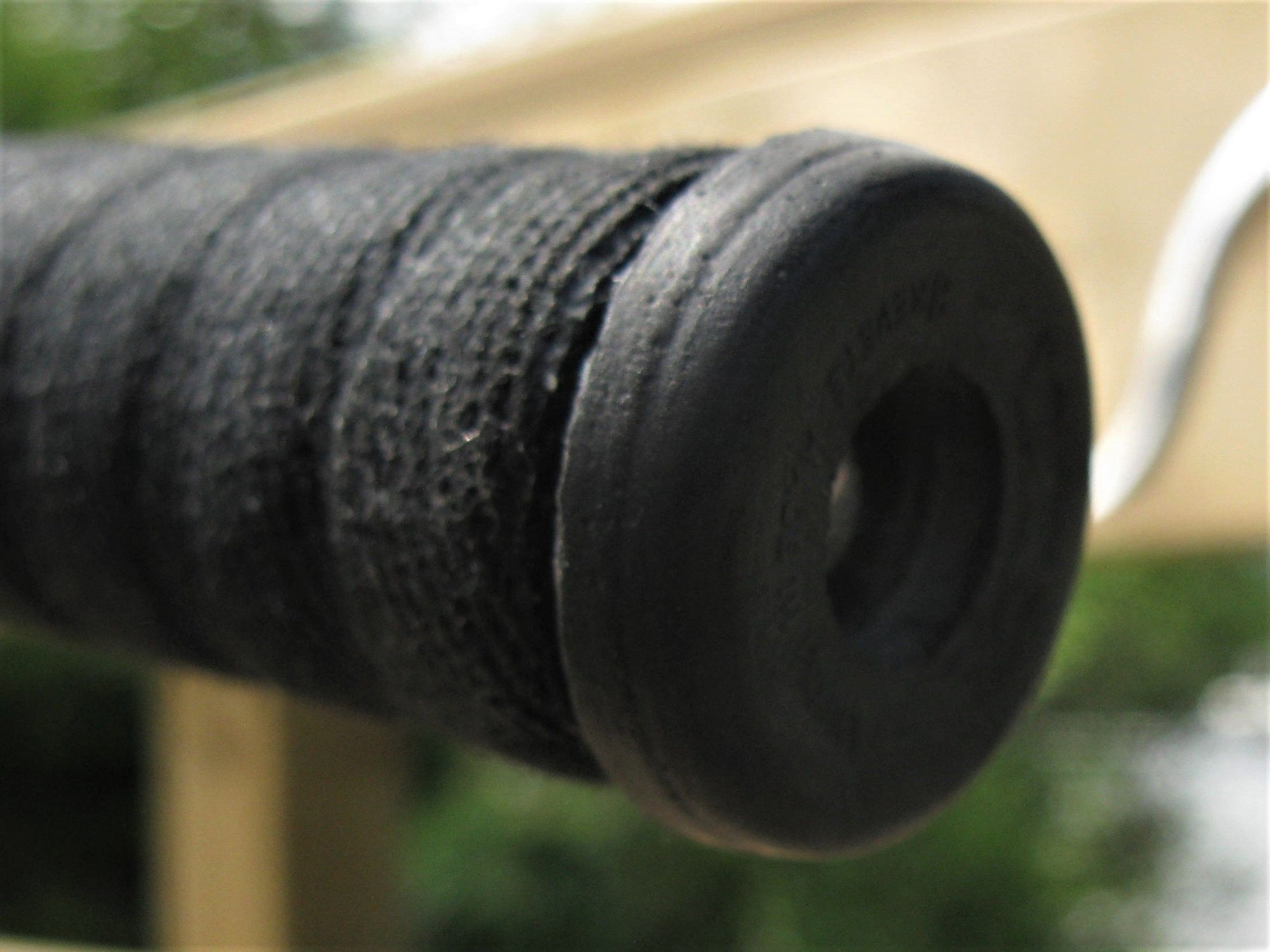

Cotton bar wrap would be just right and period correct for your Legnano. Looks great but the wrap I used was not Gaslo, Cat Eye probably but certainly satisfies my restorative needs. This tape or and other brands are readily available on Ebay for reasonable prices...

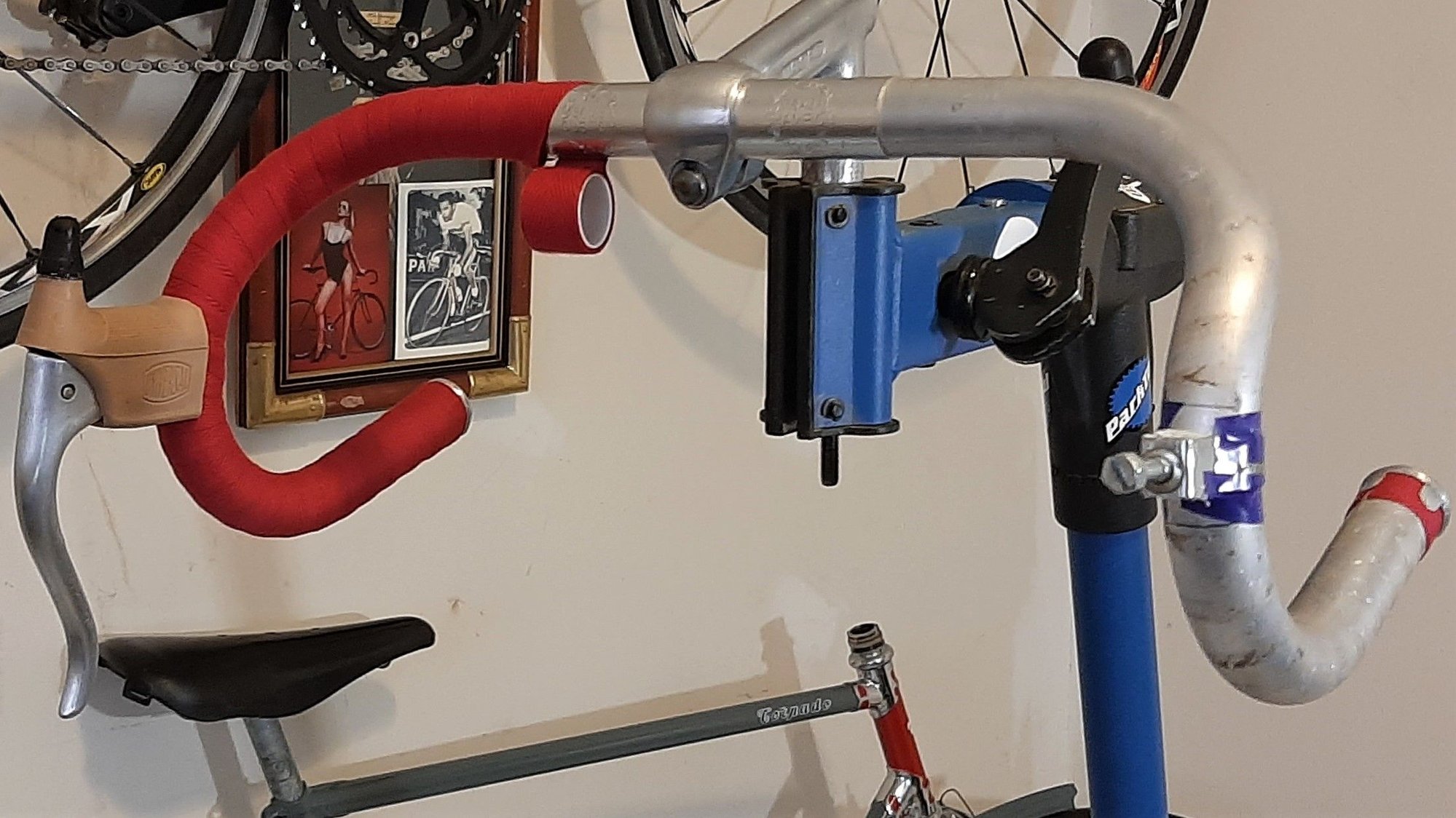

I will offer one warning, the cloth tape is hard to wrap. Particularly around the brake lever mounts. With this in mind, I learned to position my levers exactly where I want them then use PVC tape to hold them in place. It is also necessary to use silicone seal to secure the mounting nuts in place. I wedge a piece of foam in place to keep the nut in place while the silicone sets up. Once set-up, wrap away, starting from the handlebar end for Galso or from the middle for Velox caps...

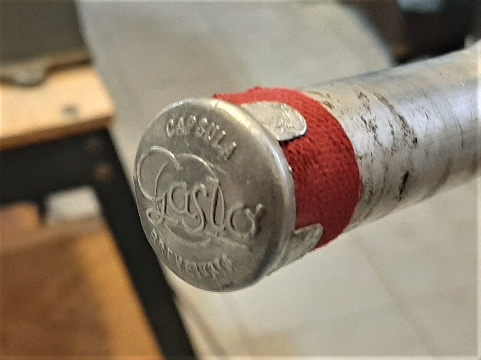

This procedure would be just right for your Legnano and this set-up even has the Gaslo endcaps. The caps do not fit inside the handlebar, they fit on the outside. A wrap of cloth tape under the tabs helps hold them in place for the wrap job. Looks great but the wrap was not Gaslo, Cat Eye probably but certainly satisfies my restorative needs. Look for cloth tape on Ebay and choose what you want...
The Velox end caps are period correct and will not fall out...
Once done, mount your brake lever bodies (hoods are readily available on Ebay - even the cable adjuster hoodies). All in all, the end result looks pretty darn good. And one final tip, though it bugs me to share it - right now there is a set of NOS Gaslo Legnano embossed end caps for sale on Ebay. I cannot afford them so feel free to pay the price to snap them up, if you want,,,

Thanks for the tips randyjawa. I have much cleaning to do on the bike and then start on refreshing/servicing pieces as needed. Your Torpado looks FABULOUS!

Interesting; I always found it the easiest. Flexes laterally to follow contours, and does not slide around while you wrap.
