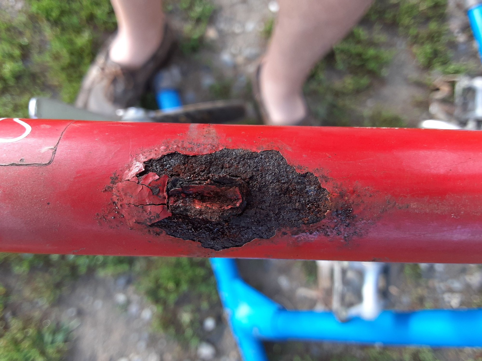

1) don't use a steel frame you care about, the sweat generated on a trainer kills steel frames.....been there......
2) re the trainer . fwiw; I got a used Computrainer for a couple hundred $ a couple yrs ago & love it. If you insist on being connected to the net it won't do it for you.

Originally Posted by top506
Top
yeah, like that but I actually ended up with holes in the chainstays near the bb.
I think the sweat issue depends on how long/how hard. I was doing 45 min 5 days a week as hard as I could-i had puddles on the floor.
I did use a big box fan and as far as trainers are concerned fluid or magnetic are much quieter than the ones that use a fan for the load

I actually use one of my nicer steel bikes so I equip it with a sweat guard, always wear a headband, towel off a lot and point a fan straight at me. For me, the fan and toweling off is key. I sweat a lot but rarely see drops making it to the mat under my trainer. Conversely if I do a spin class, a small person might drown in the pool I leave behind.
