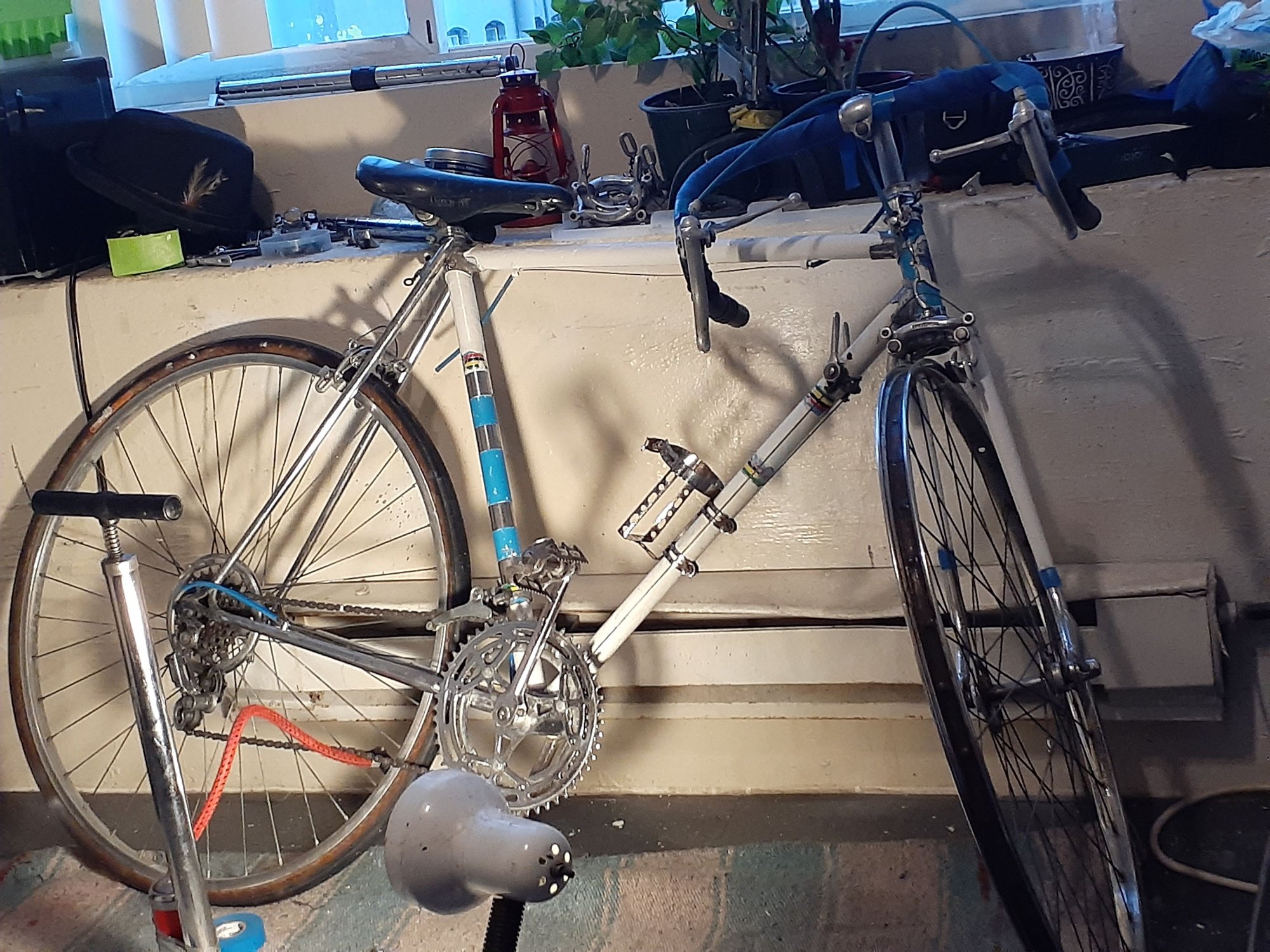

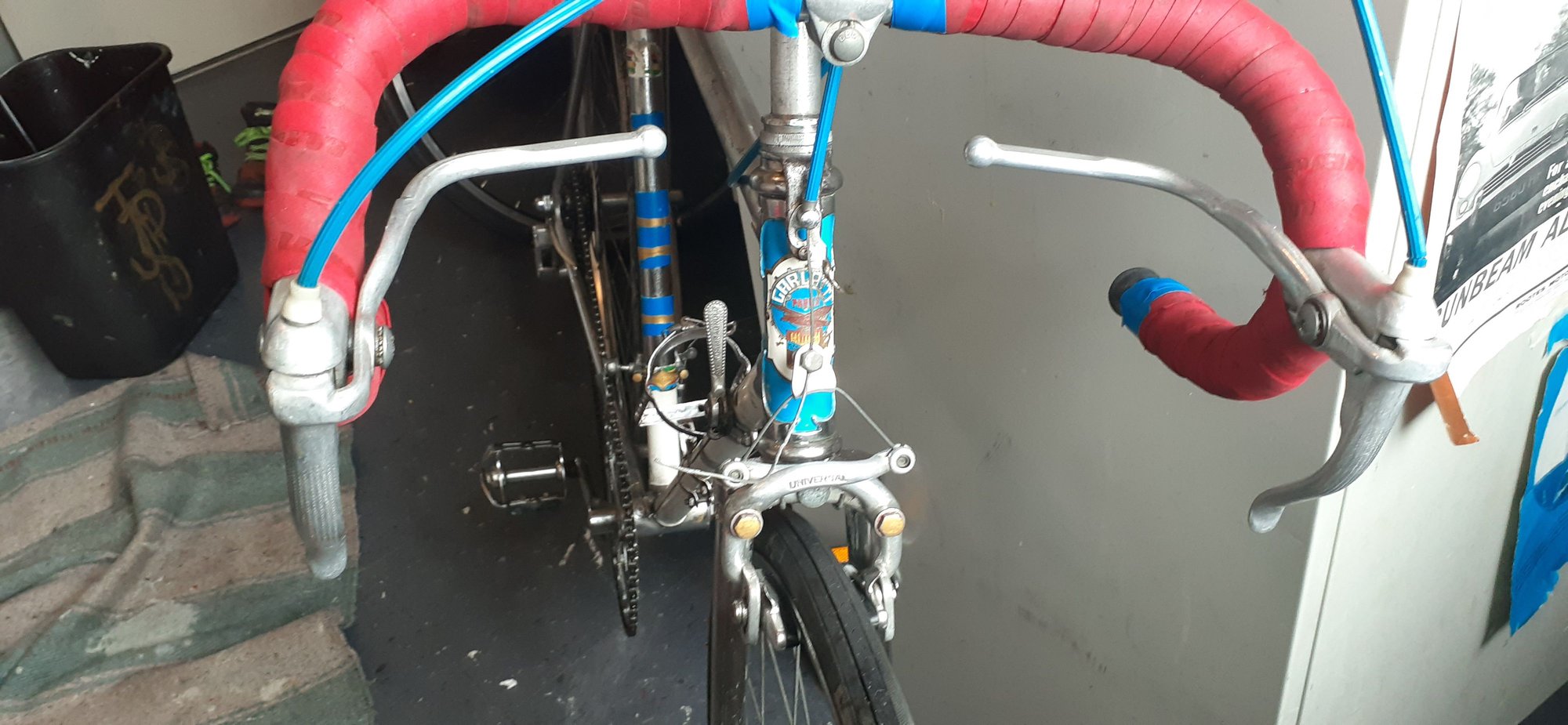

First thing, change the direction of the front brake pad cartridge holders. You have them reversed, and they are unsafe. The opening that allows replacement pads to slide into the holder must be oriented toward the rear of the bike. Second, level the saddle. Third, make absolutely certain that you do not have the stem higher than the minimum insertion mark. Again, for safety. Good luck with your sale.
PM me your cotters

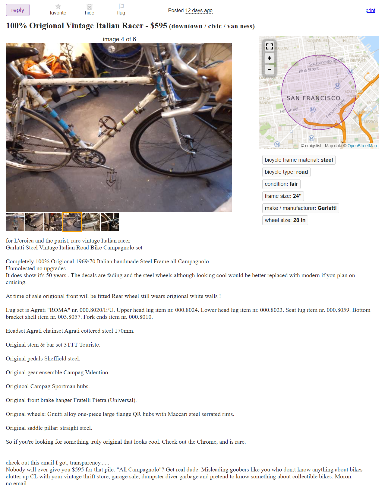

1) The 531 decal on the eBay bike is a sticker - a bike of that era would use a waterslide decal, often under clearcoat. It's not a 531 frame.
2) We know the sticker isn't original to the bike because that design style of Reynolds 531 sticker didn't exist in the era that frame was made
3) eBay is full of con-jobs who do BS like that, putting fake stickers on something, in order to bilk people out of more money
4) The eBay frame, while not listed genuinely, is sadly in much better shape than yours, paint-wise, take it or leave it
5) I dug back: That frame has bene listed no less than 4 iterations, which is a red flag it's overpriced and/or most lookers realize the 531 decals aren't legit
6) eBay is also full over over-inflated garbage and you absolutely CANNOT rely on the prices of active listings; you need to click the "Advanced" link to the right of the search box and click "Sold listings' in the options
I see you've already listed yours, so maybe we'll see how accurate everyone is here: https://www.ebay.com/itm/164761776365
But, still, I've done #6 for you and it appears there are no examples within the last year. Only current examples, with a green one (repaint) nicer than yours sitting with zero bids at $150.
So let's watch the auction to the end - I don't think it'll close higher than $225 w/o a shill. I suspect it'll close in the $175-225 range, tops. I hope, for your wallet's sake, we're all wrong

"but patience please" ... for what?
And why in the world would you put the rude response you got IN the actual sale ad for the bike?? Are you thinking that someone will see that and decide to pay your price because someone else told you it wasn't worth it???

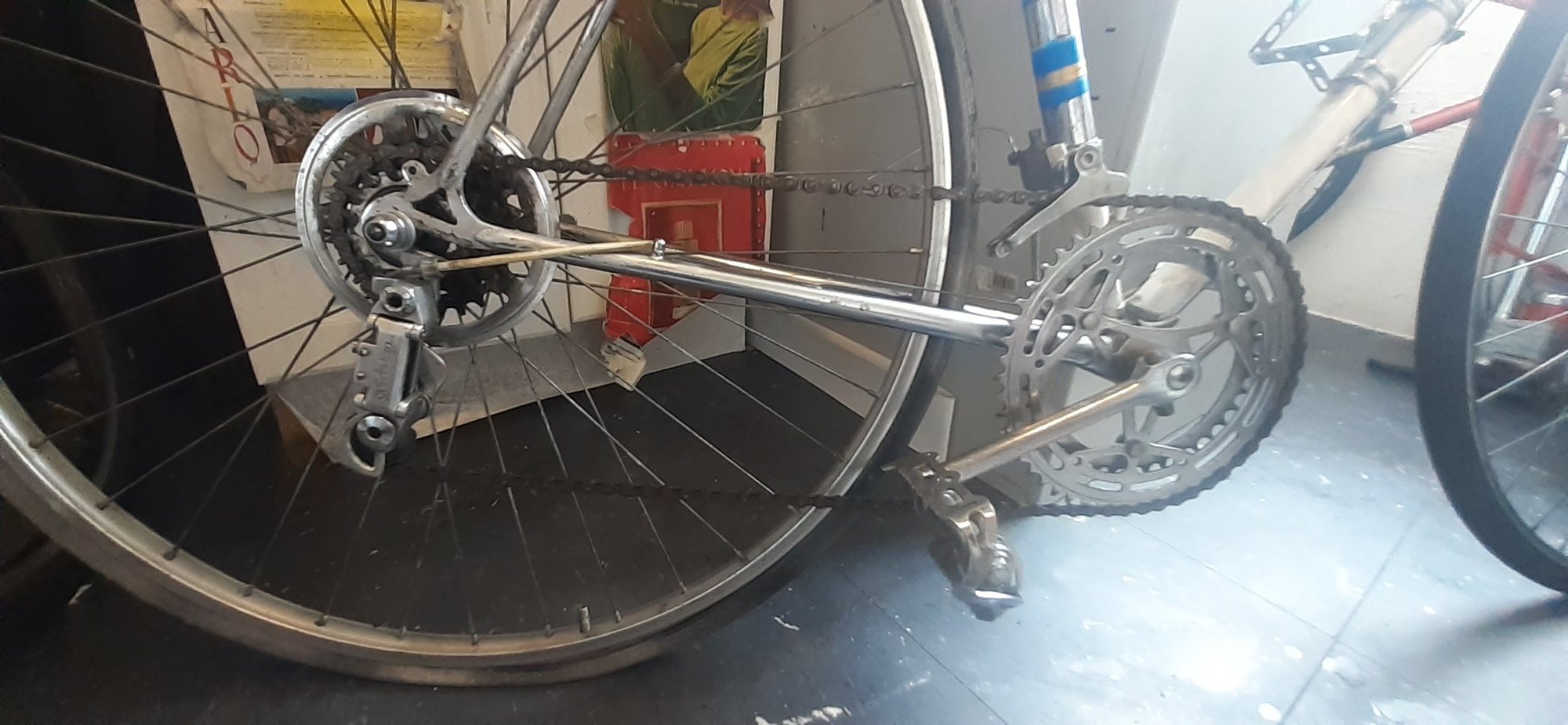

upgraded the rear derailleur put on a newer Camp I'm not sure exactly what model it is new matching pedals which is great good score and then I think the red looks great with the blue in the warrant so not all original anymore. I'm liking it
wa
2k miles from the midwest
Location: Washington
Posts: 1,964
Quoted: 525 Post(s)
Liked 931 Times
446 Posts
Might want to check that rear derailleur housing setup...

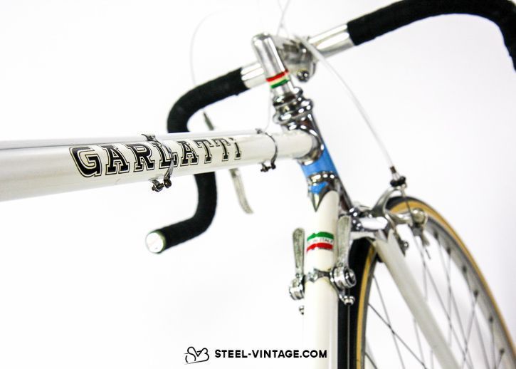

If this is your Garlatti..?
Posts: 17,156
Mentioned: 481 Post(s)
Quoted: 3810 Post(s)
Liked 6,690 Times
2,610 Posts
More Garlatti is the updated version of more cowbell.
Likes For nlerner:
Posts: 11,674
Mentioned: 210 Post(s)
Quoted: 1372 Post(s)
Liked 1,751 Times
938 Posts
The picture I posted is a picture, taken from the thread that he (or she) started - Garlatti Completely Origional...
If he, or she, did end up buying that gem from Vintage Steel Bicycles, I will stand corrected.
