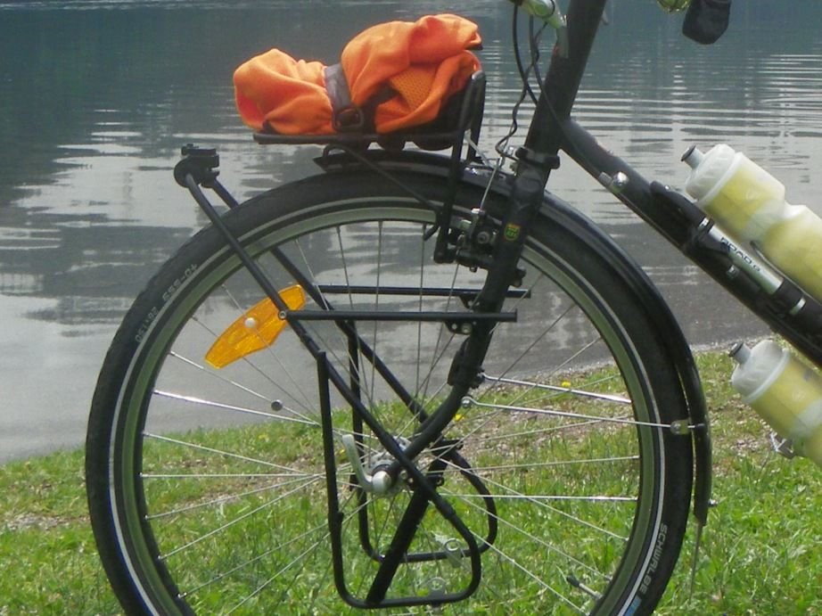

I prefer the ones with a hoop over the top, it just looks more structurally sound to me. I have a Tara on one of my bikes, a Tubus Ergo (discontinued model) on another bike.
There are two kinds of the two piece, the better ones attach to both sides of the fork blade to hold the rack more firmly. The Tubus Duo is an example of one that attaches to both sides of the fork blade to make a stronger rack.
Some forks have only a rack mount on the outside of the fork, not on both sides of the fork blade, that would preclude a rack like the Tubus Duo.
Some of the cheaper racks attach to only one side of the fork. If you crash you are hoping that your rack bolts are strong enough to not break. And if one or both breaks, how do you remove the piece of bolt that is still in the fork?
I had trouble finding a rack I liked for one of my bikes, I ended up buying one of those cheaper racks that only attach at the outside side of the fork. But I made a DIY reinforcement bracket that attached to the rack and the inside of the fork blade.

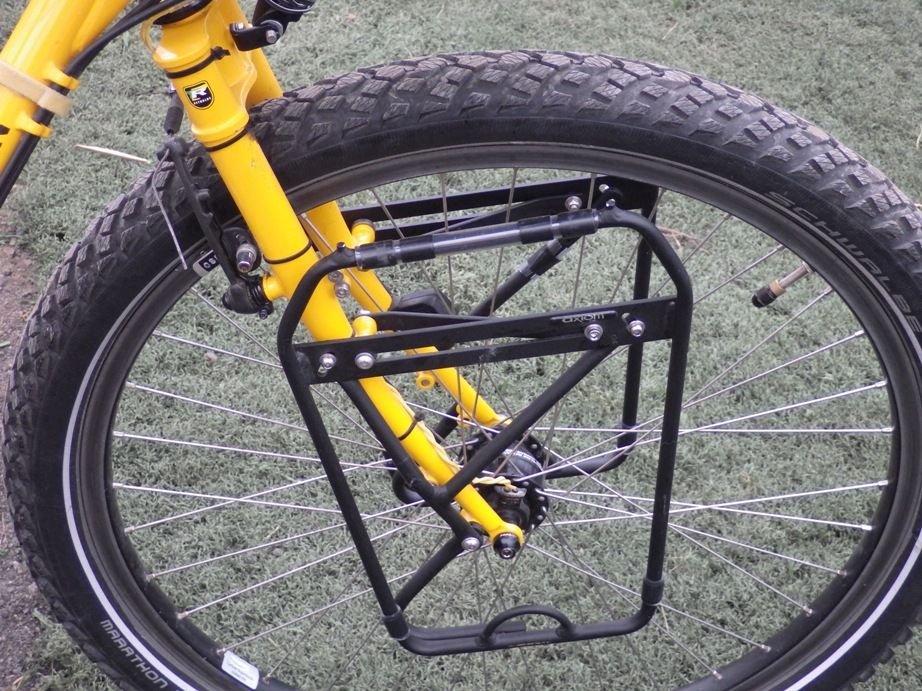

My Tara:

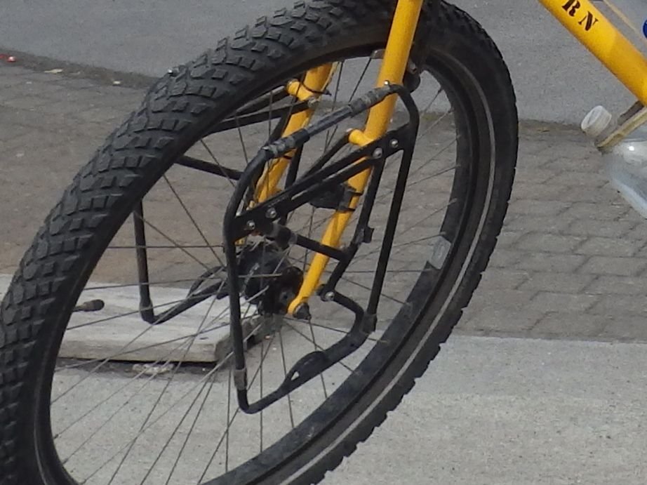

The cheap rack that I bought with the DIY reinforcing brackets that I fabricated for it:
The reinforcing brackets are some steel bar that I had, sprayed them black. That extra reinforcement I think is important if you have this type of rack if you crash.
The yellow bike above has a coupled frame, it is much easier for me to pack the bike for travel with the two piece rack (as noted by Saddlesores). I really did not like that rack very much, but for this bike I wanted to raise my front panniers up higher by several inches, and that rack accomplished that, so that is why I am inclined to overlook some of that rack's shortcomings.
If you have canti brake posts on your fork, also as noted by Saddlesores, you can attach a platform rack to that type of fork, photo below. I did that on my bike with the Tubus Ergo (discontinued), the orange thing on the platform rack is my Polartec vest that I shedded earlier in the day. This aluminum platform rack was sold by Nashbar a decade ago. Sunlite makes (or made) a similar platform rack. But forks with canti brake posts are getting rare, so these racks might have been discontinued.
You mentioned the Surly rack, I had their front rack, I think they called it a Nice rack, it weighed a ton. I bought the Ergo to replace it, donated the Surly rack to charity.

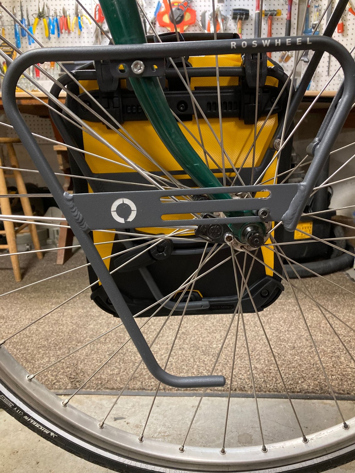

Ross200
Join Date: Feb 2019
Posts: 154
Quoted: 57 Post(s)
Liked 44 Times in 34 Posts
Like this?
https://www.tubus.com/en/products/fr...pedition-front

Originally Posted by Ross200
Like this?
Yes!
The Tubus Grand Expedition Front Carrier might be overkill and over-budget for me, but that's a design feature I think I'd want. Not sure why it's not more common…?

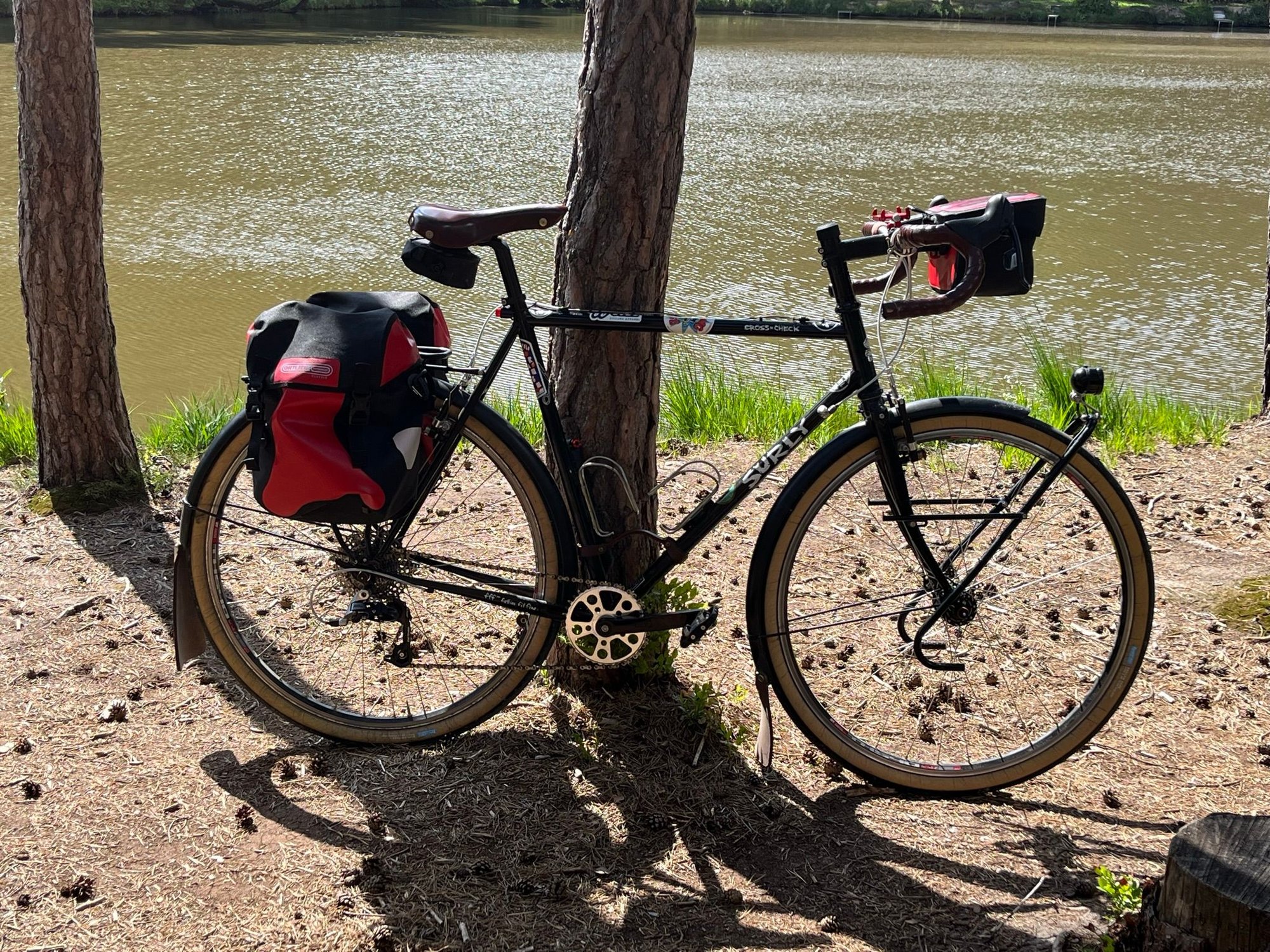

With French fenders you can mount your German light to your German rack
I actually came in to post this. I love the Tara rack. I feel that hoop adds to stability (It may be 100% psychological) - but most importantly, I always run a handlebar bag, and that loop is also my preferred light attachment too.
BTW - I love that bike. I have been planning out my first 1x build on a cross check frame for my general around town fun bike, and local rail trail/MUP bike, and in my head it looks similar to what you have there
kstephens is offline
Old 07-03-22, 05:59 AM
Germany_chris
I’m a little Surly
Germany_chris's Avatar
Location: Near the district
Posts: 2,422
Bikes: Two Cross Checks, a Karate Monkey, a Disc Trucker, and a VO Randonneur
Quoted: 699 Post(s)
Liked 1,294 Times in 647 Posts
I use one of these
https://www.bike-components.de/de/Or...tasche-p75145/
you can sorta see the mount
