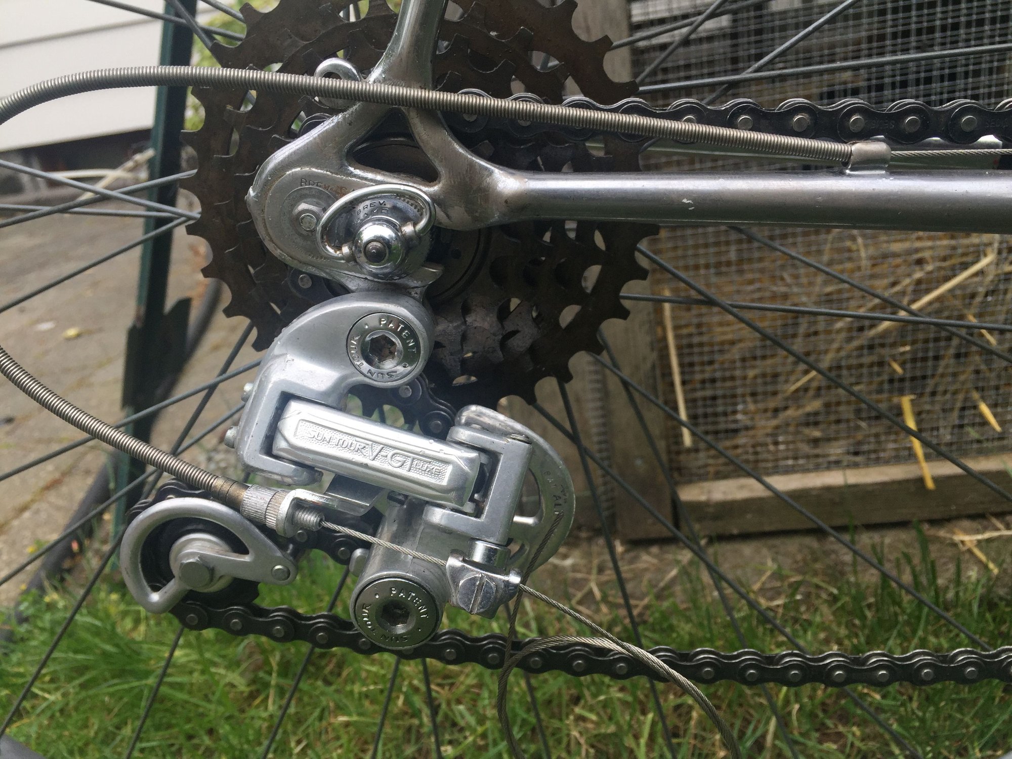

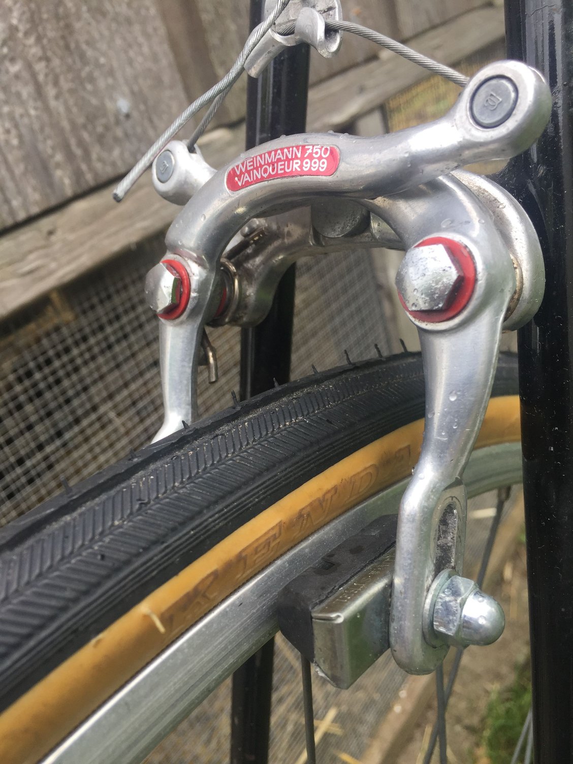

I'll use auto tire and wheel cleaner with a bristle brush. Works good, it's not a degreaser, it will take off crust and dirt. I'll use the stuff on brakes, rims derailleurs. It may take a couple or few applications.
This Suntour was on a bike that was 40 years stored uncleaned in an attic. One could chip the old grease, the cage pivot was seized.
Used here on a dirty set of brakes now spankin' clean.
I wouldn't worry about lube, the old stuff will need lube no matter how you clean.
