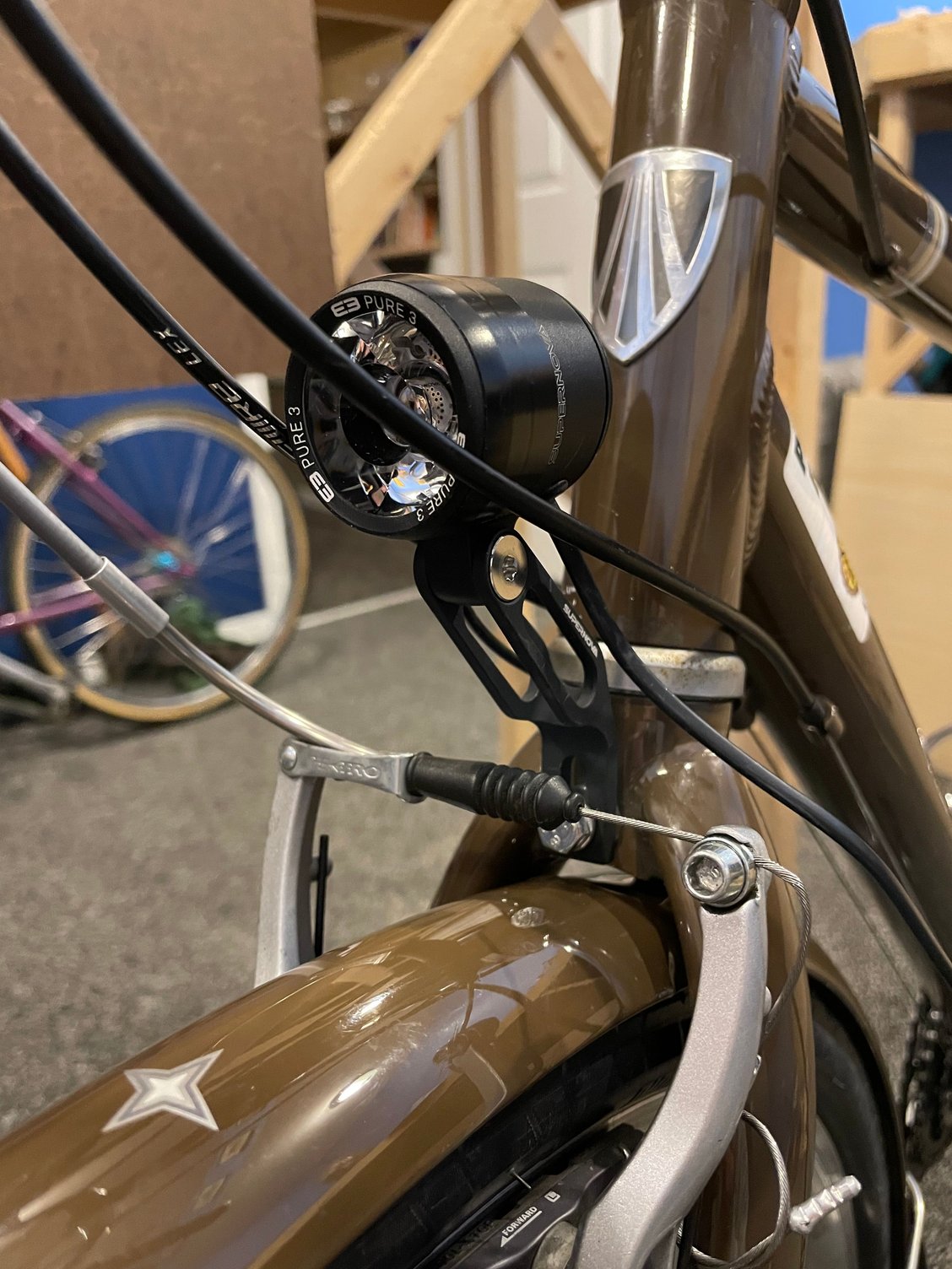

So I’m installing a Supernova E3 Pure 3 on one of my commuters, and I’m having trouble with the lead to the tail light. Mainly, what to do with it. I’m not using a dynamo powered tail light, favoring instead the simplicity and cleanliness of a battery powered blinky. In the future I may want to go that route, so I’m hesitant to cut the lead, but because the wire is kinda thick and kinda not really flexible I’m not sure how to coil it up and store it. I may cut it and install some kind of quick disconnect connector to make future installation easy but…
Any thoughts?

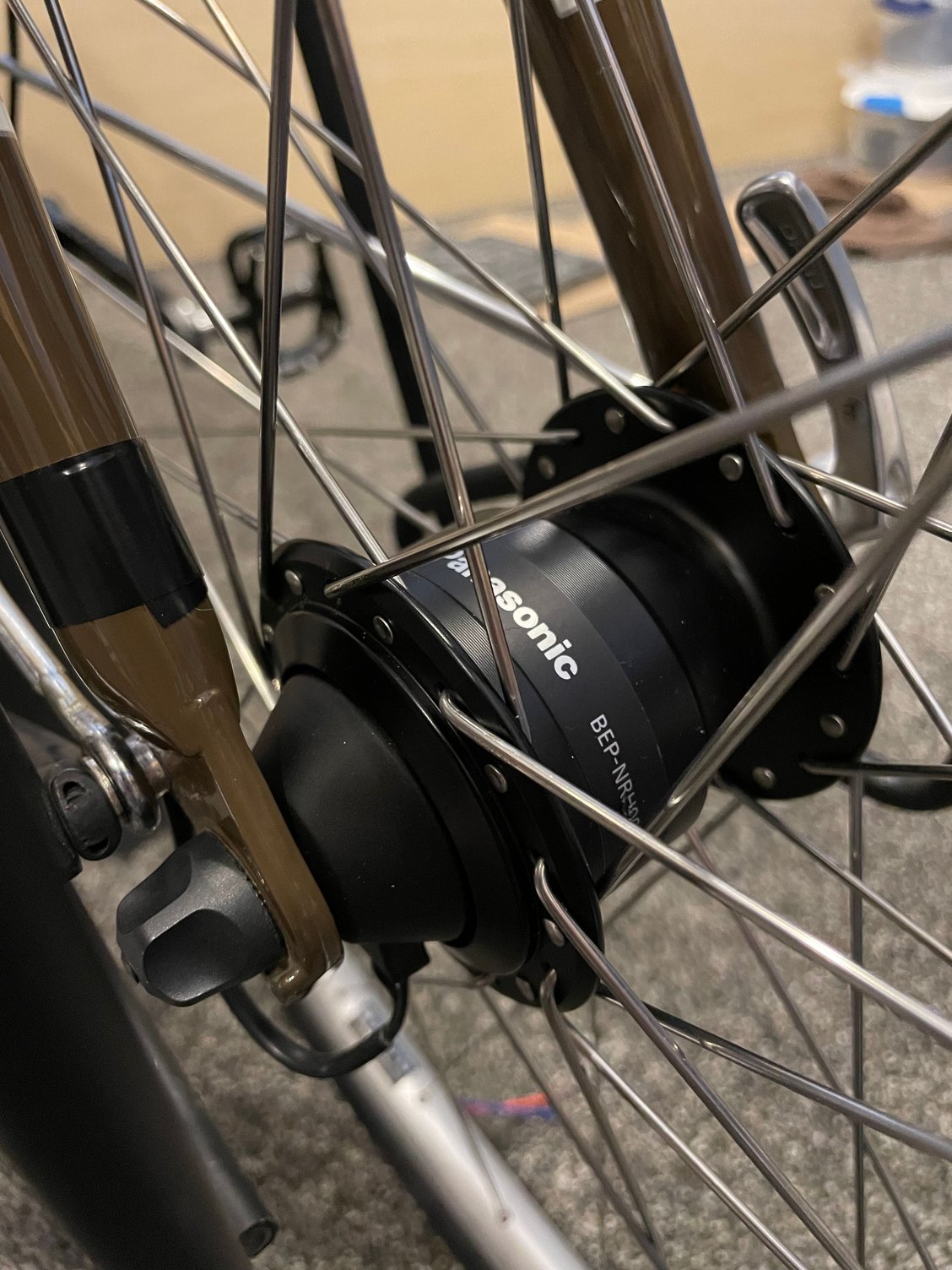

Powered by a Panasonic (rebranded Sanyo H27 dynamo) hub:

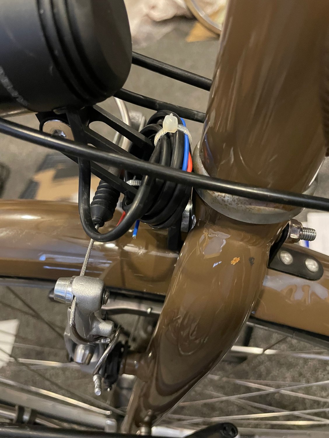

This is what I ended up doing:
Inelegant and clumsy, I coiled up the lead and hung it on the light bracket. Looks dumb but it’s out of the way without cutting the lead. Thanks for looking!
