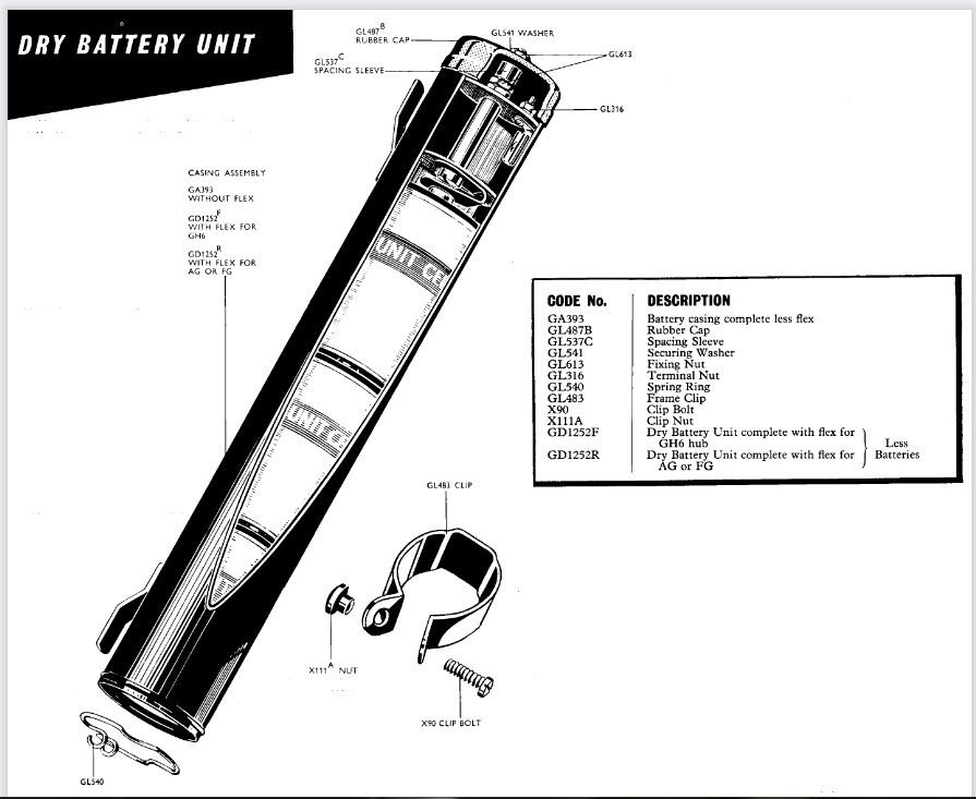

which certainly looks like 3 plain carbon-zinc cells connected in series. No doubt there is a rectifier wired in there too, to only deliver DC to the cells.
No idea how the system switches from the AC dynamo to the DC battery. Not sure how they avoid overcharging the battery either... other than knowing that the output of a SA dyno-hub is pretty weak to start with.
If someone was going to update this, I think nicad or nimh cells would do a better job, although I think I'd go with 4 or 5 cells instead of 3, depending on the bulb being used.

This indicates that there are two versions of that battery pack, one for the GH6 dynohub and one for the AG or FG which I assume is not a dynohub.
We still do not know if the bikes the OP has dynohubs.
I would not try disposable type batteries in it if there is a dynohub charging it, I would only use NiMH.
In my previous post I suggested AA NiMH batteries in D size adapters, I made that recommendation because AA NiMH are quite common and easy to buy.
But if it is not a dynohub system, I would expect that three D sized batteries might be perfect, disposables could be used.

After wasting time on the S-A Heritage website, it seems that the evolution was:
1937/9 ??: a small battery in the headlamp, manual switch-over.
1945: The tube holder, with sealed lead-acid accumulators. Switchover unknown.
1948?: Dry batteries in tube, manual
1951: "Filter switch unit", automatic switchover and a very small charging current: "depolarisation".
Some variants may have been available together, as the accumulators are mentioned in a 1950 advert.
Edit: Reading the fine print in Steve's post above, it seems the accumulators were not sealed: "dry form", but needed to be topped-up!
That sounds troublesome, and may explain the switch to dry cells.

If you want to restore, the Hadland site, the Sturmey-Archer Heritage site, the Sheldon Brown site and the book "The Hub of the Universe" will be good references.
If you want to actually ride the bike at night, replace the headlight with a Busch&Müller Classic T Senso Plus.
