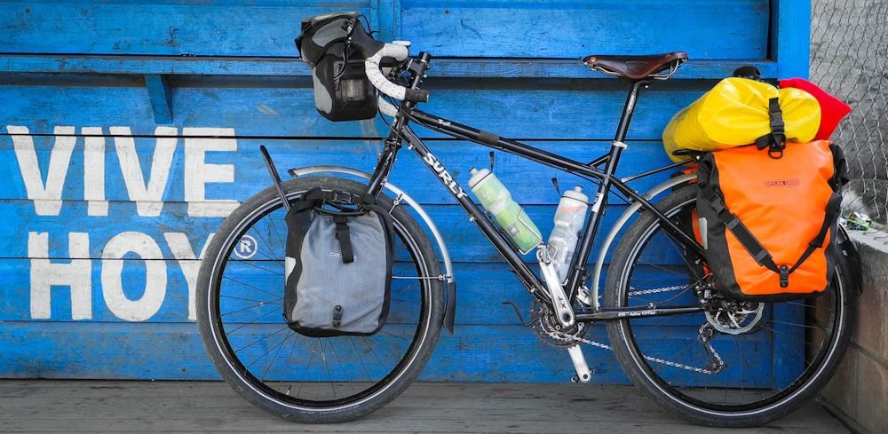

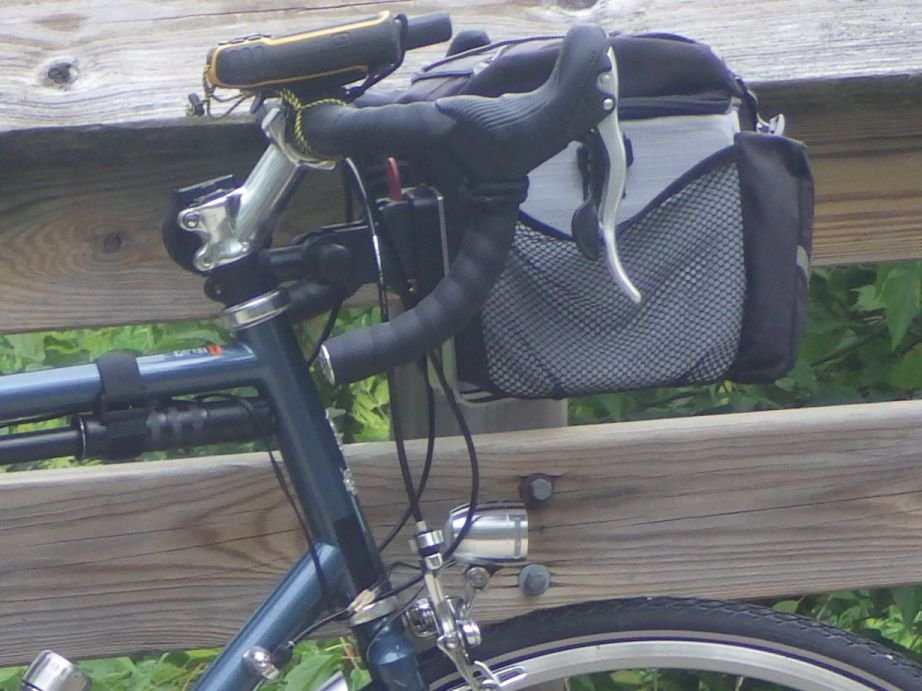

I've been thinking about going the alt-bar route myself. I like the looks of this Koga Denham bar.
https://www.cyclingabout.com/koga-denham-bars/
The "horns" are a little shorter than on the Crazybar. You can compare their shapes on https://whatbars.com/

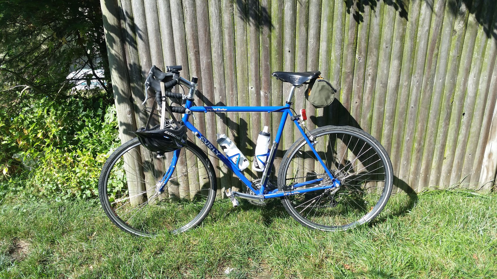

One of the things I like about drop bars is they give another body position.
I'm not as flexible as I once was. I was using the drops less and less. I switched to Soma Condor 2 bars. I found what I was looking for.

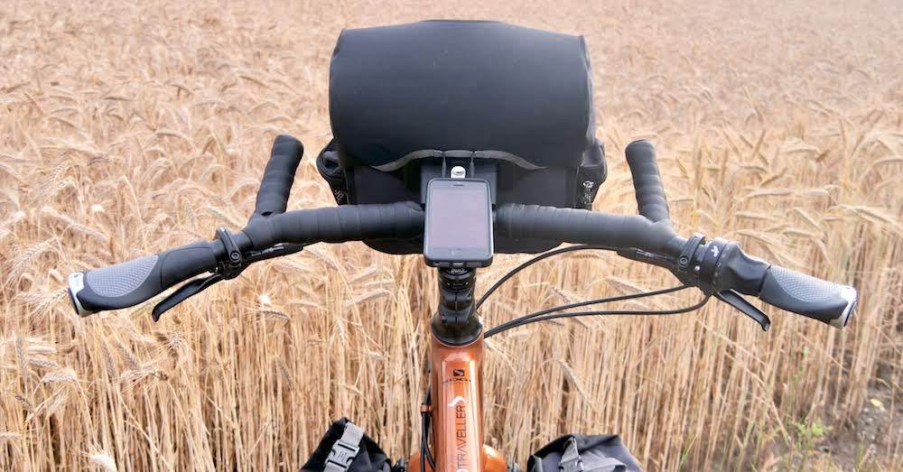

I went thru a similar process this past fall. I've opted for SQLab handlebar + innerbarends + ergon grips
1. This setup is compatible with MTB shifters (rapidFire) and brake levers.
2. It provides two very comfortable and different riding positions. (a) slightly more open than shoulder width, palms facing down; (b) slightly less open than shoulder width, palms facing each other; it is also possible to ride with hands on the tops for a little while, hands (too) close to the stem.
3. No need for bar tape.
Comparing the various options is not simple. My understanding is that under normal circumstances, most setups will work. If/when you spend a considerable amount of time on a bike, things get a little more complicated, as there is probable case for being able to switch between comfortable positions. I emphasize comfortable because if the alternate position is not comfortable, I'll revert to the main position and eventually develop some kind of discomfort. Professional road cyclists use drop down bars and cover considerable distances, day after day. However, they do not routinely spend 12 hours a day in the saddle, do not care for comfort, and are not interested by the landscape. I would tend to think that a flat bar of some kind is more suited for touring.
Reading SQlab's blurb on handlebars ergonomics is interesting, but perhaps also a bit confusing as it is not entirely clear how much backsweep or rise will fit your style. My impression, so far is that a flat handlebar with some serious backsweep and innerbarends (very much like the Denham design suggested by tyrion) is the most promising. I prefer SQlab because their innerbarends can me rotated fore/aft and moved inwards/outwards whereas Denham's are fixed. The bullhorn design shown by Tourist in MSN is a reasonable alternative, but outerbarends will make it more difficult to position shifters that can be used in either position.

Big guy, be aware that those curvy bars have no rise.
how about a photo of your bike from the side to show steerer height, because I know from lots of experience that getting your bars higher will make a real difference. My Jones bars are the ones that have a 2 inch rise, and I'm really glad they do, it makes all the difference.
I'm a skinny guy, you're nearly 200lbs on me, so higher up bars are imo a real priority for you. If your steerer was cut lower, there are those extender things that will bring your bars up about 3 or 4 inches. About 15, 20 bucks and could make all the difference.

Mega Clyde
Here is a picture of my bike. The steerer is uncut, so I do have some wiggle room to work with.
Also, I would love any feed back on adjustable vs. fixed rise stems. Have folks had good luck w/ adjustable stems?
I haven't gotten use out of the triathlete style extensions, but YMMV.
