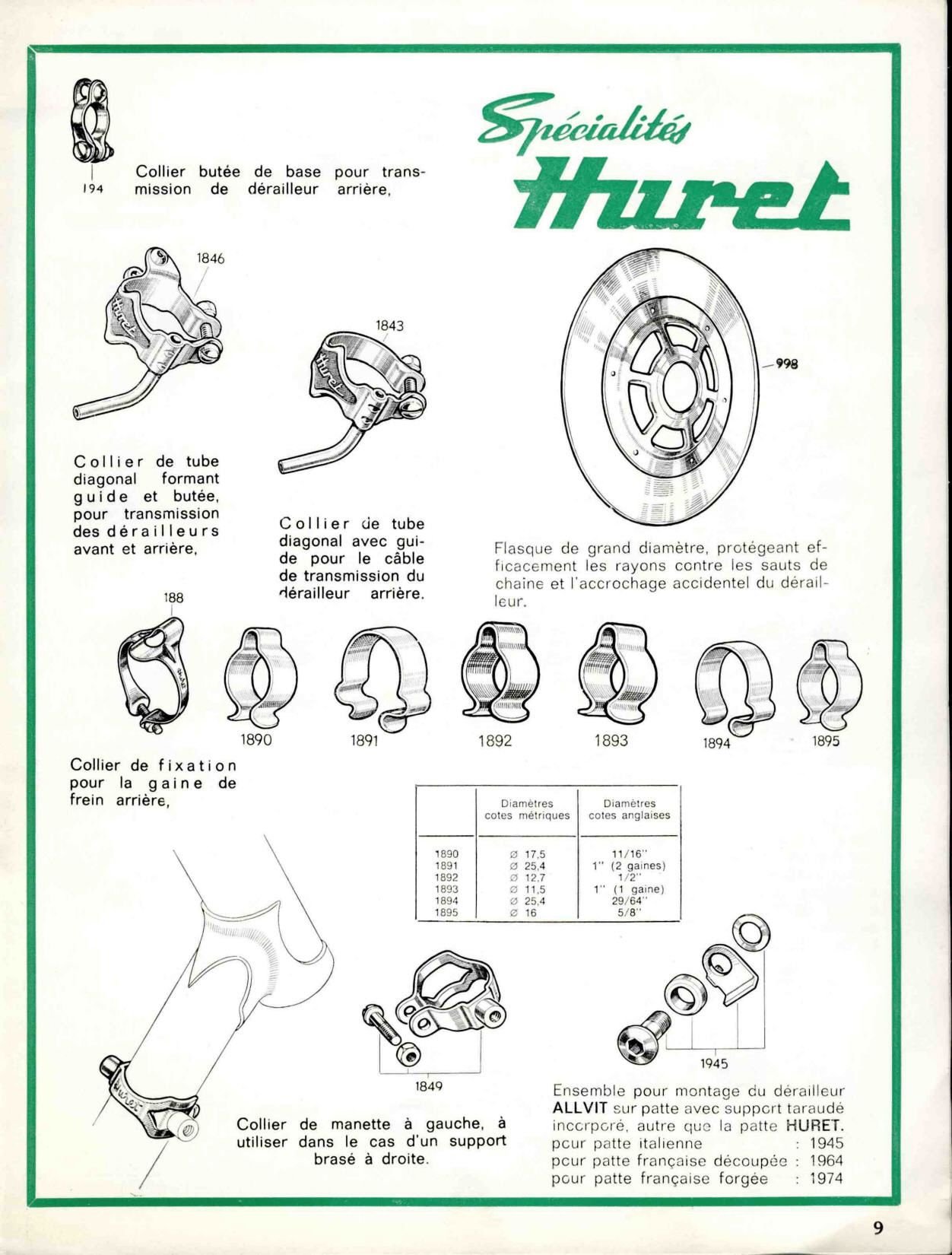

in image nr. https://i.ibb.co/b3vzmpx/IMG-20200930-193135.jpg
the gear cable guide is Freres Huret part Nr. 1846, the marking it wears began ~1965
the crank arm and & adjacent bottom bracket fittings are Campag Record series (pre-Nuovo Record)
the Simplex shift levers are Prestige series part Nr. 3952, launch for this "compass/star" logo was 1974
the Freres Huret shift levers are part Nr. 1136-01, launch was 1974-75
the handlebar end shift lever , Ref. 1012/3, is fairly early Campag. by about 1974 the expander assembly had become black plastic.
