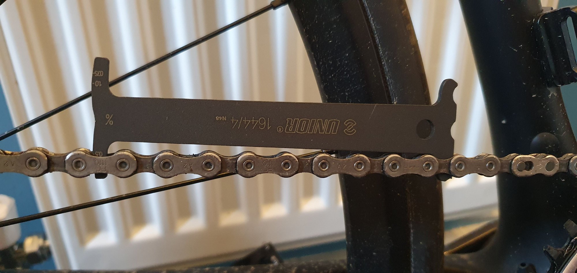

Hi guys, i bought a bike exactly 2 weeks ago today, its brand new, with a sram force groupset.
Its a 1x11 with a MTB cassette ( not sure if this is relevant)
Ive done 10 commutes to work in sunny dry weather and in that time ive degreased and lubed the chain once with finish line dry lube.
Milage on the bike so far must have been close to 100 miles.
My question is, is this worn considering Ive only ridden it for 100miles?
Ive read that for 11spd chains you need to change the chain once it hits .5% wear, according to my chain checker am i almost/already at .5% wear?
Does riding style dictate how fast your chain will wear? Eg intense pedalling?
Ive read somewhere chains last around 2000 miles before people change it.
im also very concious about cross chaining, i mostly use the middle of the cassette and i always let off the pedals when changing gears so that they arent changing under pressure or crunching.

Use a ruler to measure chain wear. I promise that you haven't put any measurable wear on that chain in a week.

The common Chain checkers only measure between the opposite sides of the two rollers. And that really doesn't matter as much since they'll "float" into place as they engage the cog. Shimano and a few others make a chain checker that measures more accurately to the same side of each roller.
However with my Park chain checker, it's always been close enough and I use it for a quick check, then when it shows the chain wearing to the point yours is, I'll double check with a steel scale or tape and measure to the same side of the pins to see how far beyond 12" they are apart. A 1/16 inch more than 12 inches is almost .5% wear. 12 x 0.005 = 0.06 and 1/16" = 0.0625
I'd expect someone that puts a lot of power into the pedals to wear out the chain faster. Lugging up a hill in high gears using all your leg muscle particularly bad, IMO. Also, if you cross chain in the large front and large rear, that might add more wear.
Regardless, I'd consider anything under 2000 miles as bad chain life. I usually get 4000 or more out of a 11 speed. My older bikes with 5 and 6 speeds would see 8000 miles... but that admittedly is just a guess.

Since you have a Quik Link, remove the chain and measure a 3' section. (3X better resolution than measuring 12")
Use that as a reference to calibrate your chain checker.
On my CC, I know if it reads .5% that it's actually still good.
IF it reads .75%, THEN I'll grab the tape measure. I just haven't gotten to that point yet.
So, your CC can be useful for a quick check to prove the chain is good.
To prove it's bad can take a bit more research for your specific CC.
