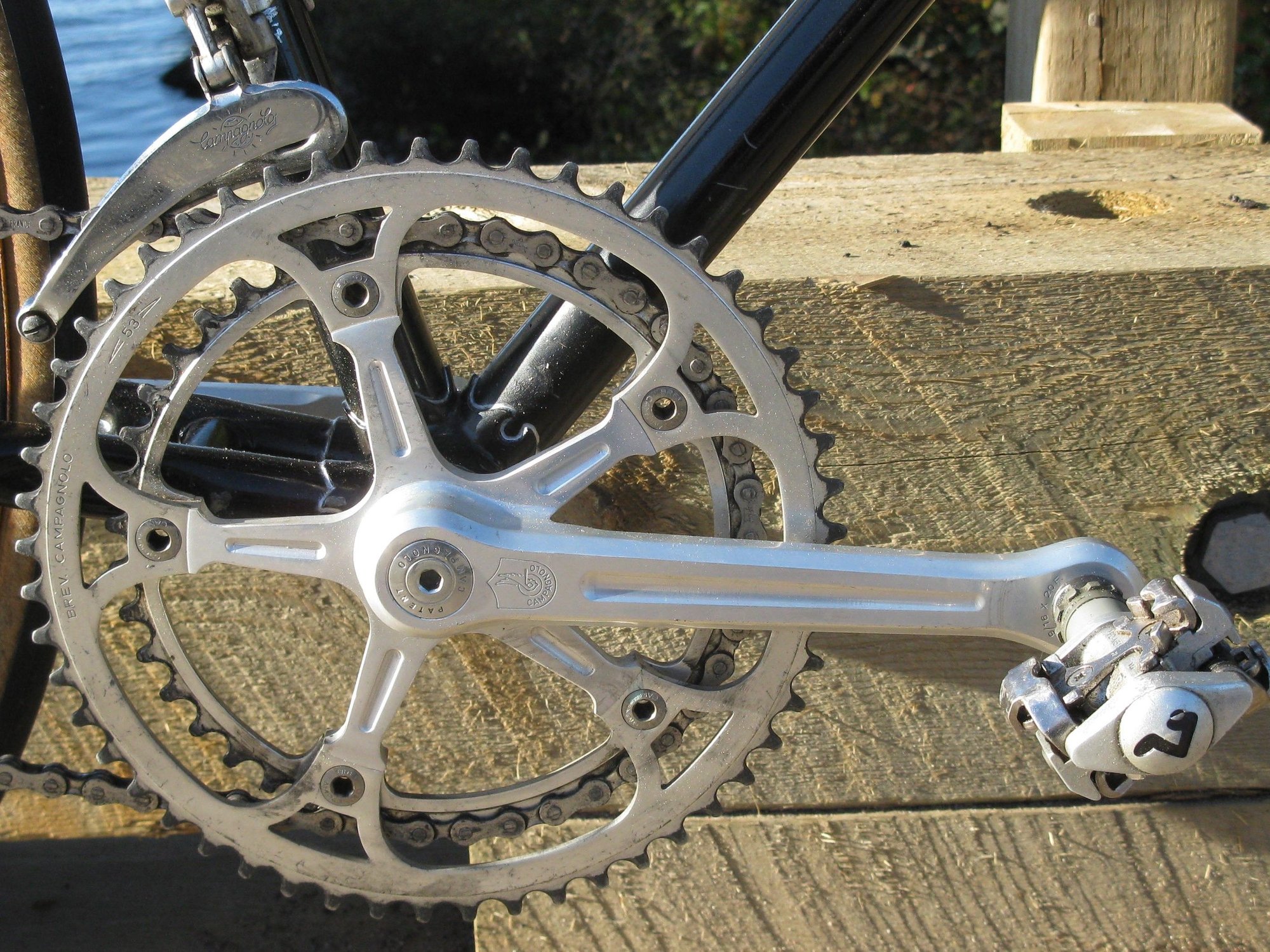

Personally, I use Look Keo on all my bikes, with one exception. The Colnago keeps the pedals, cage and straps. A lot less hassle from my point of view. I need to pay attention to the traffic scenarios while riding. I don't want to make a move with my foot and forget what I am wearing and how I am attached to the bike!

I gave up on straps and traps long ago. These days it is SPD or nothing. Coupled with mountain bike shoes, the system is as close to perfect as I have found. They are fitted to all of my bikes, from my 1958 restored German Rabeneick to my 2000 Marinoni Piuma...
