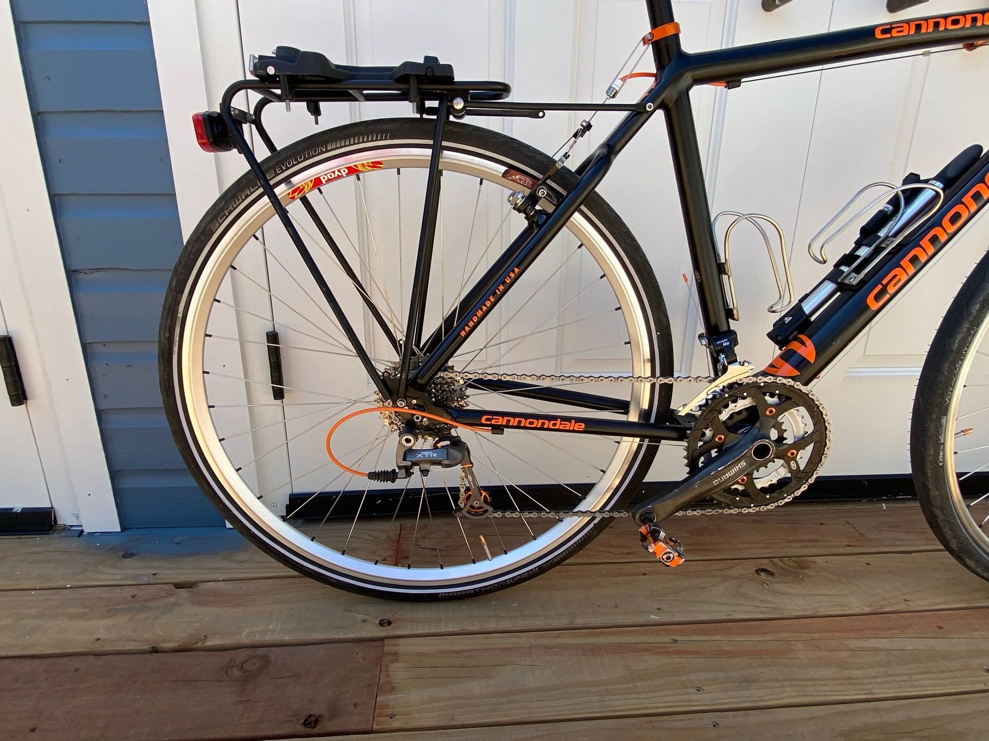

A little late but for future readers Tektro Mini-V brakes perform great with road levers. Other requirements: true rims, Koolstop pads, barrel adjuster in the brake cable housing for wheel removal. Been running these trouble free for ~15k miles.
